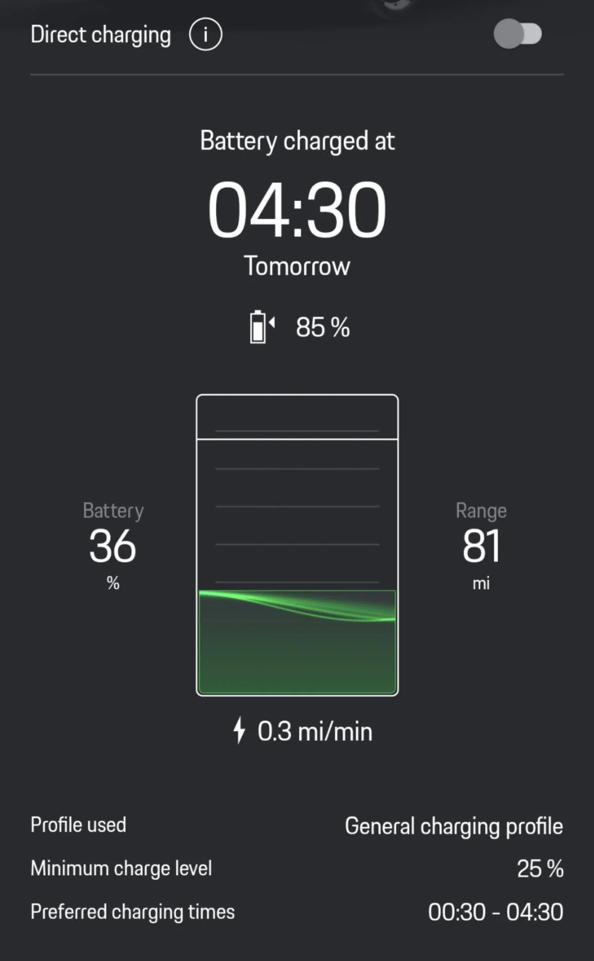

Hi, this the problem I’ve had, as it WILL step out of the boundaries set. If it doesn’t think it will reach the required soc it starts charging early and ignores the times set in the profile.
Hence, I’ve given up and am just using the podpoint timer. It all worked fine just using a profile before my software update now it’s no good.
Can confirm this. Have all the settings as they should be and it does work if there is enough time to charge to 85% in the 4 hours. However if there isn't enough time it will start charging before hand outside the 00.30-04.30 set.
Just plugged in at 23.30. Vehicle has 36% charge. Assuming there isn't enough time in those 4 hours as it has just started charging straight away.
I can charge every night if I wish however just left it for a few days this time.
So question is how low on the % should I go if I want to be only charging in those 4 hours to get to 85%?
Using 7.2kwh Porsche charger.
I have the standard battery. My settings are:
Porsche Taycan Charging to 85% Regularly between 00:30 & 04:30 Screenshot_20210430-233457
Will charge just under 30% in the 4 hours so start charge level would need to be about 56%+
Just calculated myself:
79.2kw*0.85= 67.32kw
7.2kwh*4h= 28.8kw
67.32-28.8= 38.52kw
38.52 / 67.32 = 0.572
So I shouldn't let the battery go under 57% if I want to get to 85% in 4 hours using a 7.2kwh charger.
7.2kwh*4h= 28.8kw
67.32-28.8= 38.52kw
You should perhaps include some charging losses, maybe 7% or so. But in general your calculations are fine, only issue is that it is kWh battery power not kW.
7.2kwh*4h= 28.8kw
67.32-28.8= 38.52kw
or if you are below 57% but want only/mainly cheap rate charging then adjust 85% downwards accordingly assuming you've not doing too much mileage the next day.
