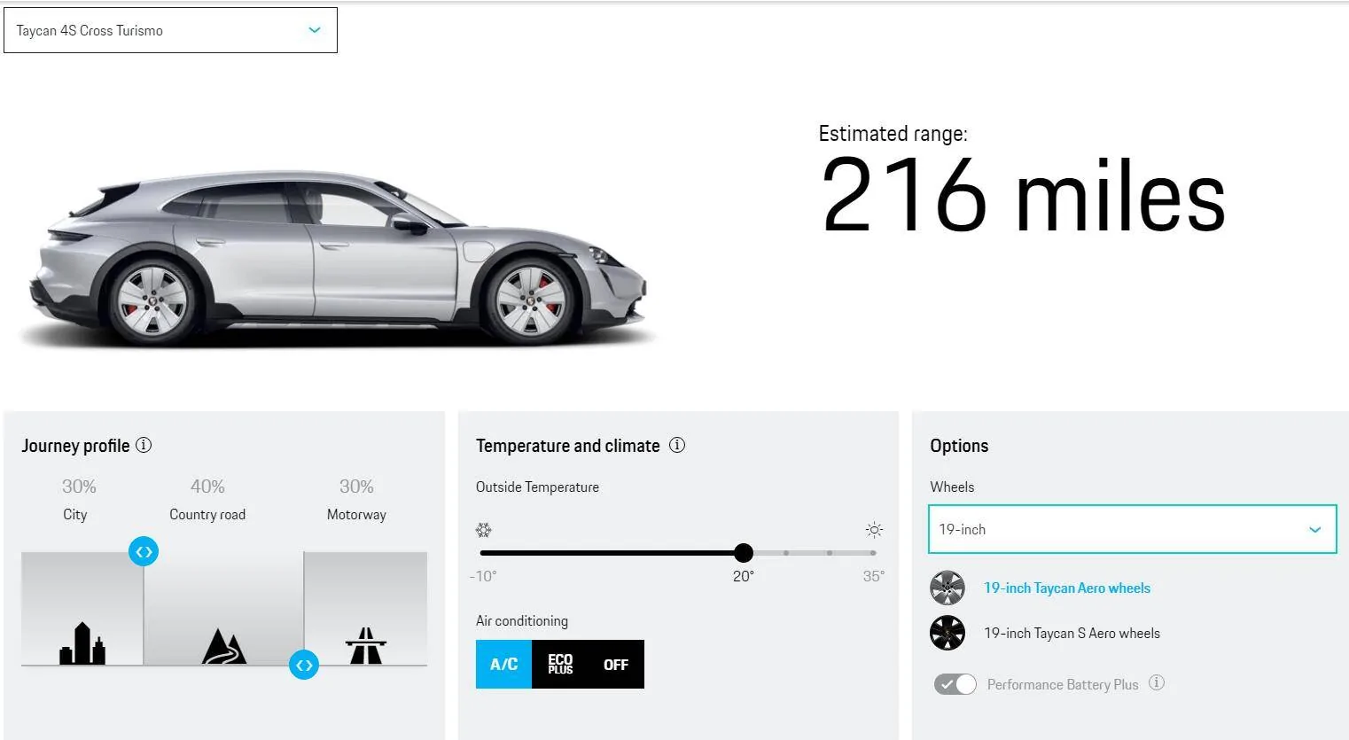

That's what the range calculator is giving for a CT 4S with 19 or 20 inch wheels and 20°.
So it's not bad.
So it's not bad.
Going ECO on the A/C makes a big difference too according to this calculator
