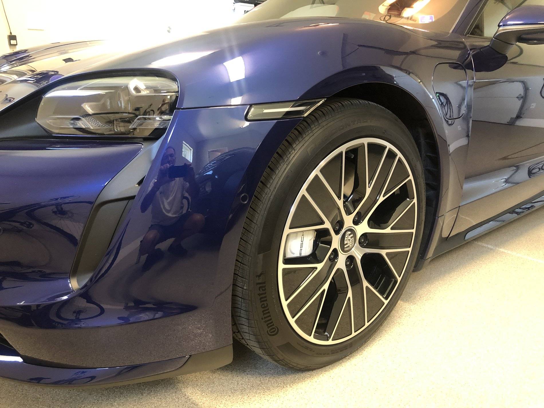

I just installed mine. It wasn't too hard to do. You will have to remove a T20 screw first then you can pop out the side marker.

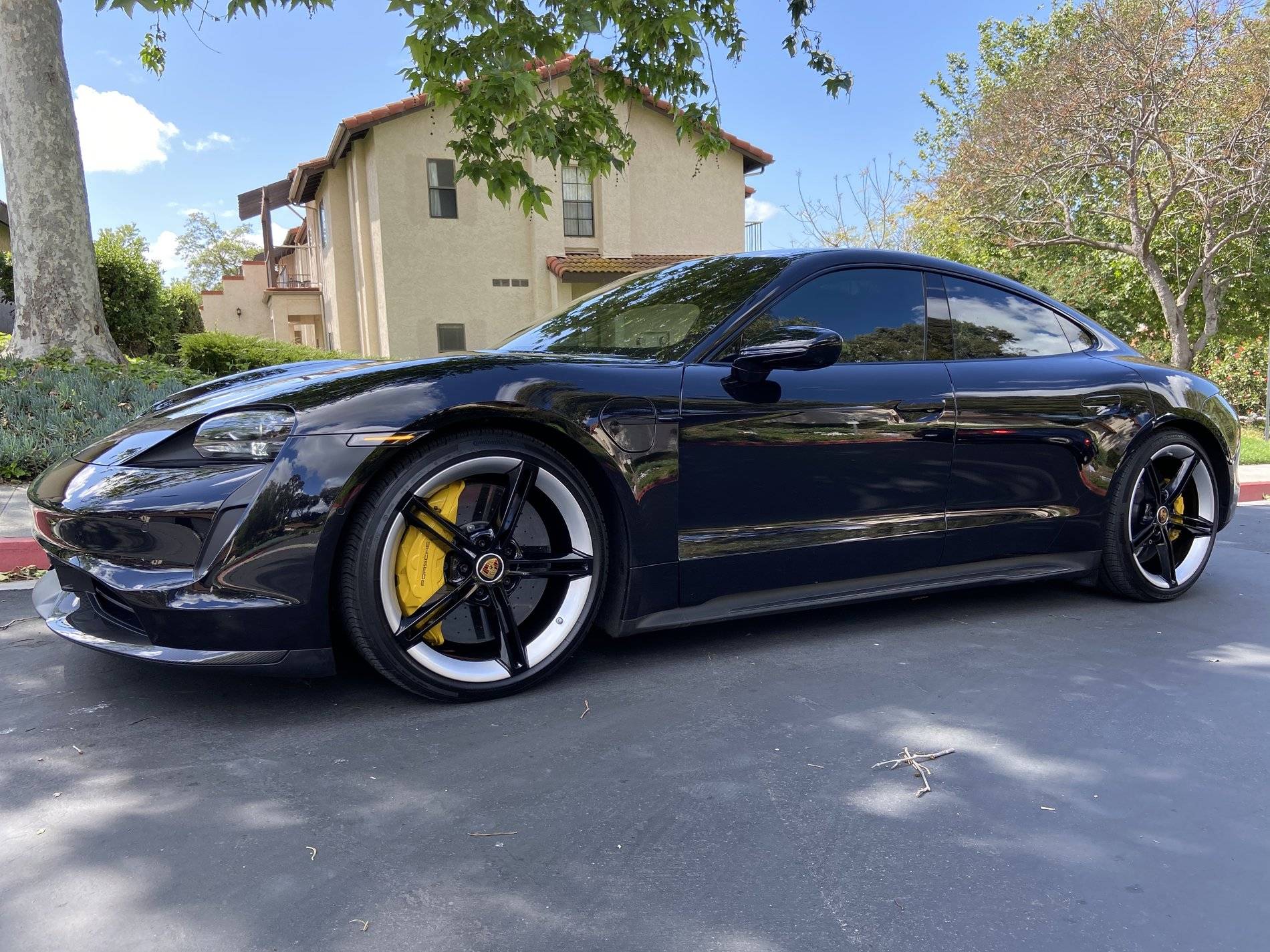

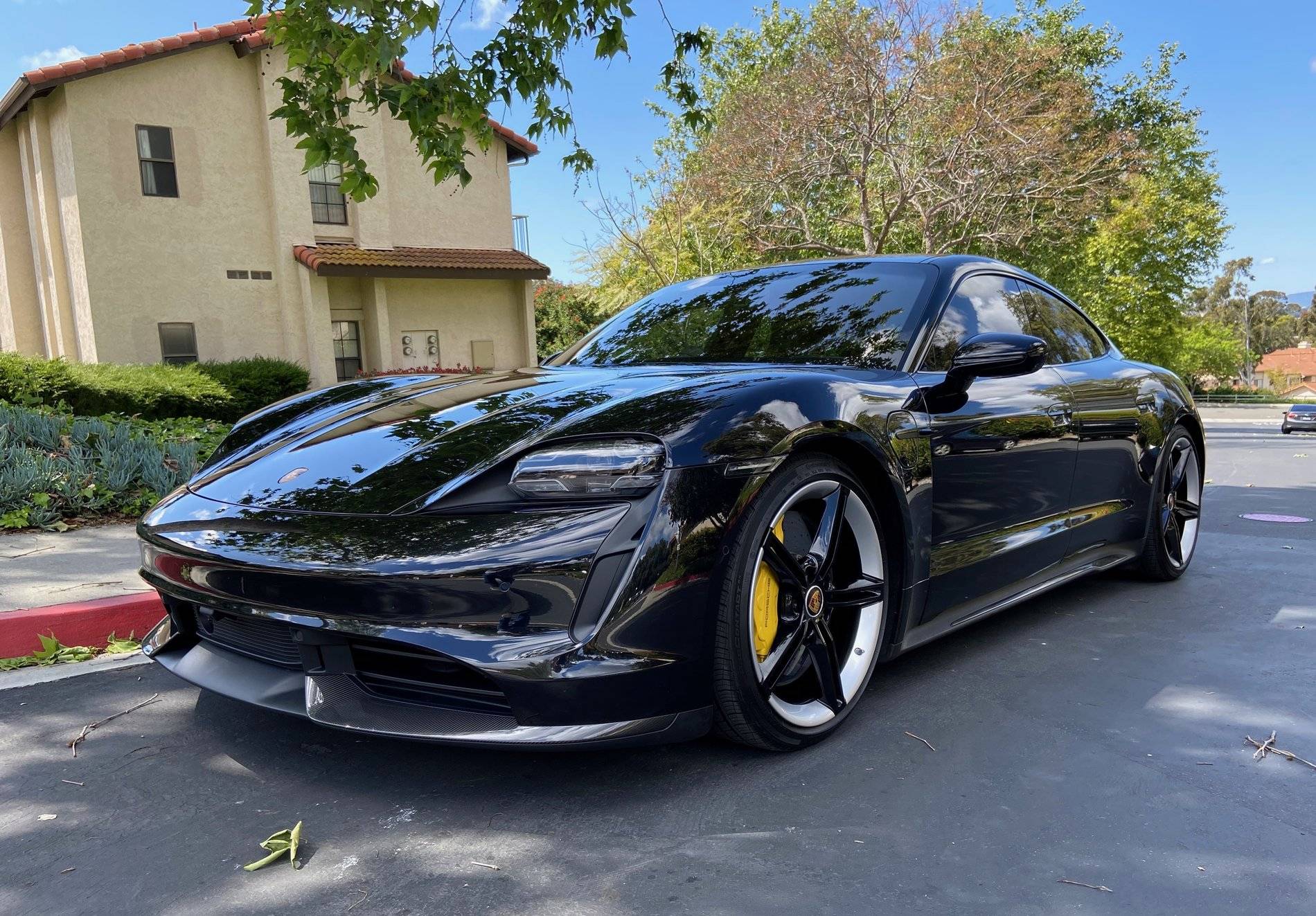

Perfect timing, about to die of boredom, UPS drops off the Clear Fender Markers!! At last something (else) to do all by myself!
Easy to do really, just the one screw.
This is coming together! Ceramic window tint on Tuesday, medium, not too dark, and now the clear fender marker lights!

DIY: Replace Amber US DOT Side Marker with Clear LED Euro Side Marker.
Required Parts:
1) OEM Porsche Part: 9J1-953-042-D
2) OEM Porsche Part: 9J1-953-041-D
Required Tools:
1) Torx T20
Procedure: 5-10 minutes
Step 1:
1) Turn Wheel for more space.
2) Remove (1x) One Inner Fender screw for access.
Step 2:
1) Remove Screw holding Side Marker with Torx T20 driver.
Step 3:
1) Disconnect power cable by pinching connector with your hand.
Step 4:
1) Using screw, thread new side marker with T20 driver.
Step 6:
1) Check all rubber bushings are attached and fixed on side marker; the bushings clip onto the side marker.
Step 7:
1) Re-Install in reverse order.
*Test connections before tightening screws.
DONE!
