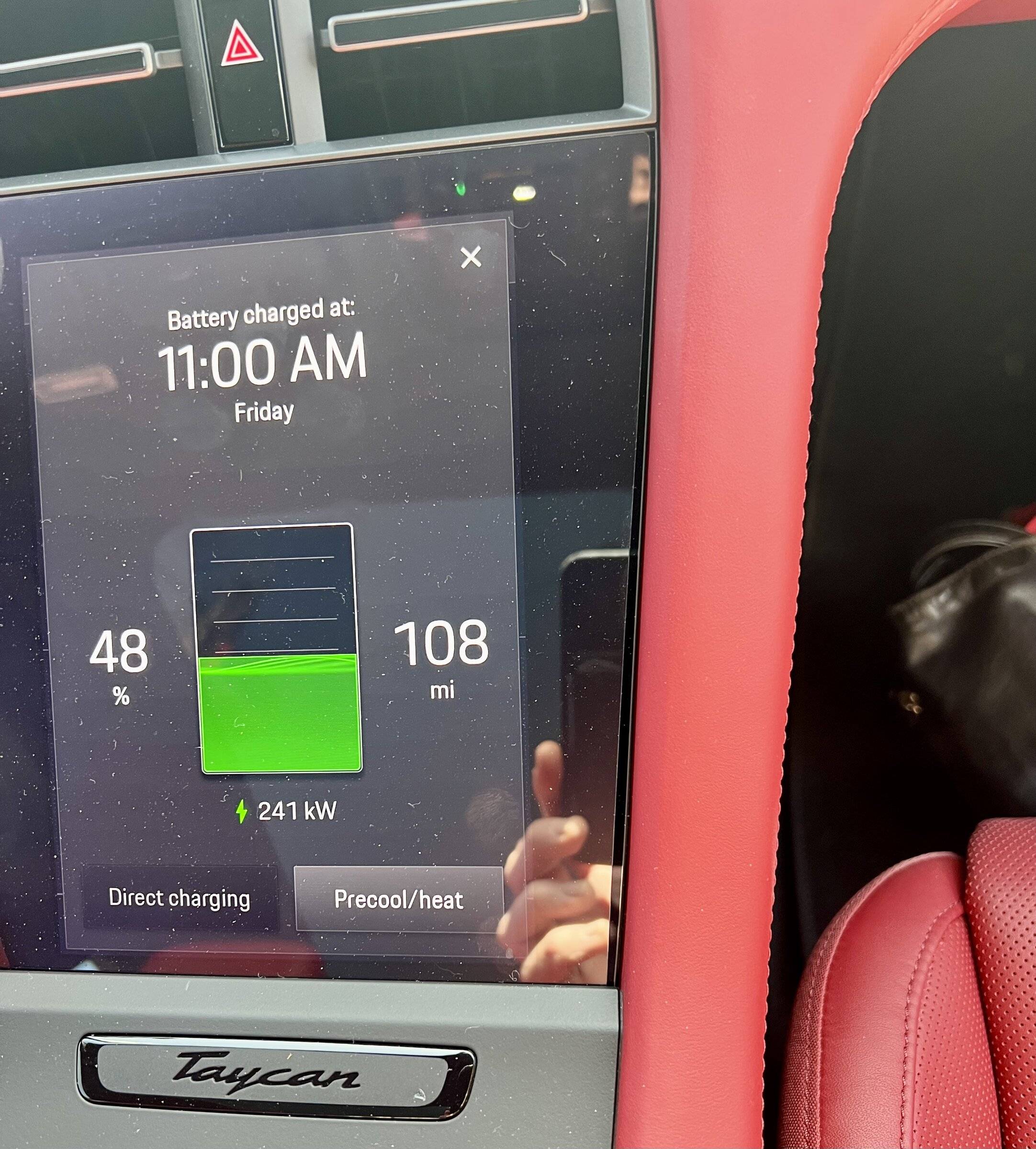

today I had a flawless EA experience - plug&charge (not supported on 2020 Taycan's) would've made it better - but everything worked and it was a non-terrible experience.
Over the past few months I have come to experience and believe the following to be true.
the _ONLY_ problem the Taycan's fast charging is the RELIABILITY of the charging network - _IF_ the network is functional and non-broken the Taycan is actually factually better than any Tesla I"ve ever owned.
Tesla has the superior charging network from a reliability point of view - in that it working is the common rather than the uncommon experience.
EA's chargers when working w/Taycan is actually faster at charging an EV - but it is the uncommon experience (for me personally since July of 2020) that the charging stations actually function.
Tesla still has an edge on stalls at charging sites (tend to be 8 or more stall, a lot more sometimes) where as EA still seems to favor the 3-6 stall install…
but - if EA can get their reliability/activation-problems under control and improve it - it WILL be the superior charging network
that day however is not today - however good my experience was on this date
there is however hope for the future - and since this is the network used by all the other non-Tesla's EV in the US - that means there is hope for the non-Tesla EV world to have a functional, fast, reliable charging network…
it's the reliability stupid!!!
perhaps, perhaps this can be made to work.
39% to 92% in 18 min today while my wife and I ate our diet salads - it was as fast and almost as easy as any Tesla supercharging experience I've had since 2013 - plug&charge and we'd be nearly equal in easy of use and faster in actual charging experience.
fingers crossed this is a trend and not an abnormality.

Do you know the peak charging rate as well as the rate when you stopped at 92%?
154 kW @ 150 kW station - started at 143 - got to 154 kw - tapered to 103 kw @ 92% - it was awesome - way way way better Taper curve than any Tesla I've seen or owned (better than my son's Model Y @ v3 supercharger)
dont' get me wrong - Tesla is still plenty fast and I still give their network the edge in terms of "will it work" when I show up to charge
but there is hope for those of us in EA hell…

Porsche Taycan Confirming what I know to be true - charging a Taycan IMG_5411
160
5,810
8,648
in the past I've actually seen 175 kW at this exact station in Aptos, CA briefly when below 30% SOC - this is remarkable in that they are 150 kW stations - LOL
