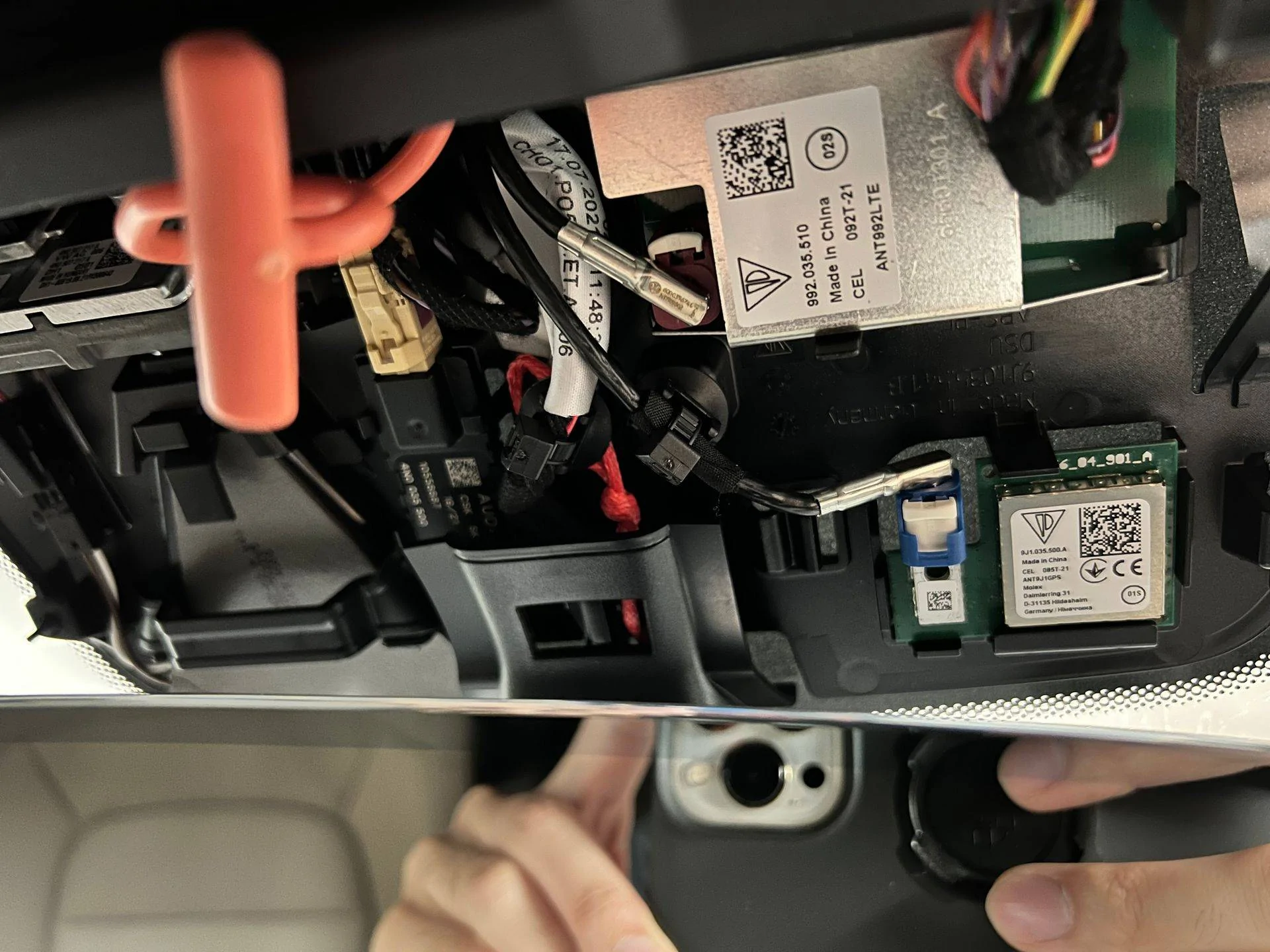

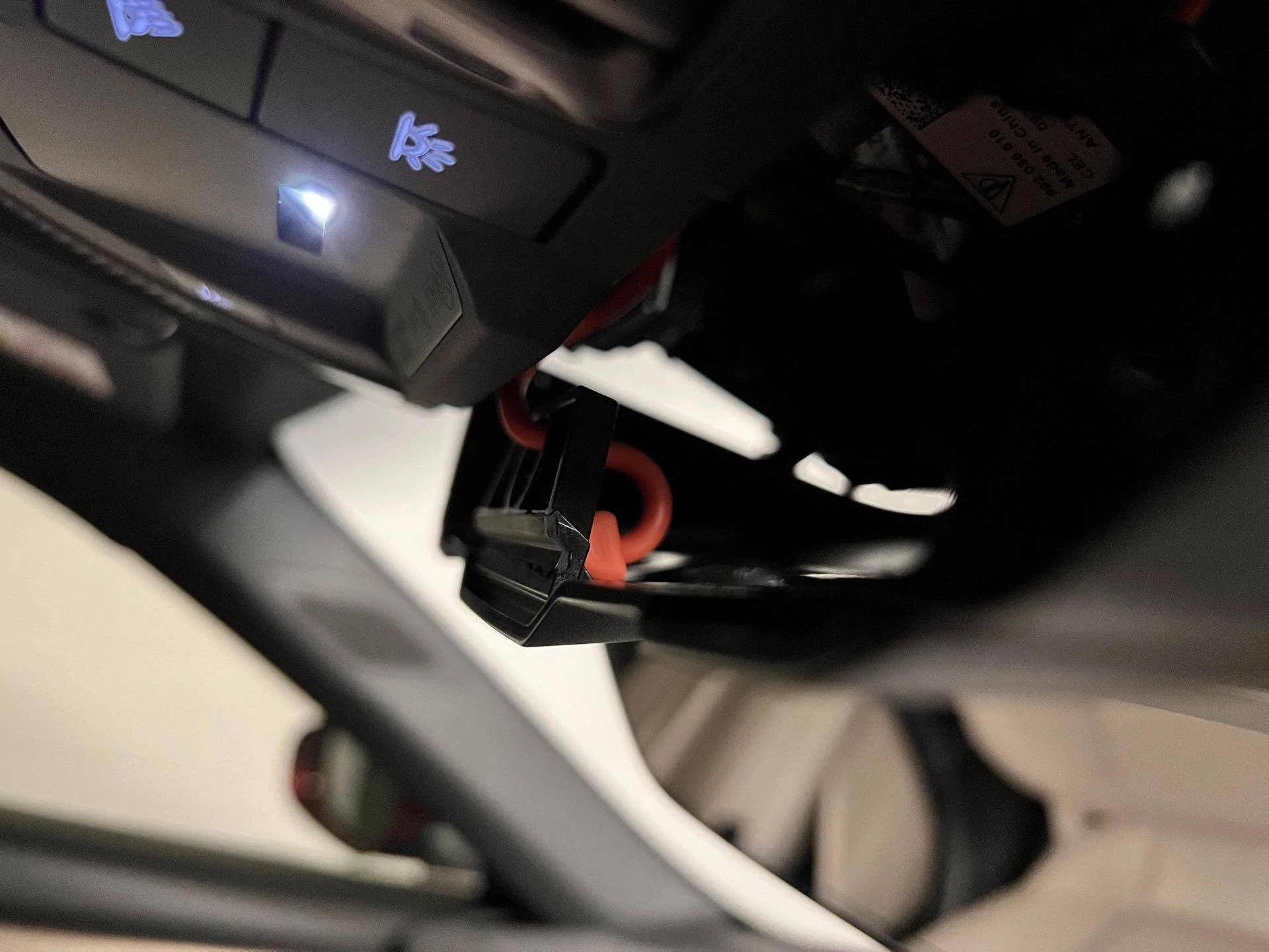

2 week old car here and had the alarm issue for the first time last night, parking on a level driveway that gave me no problems the week before.
Suspect this red sensor above the interior mirror is the interior motion sensor. If it is, then I understand why it goes off so easily as it is not actually held securely in place; the tension of its red cord is the only thing keeping it in position.

.....Suspect this red sensor above the interior mirror is the interior motion sensor.....
Can you try putting a piece of tape or something similar over it to see if that fixes the issue pending a more permanent solution from Porsche?
This is my line of thinking too. I plan to use some double-sided foam tape to "diffuse" the sensor's readings and hopefully rectify the issue.
First however I need to find a convenient location where the alarm reliably gives false positives, then I will be better positioned to gauge the efficacy of a foam tape fix.
