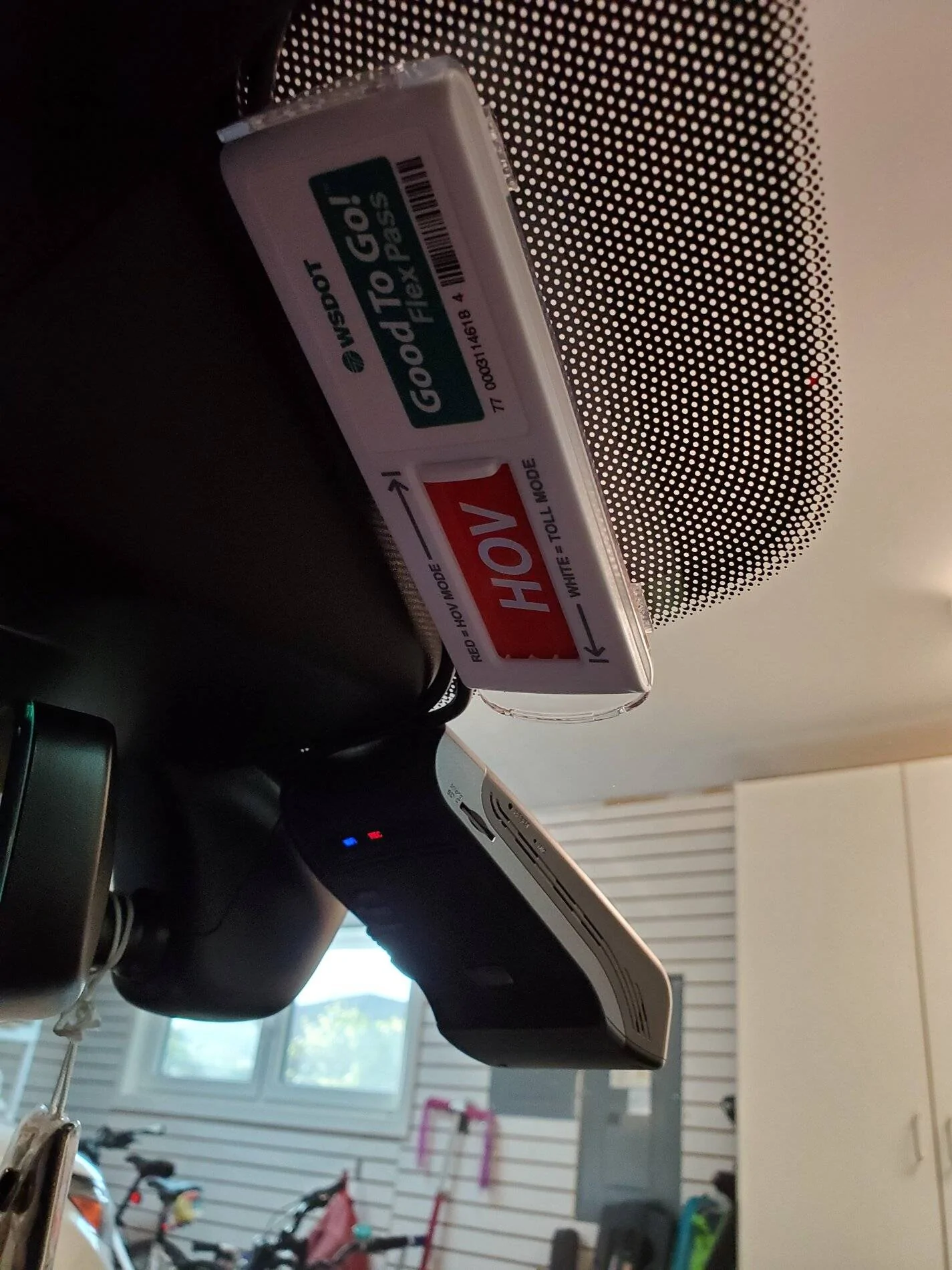

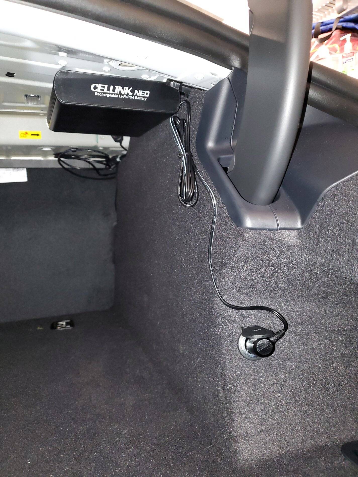

Update on my dashcam install.
Picked up a 2 channel dashcam (one for the front and one for rear window) + a battery to avoid adding more risk to the V12 battery drain.
Porsche Taycan Dashcam 20200926_173842

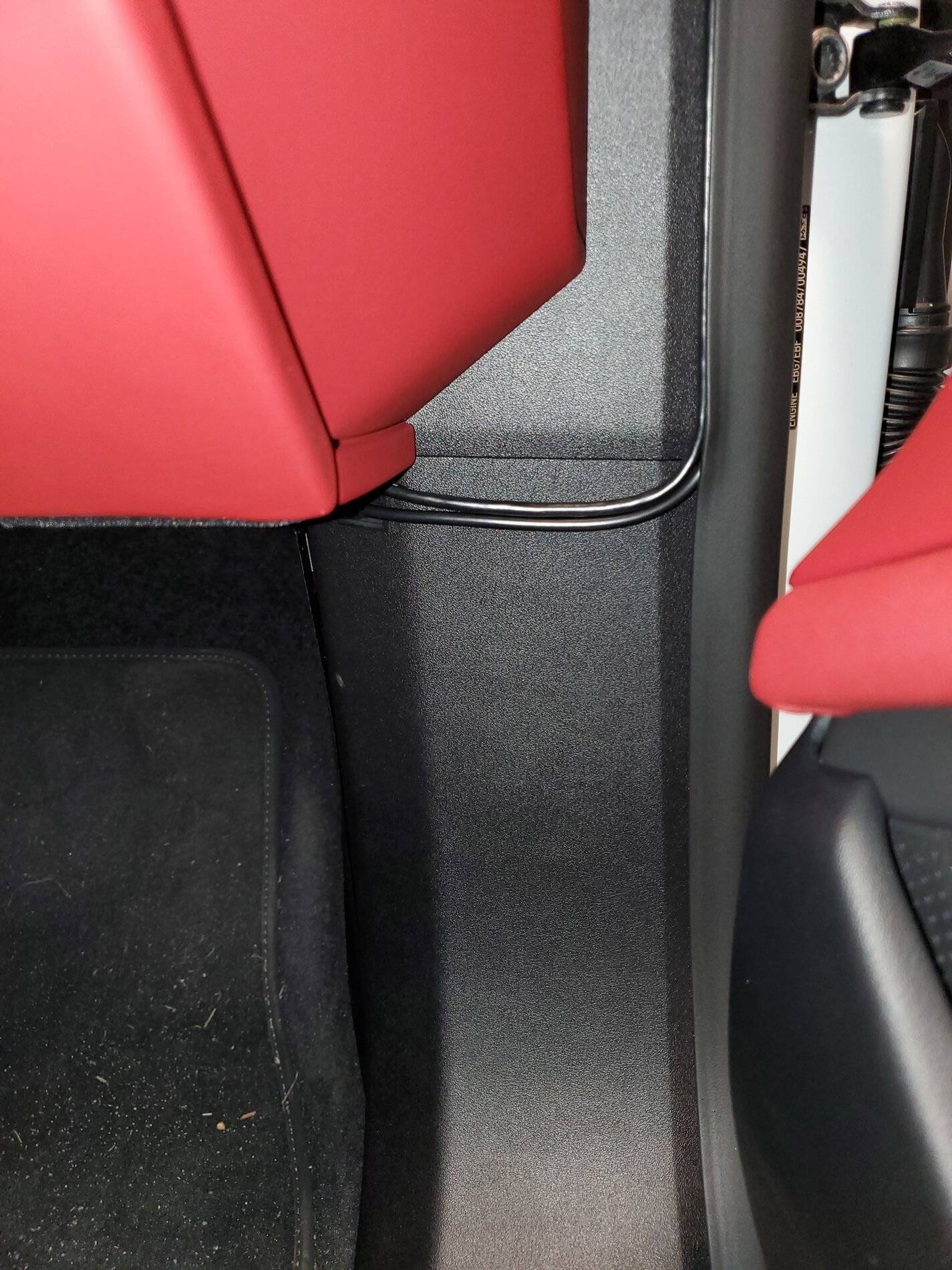

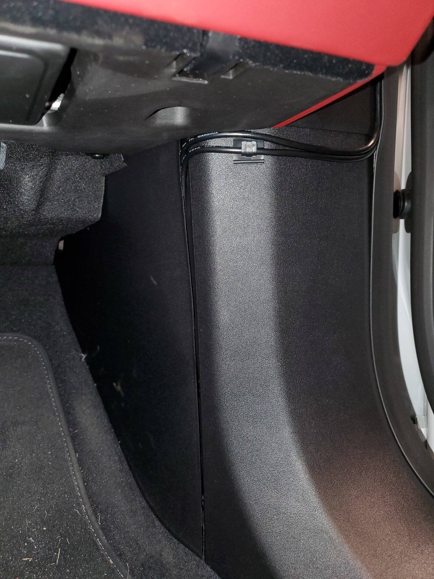

I placed the dashcam behind the rear view mirror so I won't really see it when driving. I snaked the power cable and the wire going to the reach cam along the front window liner to the passenger side door. Then tucked them behind the rubber strip down to the footwell.
Porsche Taycan Dashcam 20200926_173912
Porsche Taycan Dashcam 20200926_173939
Tucked the cables between the plastic covers so they won't come loose. BTW, there are some fuses behind the cover. Then I ran the cables between the plastic doorsill and the floor carpet.
I then ran the cable between the carpet and the back seat side cushion and up to the C pillar. During installation, I folded the rear seat down to hide the extra portions of the cable into the trunk, along with the dashcam battery.

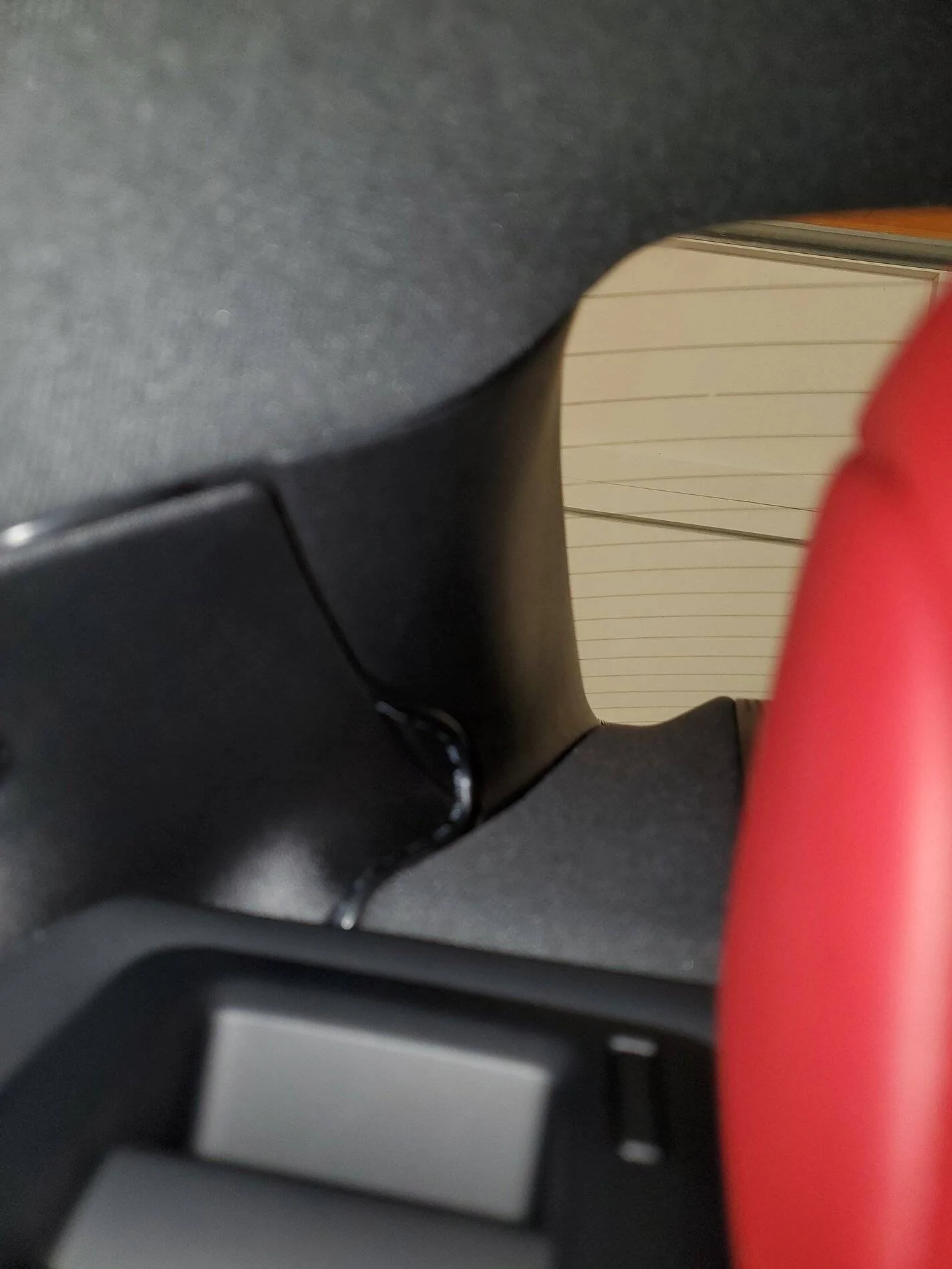

With the seat back to normal position, this part turned out the ugliest to me, as I couldn't get the rear camera cable to tuck in between.

To finish off, I ran the rear camera cable along the back window liner to camera.

Not difficult to find places to hide the cable, but a pain in the rear in terms of needing to pull hard enough to stuff the cables between tightly clipped together pieces of trim. For example, I thought about hiding the cable under the floormat instead of between the plastic doorsill and the floor carpet, but I couldn't be sure I had enough cable length. I ended up with plenty extra length so that would definitely be the way to go.
I spent a good 4-5h to get everything routed. Probably would have been faster, if I wasn't parked in garage and couldn't get the doors fully open.

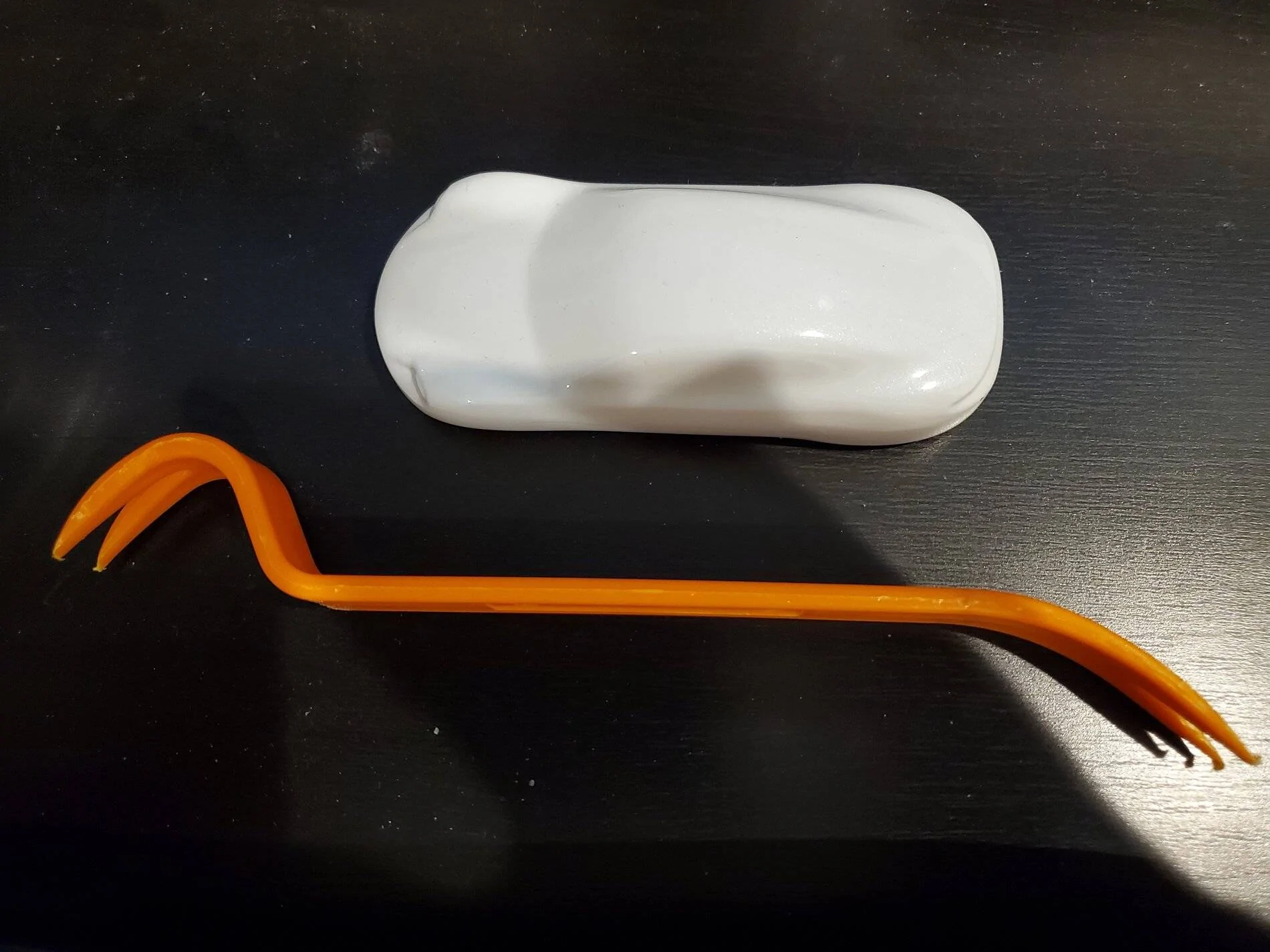

Make sure you have at least one of these plastic crowbar like tools. The orange color thingy. The white Taycan paperweight is just of size reference. The tool will allow you to pry back trim pieces and door frame rubber without ripping fabric or punching holes. I also use the tool to push on the cable themselves to stick them deeper into the trim pieces so they are less visible.

BTW, I bought the Thinkware U1000 2 channel dashcam from BlackBoxMyCar.com. If you plan to get a battery like me, make sure you ask the seller to splice the power cable that goes from the battery to the dashcam to be long enough. I had to pay for the splicing service but saves me time to extend the power cable and guarantees it works. The power cable will need to be close in length to the cable from front dashcam to rear dashcam.

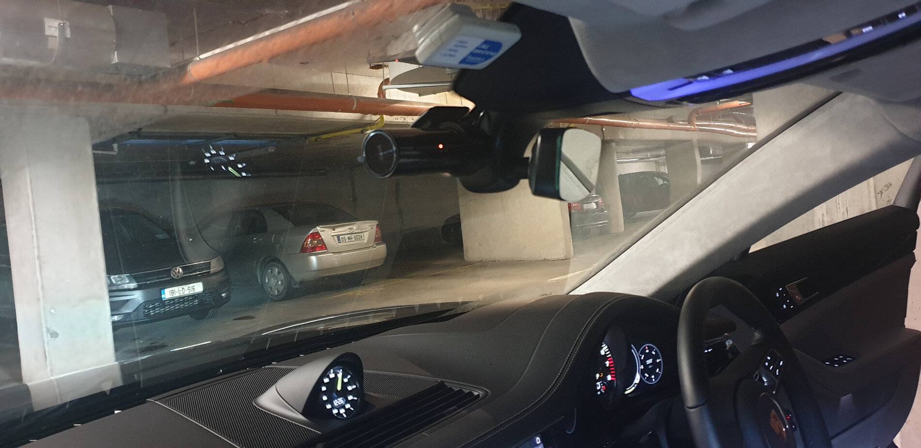

Due to vandalizers which frequently shows up, I’ve mounted dashcam in my vehicles the past years - also inside my Porsche as well, so I might catch the bastards eventually.
Actually I´ve caught a few situations on film already, which I will use as evidence for later (one of them are unfortunately my own neighbor).
Where I live the police does not have capacity to investigate this type of crime, and those time I have reported vandalism, the case is closed a few days later anyway. So in the name of self defence, I will catch the next vandalizer myself :punch:
A big plus is that if an hit-and-run occurs with damage, the camera record the license plate, and will probably at the first incidence save you more than the installation cost already.
I am very pleased with my ‘BlackVue DR900S-2CH’ which can record in 4K-UHD at front and in Full-HD to the rear, with possibility for microSD cards up to 256GB and should be enough for several days of continuous recording.
Also it has WiFi connection, cloud storage, impact detection, motion detection, timelapse + events recording. (I have seen some connected the system to 4 channels, so it should be possible to record almost 360 degrees).
The flashing led light in the cameras itself seem to scare most people with bad intentions off, and that is a good effect in itself :bandit:

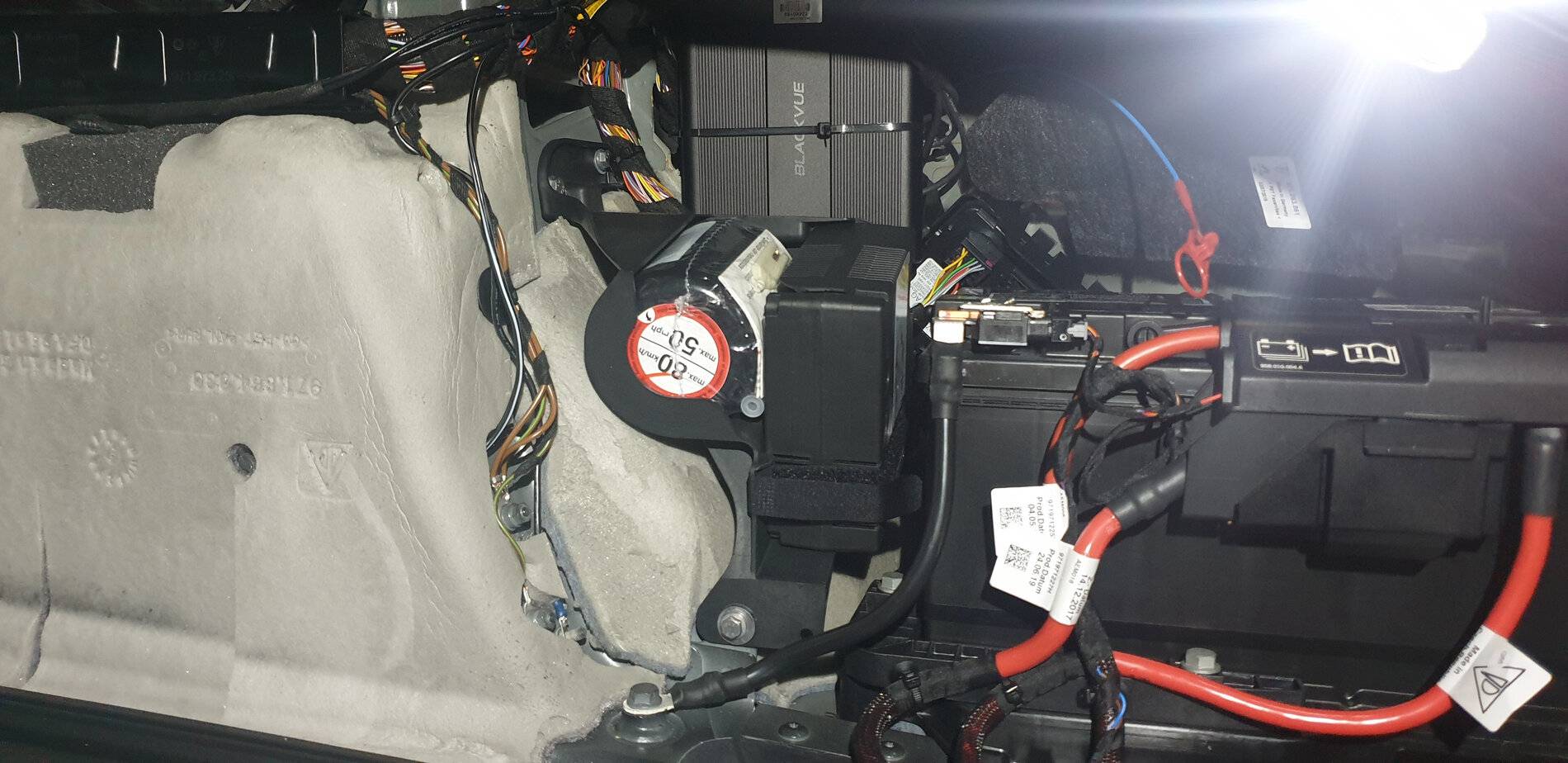

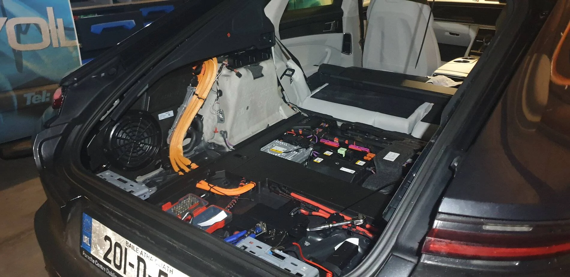

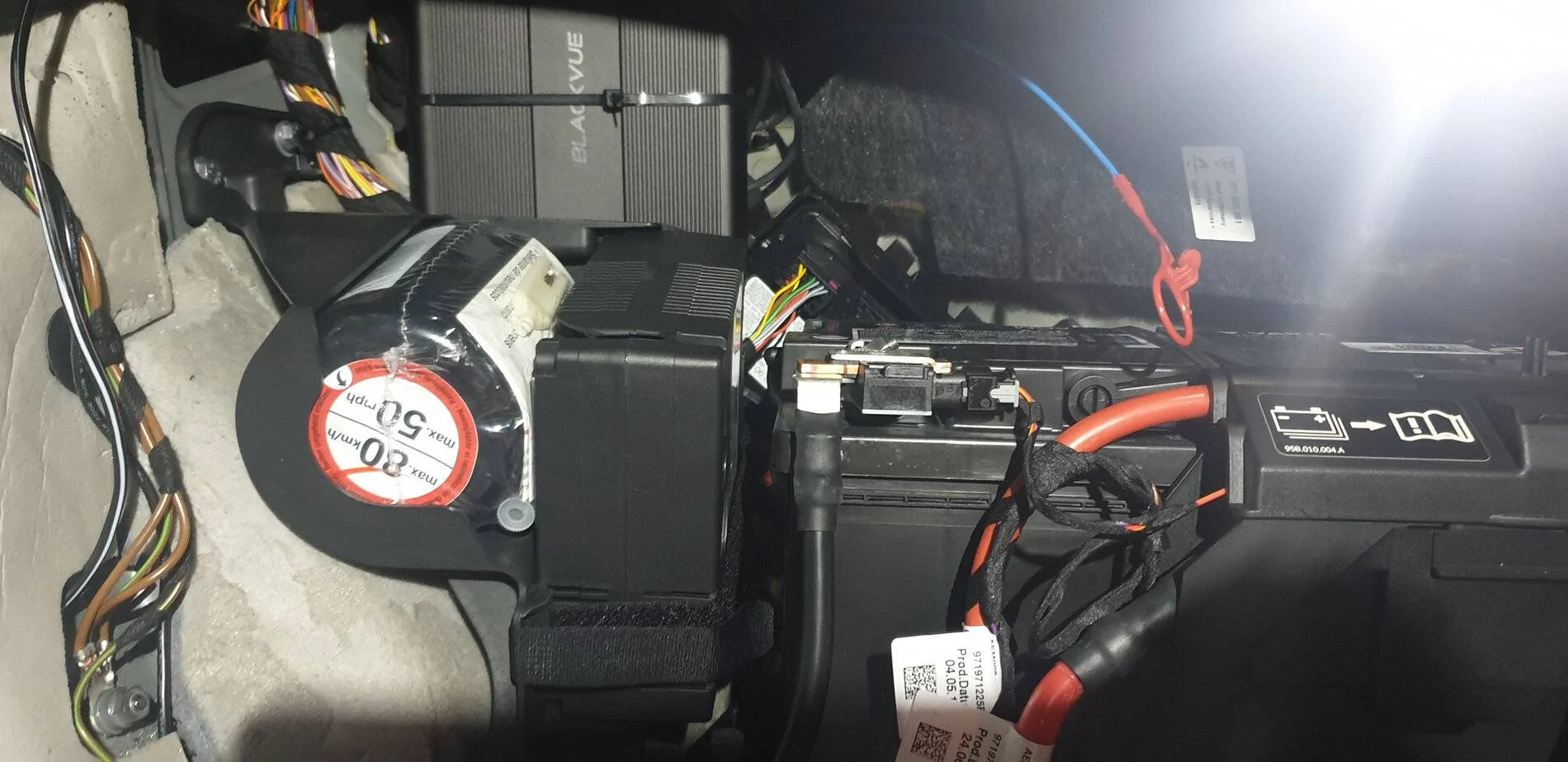

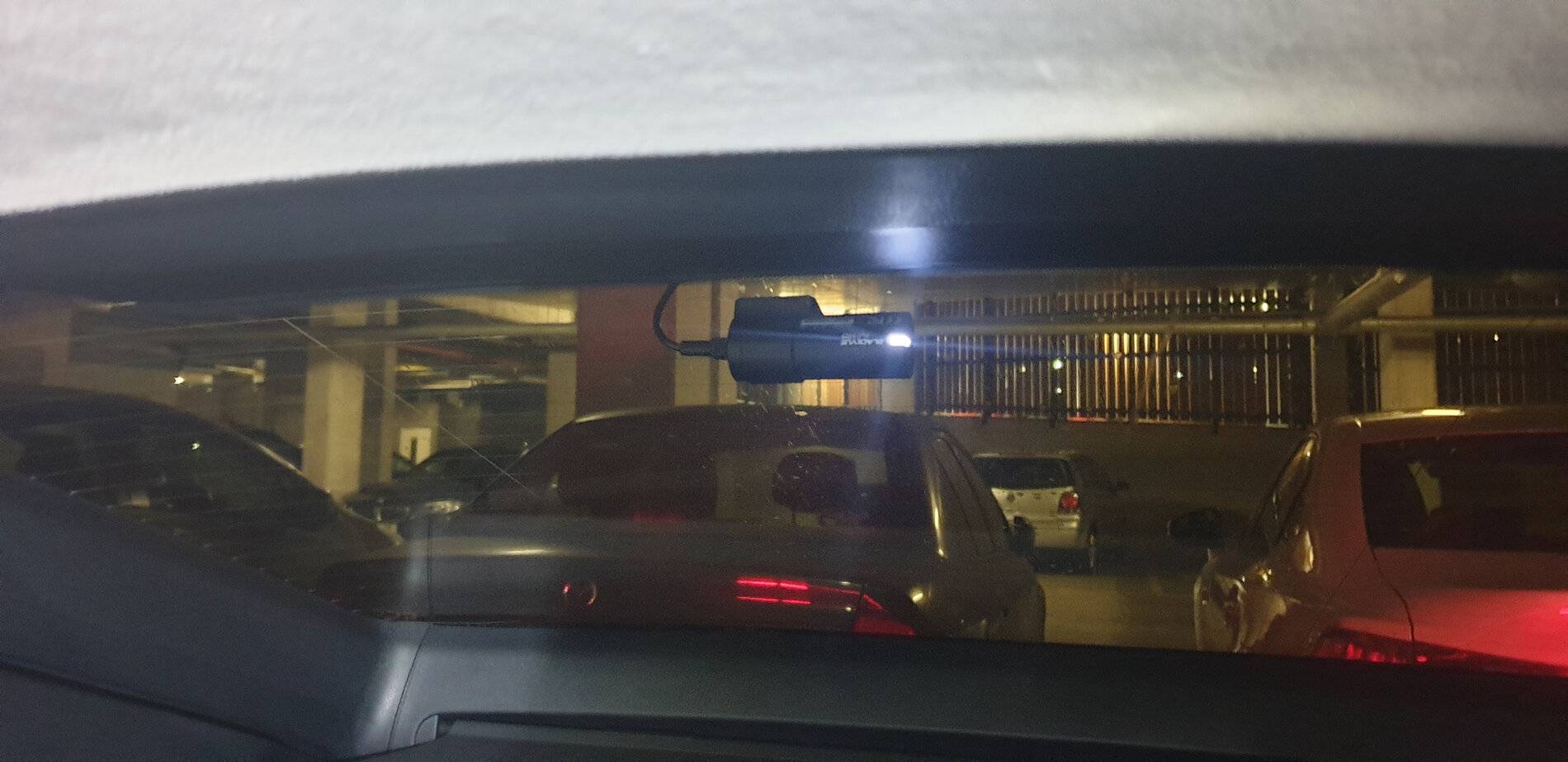

On my Panamera I had a BlackVue DR900S-2CH professionally installed, including the dedicated battery unit (Power Magic Battery Pack). It worked very well and I was very happy with it.
However, I had an unrelated warranty issue and my Porsche Centre refused to deal with it until the "unauthorised non-Porsche equipment" was removed.
I didn't want to be stuck on the side of the road in the future with them refusing to help – so I removed the entire thing.

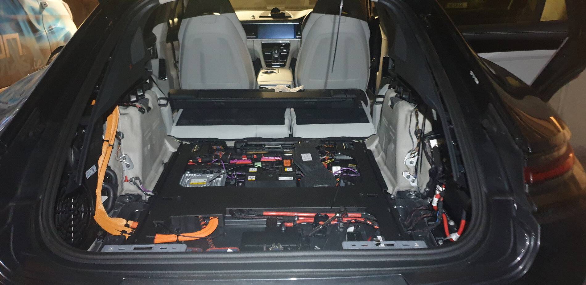

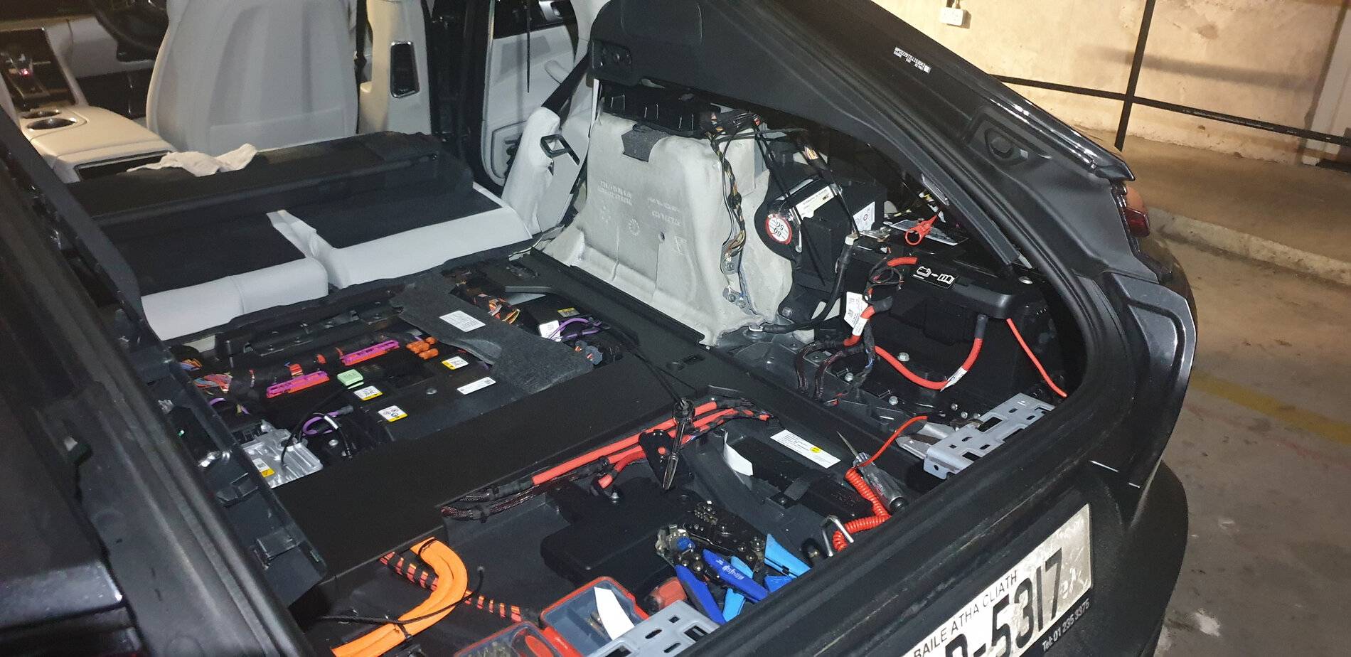

For reference, here is some of the installation pictures, focusing on the Power Magic Batter Pack install in the boot.
Porsche Taycan Dashcam 20200123_113944
Porsche Taycan Dashcam 20200123_113949
Porsche Taycan Dashcam 20200123_113957
Porsche Taycan Dashcam 20200123_114716
Porsche Taycan Dashcam 20200123_114722
Porsche Taycan Dashcam 20200123_122606
Porsche Taycan Dashcam 20200123_122614
