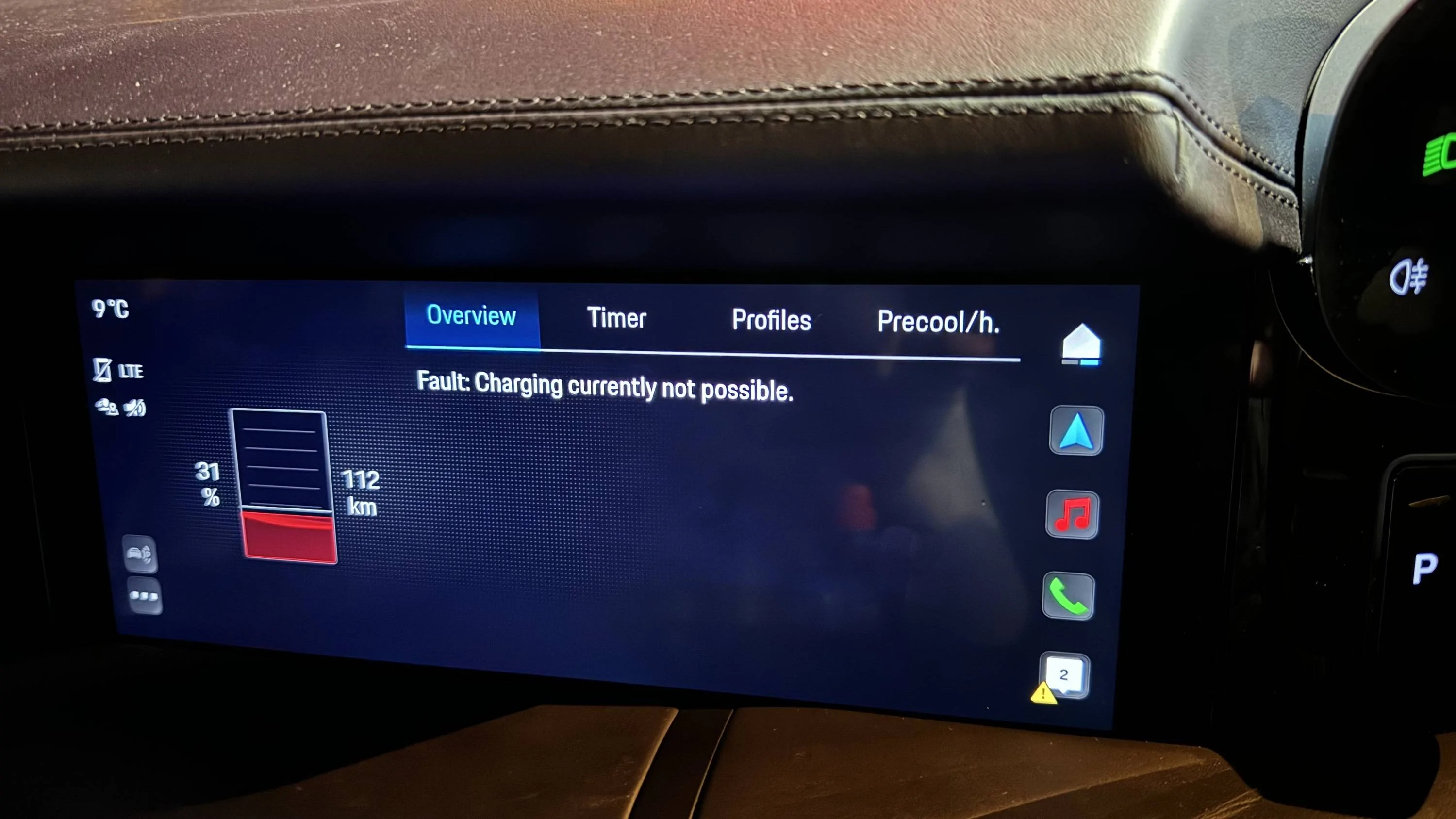

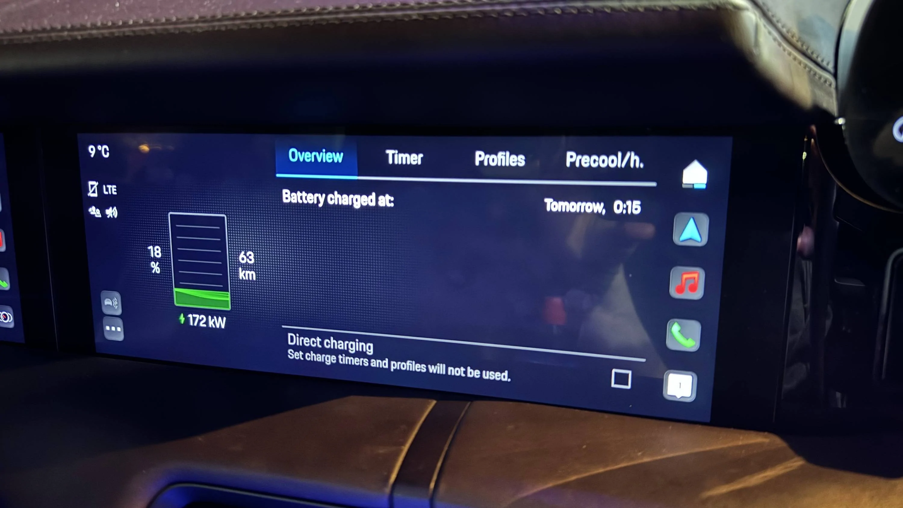

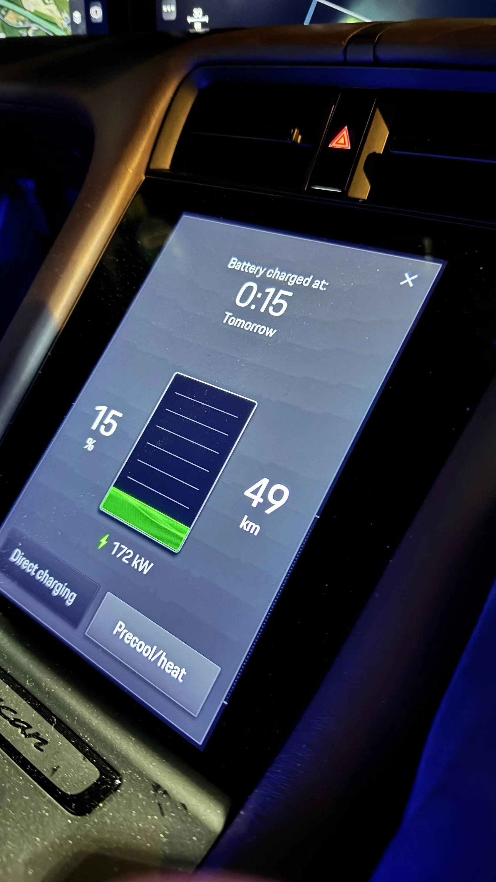

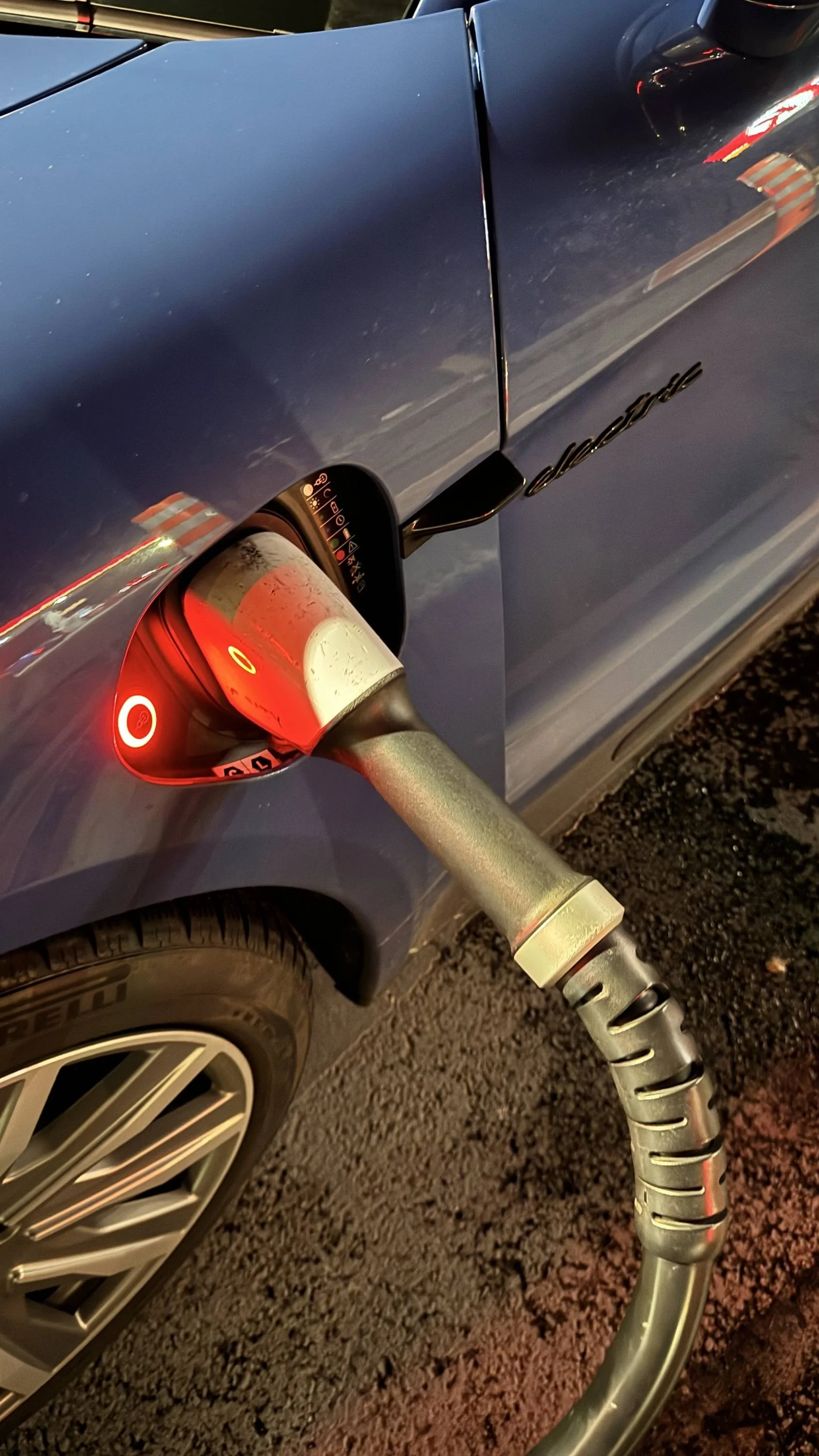

I haven't been driving my Taycan too much recently – and using AC charging from home almost exclusively. Which I think has been hiding a DC charging problem I might have for the past few months.. I’ve tried three DC charging sessions over the past six weeks:
Session 1 (mid November): 150kW/400V Delta charger (ESB network). Started at 50% SoC and it received energy at 150 kWh adding about 6% when the session failed.
Session 2 (earlier this week): 200kW/800V Delta charger (ESB network). Started at 12% SoC and it received energy at 200 kW adding about 8% when the session failed.
Session 3 (today) : 350kW/800V ABB charger (IONITY network). Started at 12% SoC and it received energy at 247 kW adding about 8% when the session failed.
When a session failed the following happened each time:
Anybody ever seen this pattern?
- No amount of attempts (or moving to another charger at the station) will allow a DC session to start again. You will always get a red light after auth.
- No amount of attempts at AC charging will start – including driving 30 mins back home to our reliable home AC charger after failed session 3 today.
- Locking the car for a few hours (or overnight) will reset things so that AC charging will start and be successful to charge car to 100%.
- Locking the car for a few hours (or overnight) will reset things so that DC charging can be re-attempted – but it will only accept 6% to 8% SoC before failing and starting the whole process all over again.

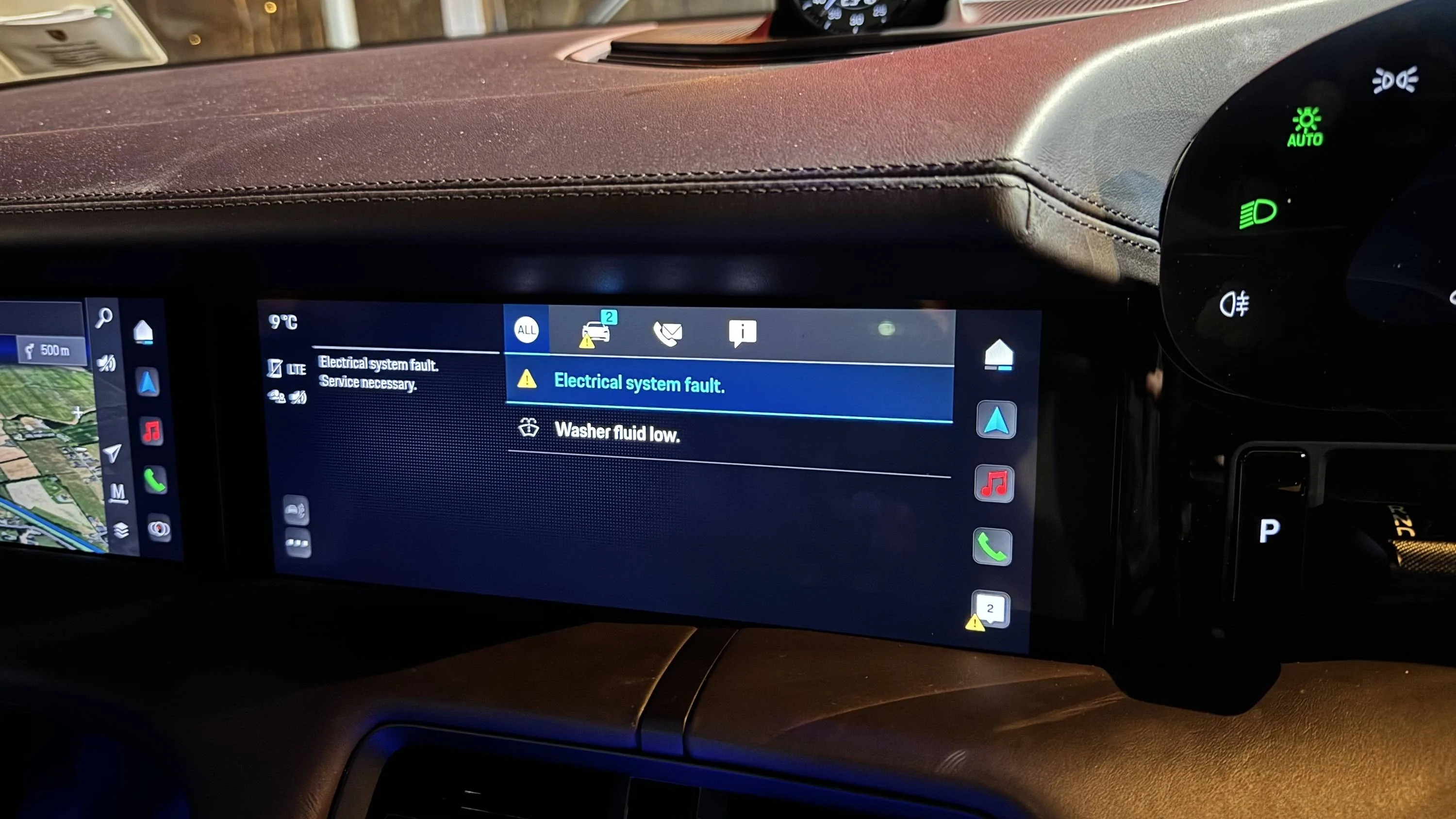

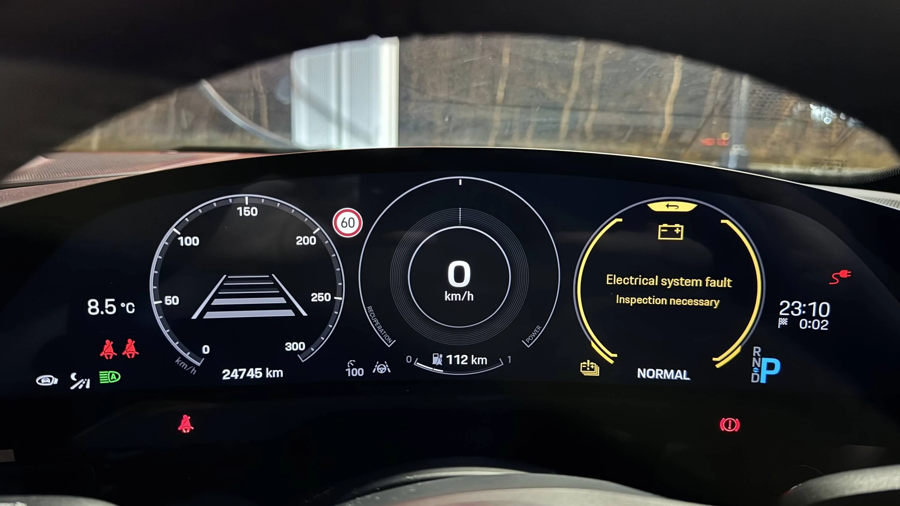

- When the session fails – a “Yellow electrical – inspection necessary” message is shown and the car does need to be switched off and on – before you can put it back into drive or reverse to move it.
