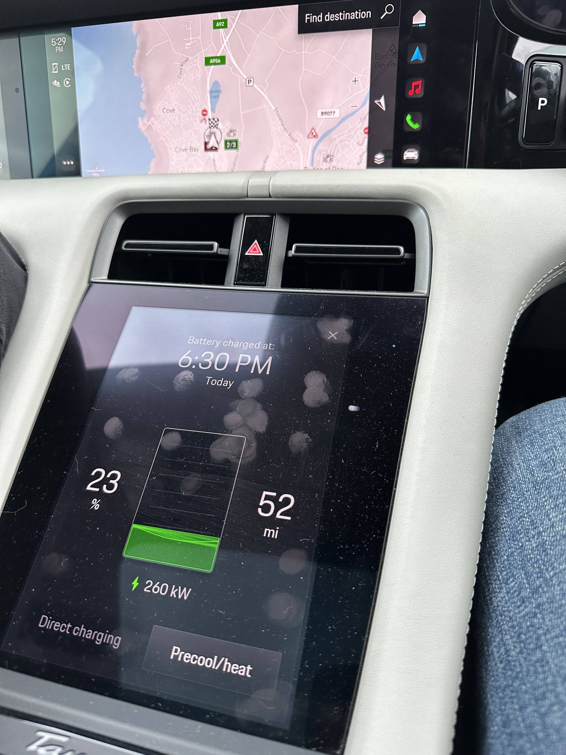

I’ve been an EV driver since 2016, so fully drinking the koolaid, but it is a shame that there are so many variables than can affect DC charging speeds. I regularly use Chippenham Ionity and almost always get 260KW as I will have the charger set as a stop in nav, will be less than 20% SOC on arrival and will often put it in to Sports+ mode for the 10-15 mins before arrival to get a bit more heat in the battery. Cobham Ionity is another matter and regardless of the car state, I’ve never gone above 160KW.

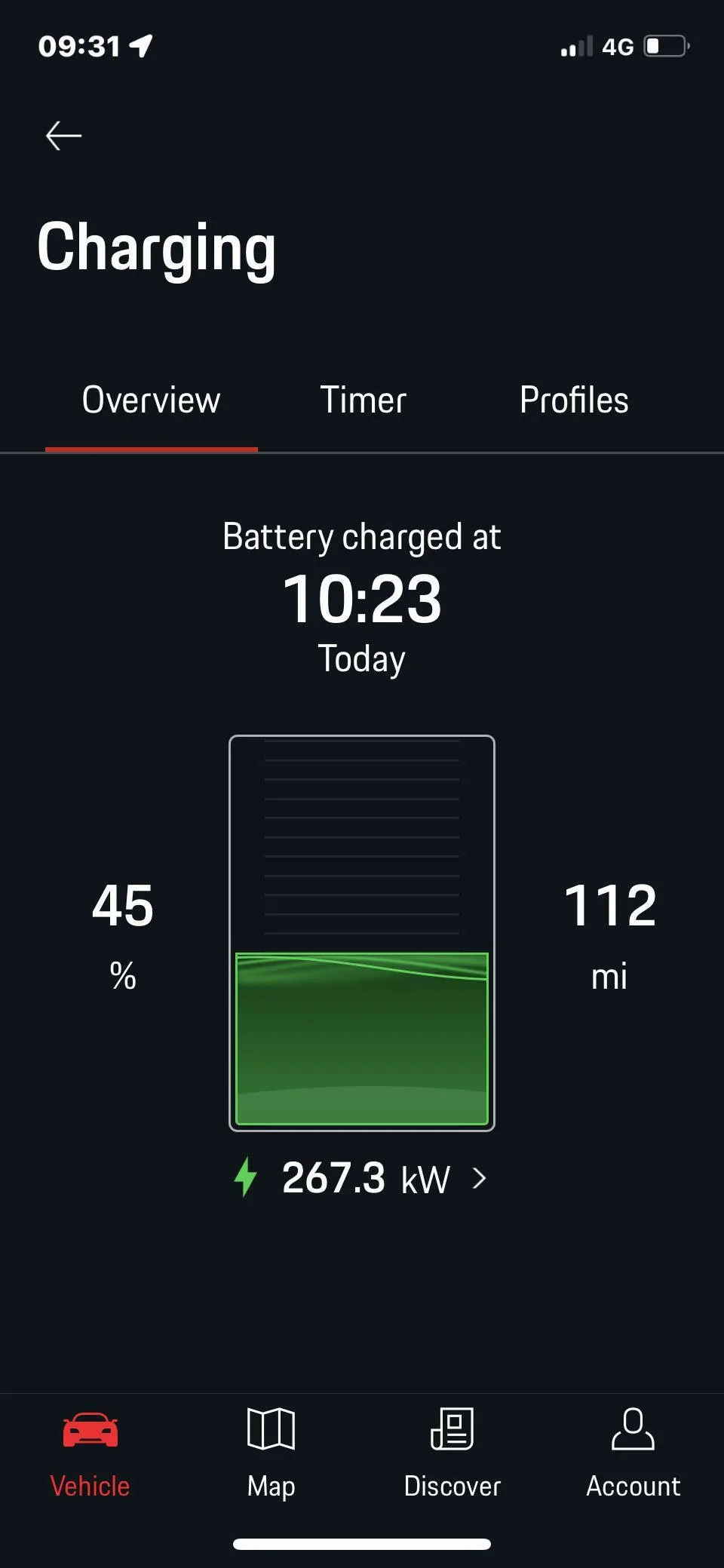

Ive had an Audi EV for some years. From plug into a commercial DC port it ramps straight up to 150kwh charing right the way to 80% full before ramping down in steps for the final 20%.
Same with a Taycan and its no faster then 100kwh charging for much of the range, The advertised >200kwh charing seems to be for a relatively small % of the battery. So if you rock up to a charger with say 50% full, it does not really charge that quickly at all.

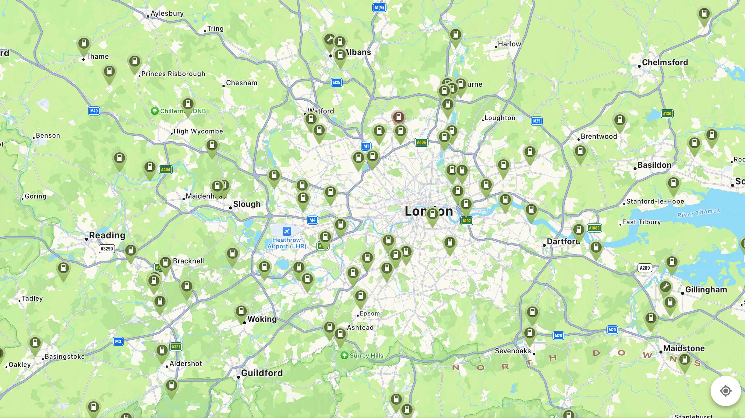

19kW AC is probably useless these days.
In UK/Europe 22kW is quite frequently found in car parks, hotels and city centre street chargers, where three-phase power is available. See the example map here, filtered to show 22kW only. There are even more in Germany and France than in the UK.
On a road trip 22kW can be very handy, eg charging in a city car park while doing some sightseeing or having a meal.
