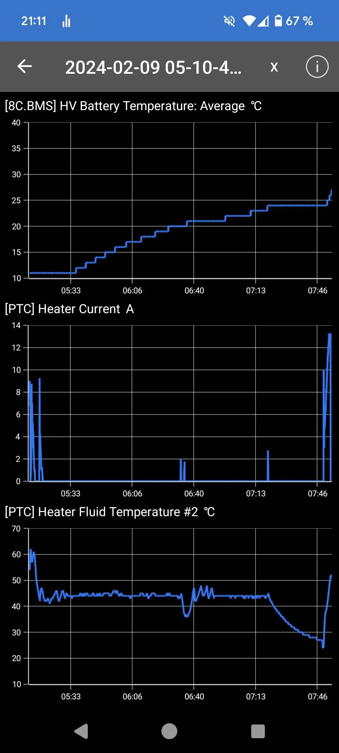

I did two similar trips of 720 km/ 450 miles requiring 3 charging stops. In one I did not use the NAV (no preheating), in the other one I used it (preheating). In both trips the car stayed outside the day before, and T batt. was equal to the T outside (about 10° / 12°C).
I was driving on the highway, at a constant speed of about 130 km/h / 80 mph.
From start to 1st stop:
No preheating
: heater was not active, and it took about 2hrs to raise from 11° to 24°. At that time, about 50 km / 30 mi from 1st charging stop, I switched from Range to Sport Plus, keeping the same average speed. As a result, the Heater fluid temp. … sharply decreased and T batt. stalled at 24° !
Driving at 240km/h / 150mph on the Nürburgring might show a different behavior, but I was on public highways…
Porsche Taycan Dissapointing tacan DC charging Screenshot_20240212-211148
Conclusions: first, it takes time (a lot…) to increase batt. temp and you won’t reach the desired temp. for fast charging (about 35°) before you have to stop. Second, switching to Sport Plus mode does not help.

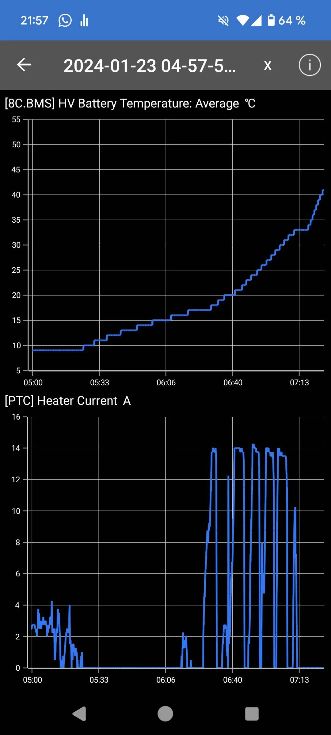

Preheating: I have two sets of data here.
A: exact same trip. Battery has plenty of time to raise to 33°, heater starting about 1h before 1st charging stop.

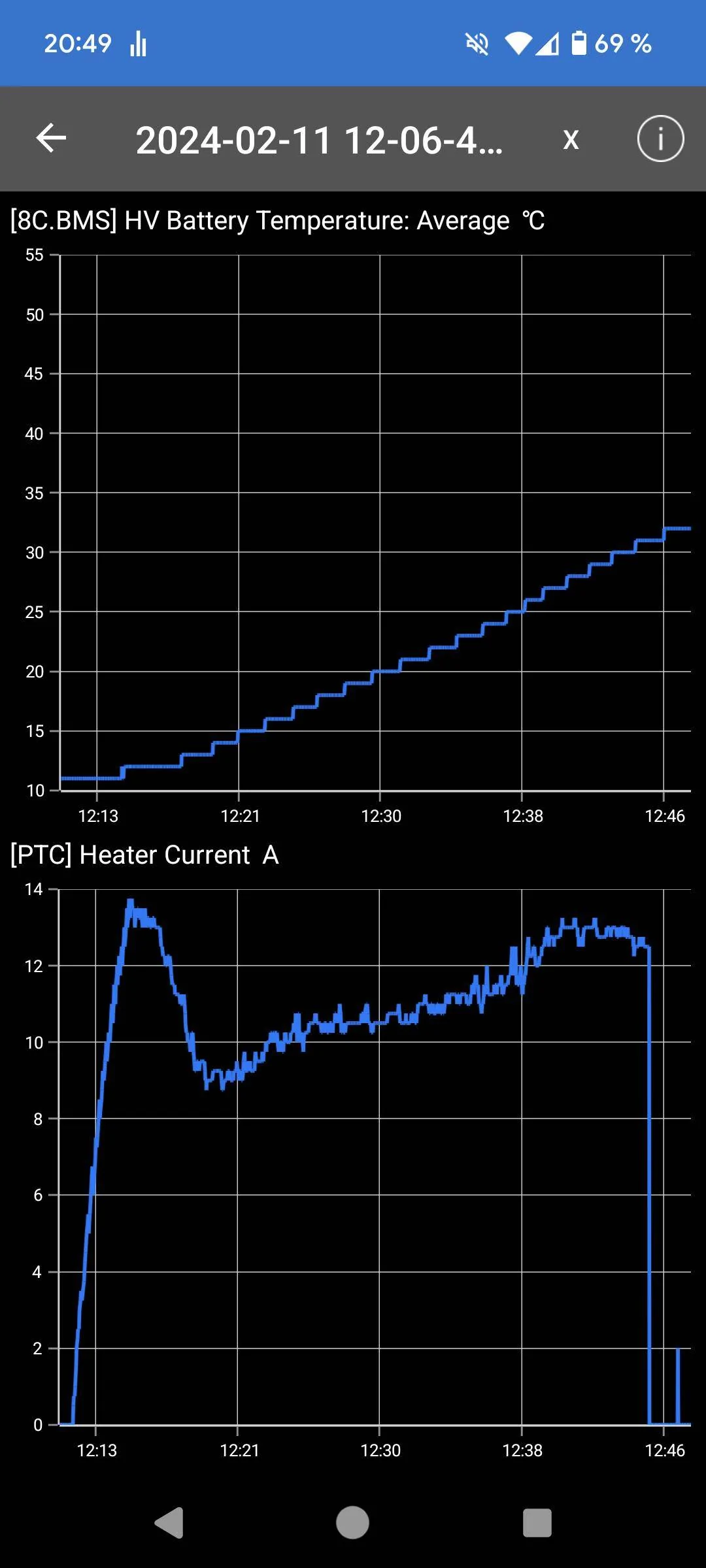

B : in that one, 1st charging stop was quite close from start (about 50km / 30 mi). Batt. temp increased from 11° to 31° in 30mn (6 times faster than without preheating). Heater was working full speed, more than 10A. I don’t think it could deliver more.
Porsche Taycan Dissapointing tacan DC charging Screenshot_20240212-204916
Conclusion: you need at least 30mn to reach the best conditions for fast charging. That would double if you start from -10°, or divide by two if you start from 20°. That’s a rough estimation.

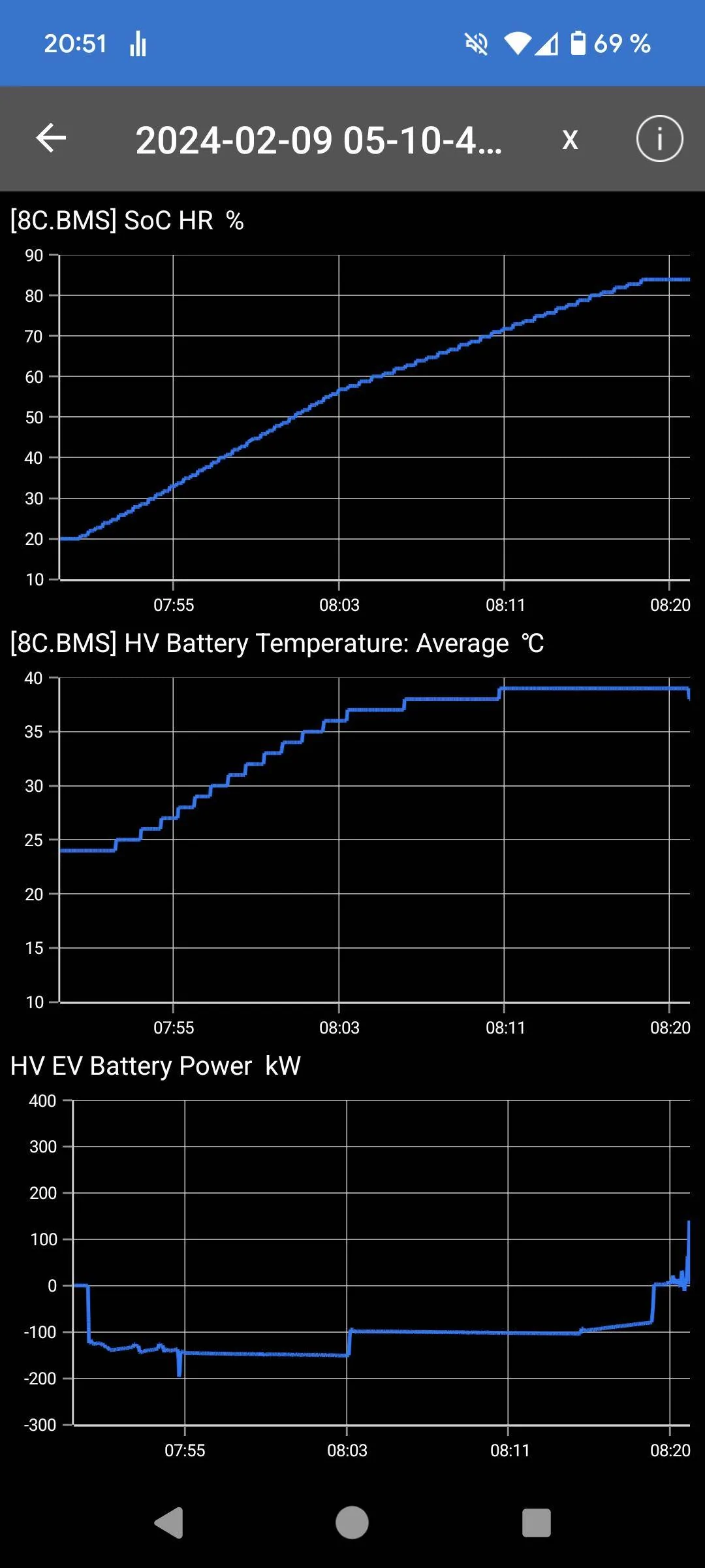

1st charging stop:
Unfortunately we have now another important parameter to consider: the initial SoC. Difficult to control in real life, so whatever follows may strongly depends on it. There was not much difference in the two trips however.
No preheating: starting from 20%, charging speed was about 150 kW until 55%, then went down to 100 kW until 80% (I stopped charging soon after). Decent average value overall : it took 26mn to go from 20 to 80%

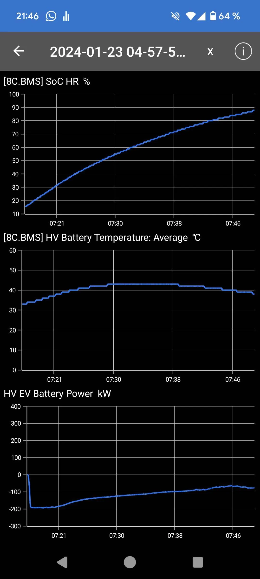

Preheating: exact same trip (trip A - ie driving for more than 2hrs before charging – same outside temperature) but with preheating, this time charging with an initial SoC of 16% : charging curve was a bit better (up to 200 kW) at the beginning, but worse at the end (reaching 80%). It took 25mn from 20 to 80% …. 1 mn less than the no preheating trip

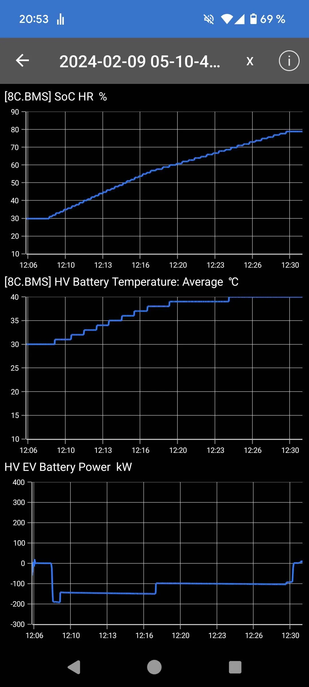

In trip B, where I started from a higher SoC(30%), charging speed went briefly to 200 kW, then slowing down to 150 and 100, similarly to the no preheating trip, at about the same SoC values.
