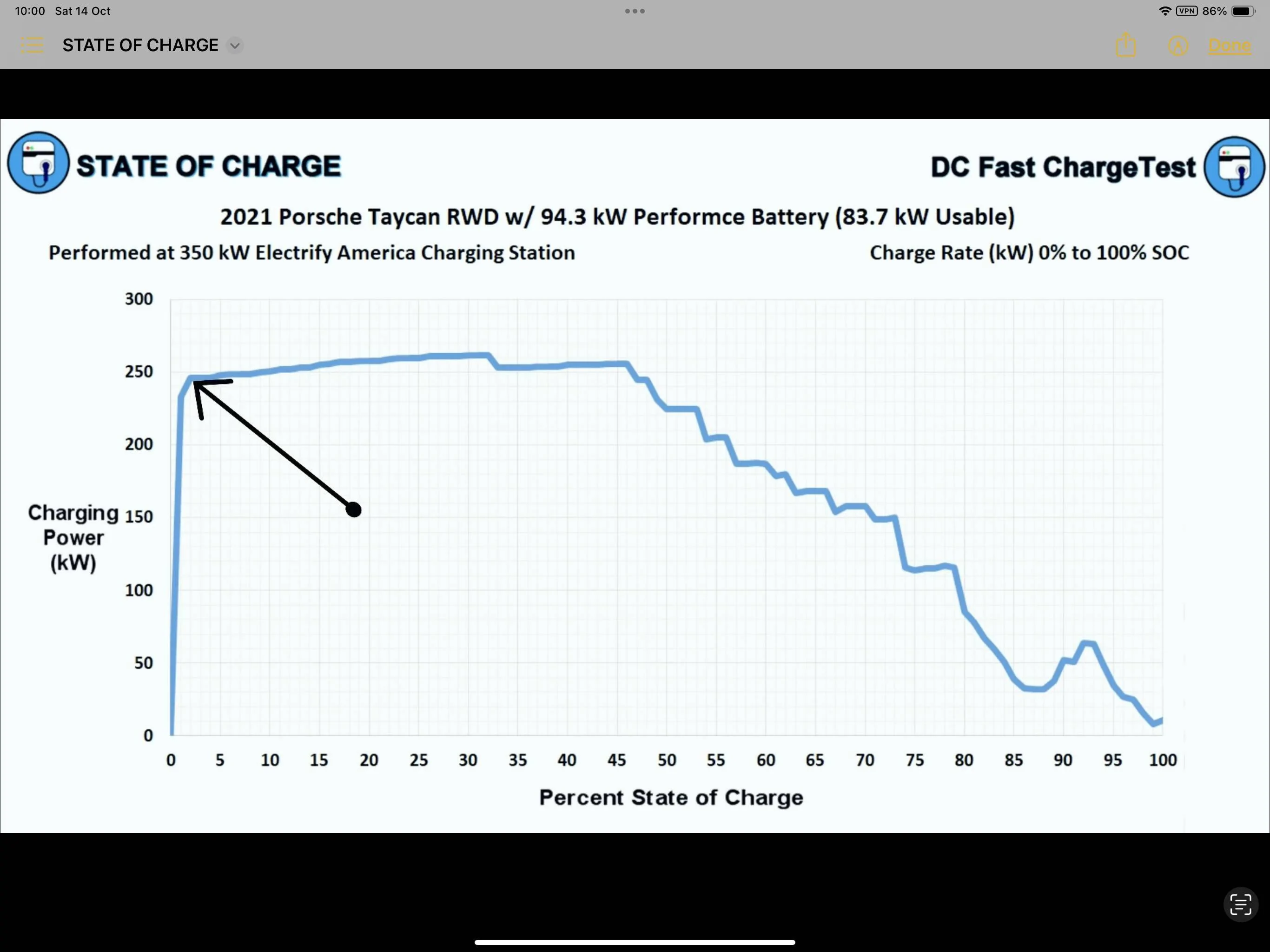

-You need to have the battery preconditioned and temperature could be close to 40 C before you plug in. Then you will certainly on an Ionity station see up to 260 kW at low stage of charge. At 50% it should still be above 150 kW though.
There are so many photos of charging rates on this forum showing more than 260 kW rates.
And search the internet for charging tests with the Taycan and you will find charts like the one below. This is done by a very well known and respected guy on you tube!!

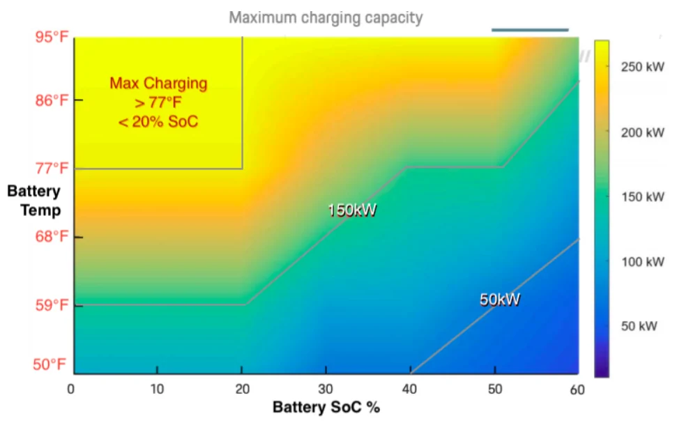

Here are charging speeds you should expect, assuming the DC charger is 800V and is able to provide the power. 400V chargers you are limited to 50KW or 150KW if your car is equipped with the optional 400V 150KW DC charger upgrade (AFAIK you have to spec it with the car, cannot retrofit like upgraded AC charger).

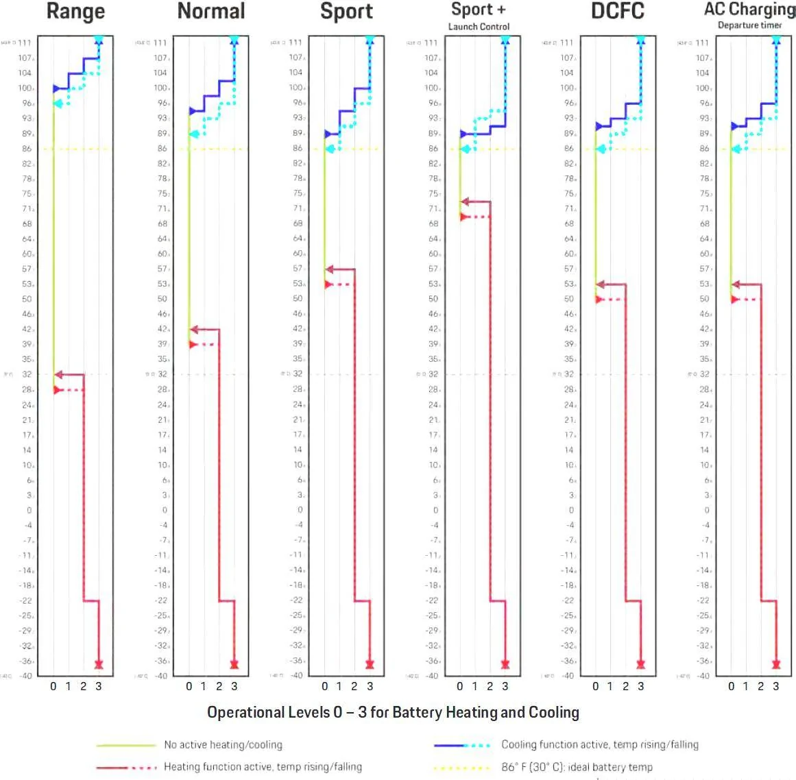

Yea, it's an oversight, but requires integration across multiple companies, so I can see that taking time to work out. I use Taycan navigation for trips with DC charging, though sometimes I use Waze since I typically drive in Sport+ on highways. which keeps the battery close to the optimum charging speed (especially on fast highways with 80mph limits and possibly mountains to overcome). Waze doesn't add charging stops (at least yet), but Apple Maps does (if you set it up in MyPorsche), so technically driving in Sport+ and navigating via Apple Maps should work ok. Below are target battery thermal ranges for different modes. With Apple CarPlay integration, lack of preheat of the battery does seem like a silly oversight, since CarPlay already facilitates controlling of car functions (HVAC, etc) and communicating back the battery levels including estimated battery level at the charger, so the fact that battery preheat functionality is missing seems like engineers at Apple vs. Porsche could not agree on how to do this, or forgot it would be needed in the first place (most of them probably don't drive EV's).

If you arrive with 50% SoC, you need your battery to be at 95F (35C) to achieve 250KW charge rate, and it will drop quickly as the car fills up (at 60%, your max is probably 170KW with hot battery). See the graph in posts #9 what you can expect based on temperature, and post #4 what to expect >60% assuming nice and hot battery.

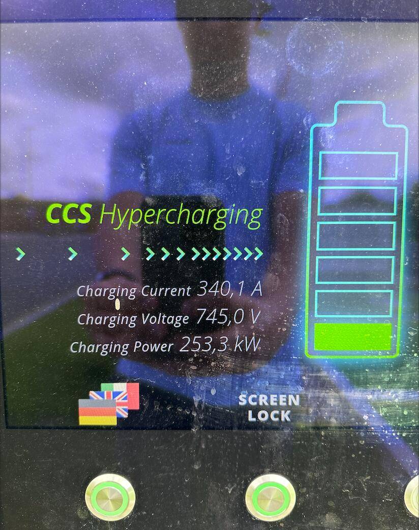

It does charge, really fast! Mine is set to charge from 20% so I went inside the gas station to get water and a coffee. 15 minutes later battery was 80% and ready to go.
