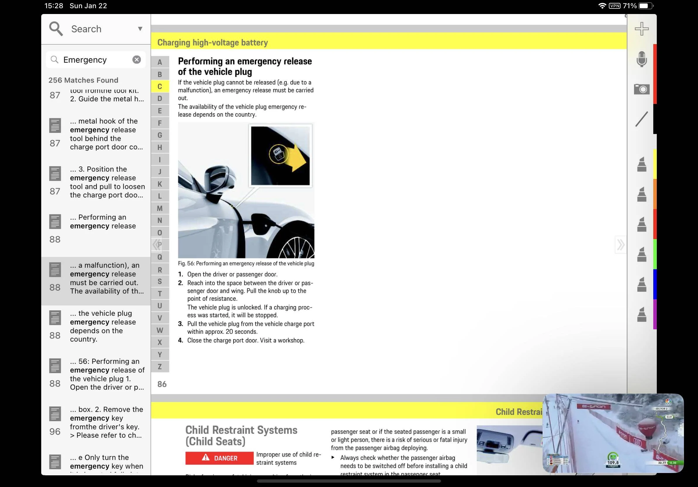

Hello! Anyone have this problem and found a solution? Thank you! Taycan Turbo S.

I think there is a manual release if you look in the manual. And/or you can jump start the 12V battery which would then presumably allow you to release the charge cable

Thank you Midlifecrisis for the manual lock. Not sure about jump starting…read some warning’s about it for Taycan.
