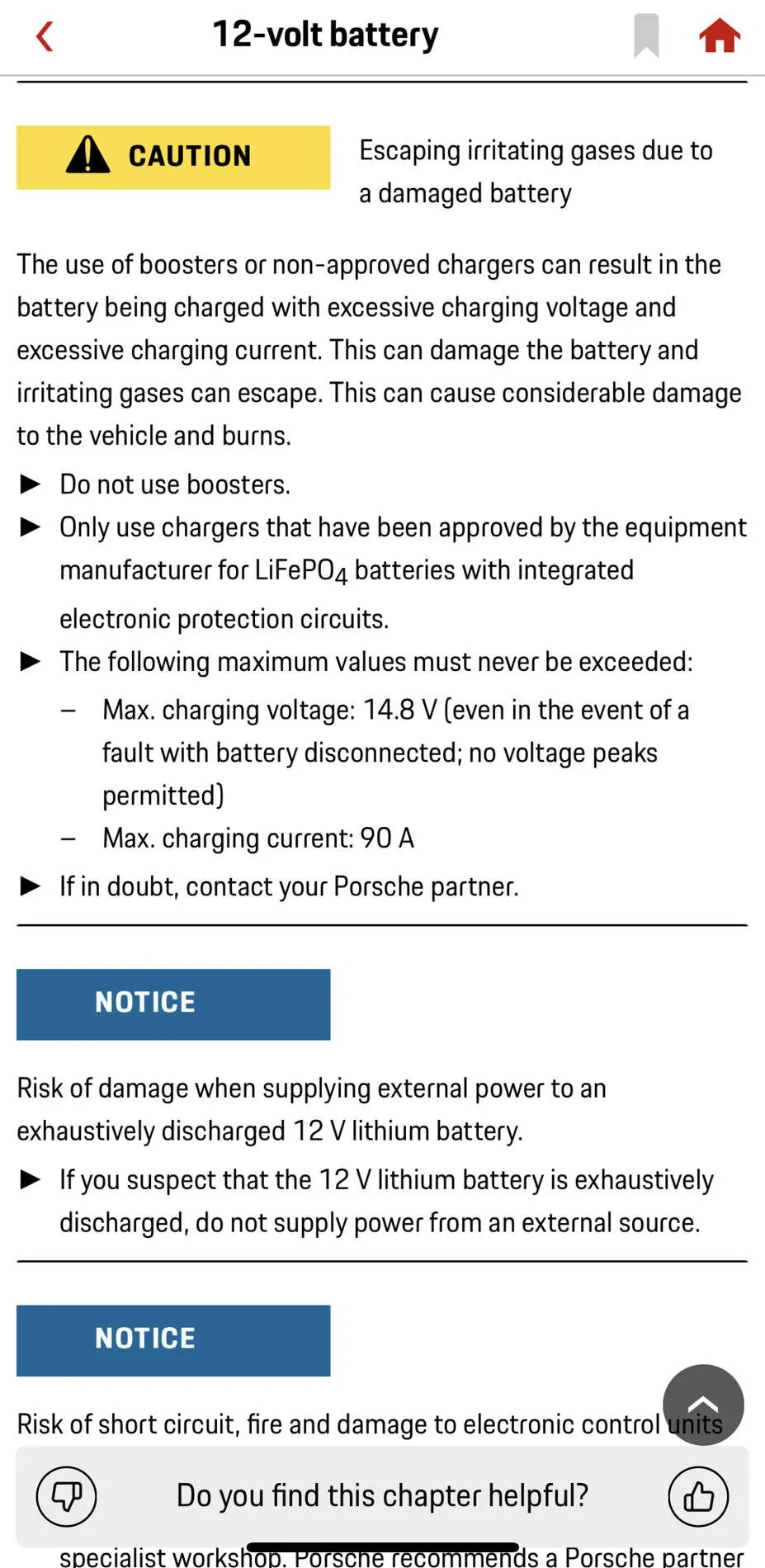

This stuff is complicated. Leaves my head spinning. I don't think Porsche is going to recommend a Noco or any other booster other than there own equipment. The only thing that seems to apply is that people have reported a Noco type booster can successfully wakeup the car.
Porsche talks about CC/CV or pure CV characteristic charges. So who makes those and what are they?

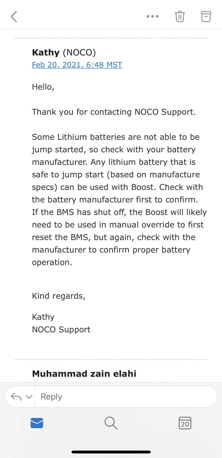

Ihave also asked noco support and attached their reply
Porsche Taycan Dead 12v battery again 3D4AA7C4-F2EA-4892-9D10-7543DFBEDD5E
Porsche Taycan Dead 12v battery again 9EC3240C-437C-4CEF-A17A-99A9E211B20C

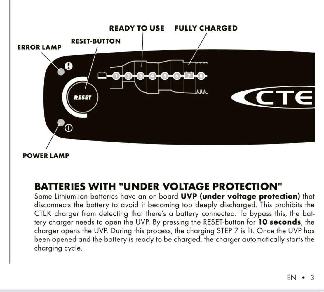

If you look at the CTEK site and download the manual for the charger, it describes how it will handle a Li battery that has been protected against under voltage. Maybe this function in the CTEK chargers makes a separate booster battery unneccesary. I am not an EE so perhaps others can comment.
Sounds good though and CTEK are a well known company with great chargers and maintainers. The fact that Porsche has branded it as well as a lot of other car manufacturers is Comforting.
Porsche Taycan Dead 12v battery again 3F8679FE-A9F9-4B7C-B531-20D8531B65FD

That's interesting. I'm not familiar with this unit but if it can supply enough current to allow the system electronics to re-start, that will open the under voltage protection cut-out relay. If it us opening the UVP via some other method, that would be concerning - except for the indication that Porsche is branding this same unit as their own...
