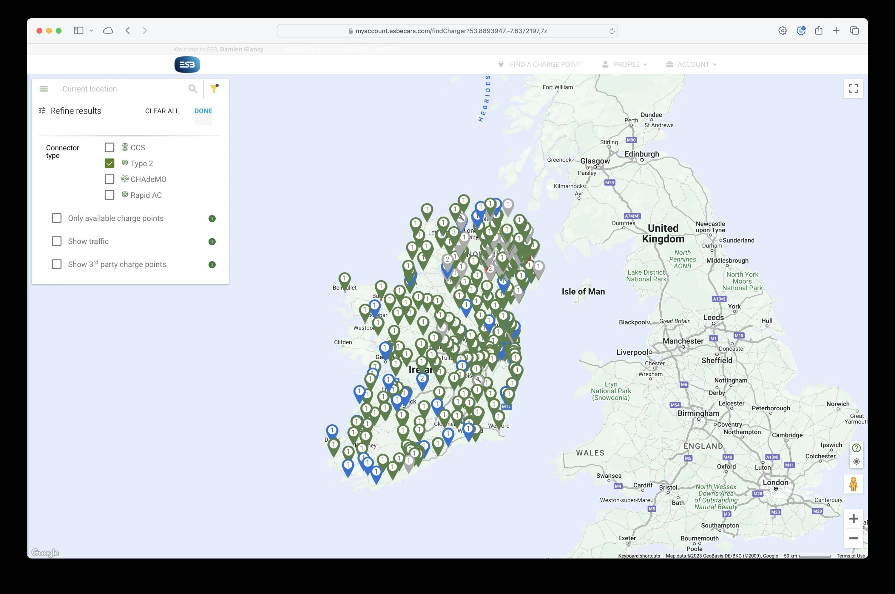

22 kW public charging remains popular in Ireland – almost every small town and village has a few. They work well when stopping off for lunch/dinner or using them where a hotel doesn't have destination charging.
Being able to pull 2x the energy from them as most EVs is great here!

euro question; I've heard both Ireland and France have a lot of 22 kW public chargers? is that true (we know it is for Ireland given above post)
is/are there other euro countries that have a lot of 22 kW AC chargers? or is it just Ireland/France?
_IF_ your countries infrastructure has 22 kw/19.2 kW infrastructure this is a GREAT option NO DOUBT!!!
North America lacks a robust/common 19.2 kW L2/AC infrastructure and more is not being built in any concerted manner…
I love FASTER charging - but only if you can actually take advantage of it.
