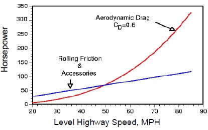

I’m confused by what lessons you learned. Just based on the stated facts it gives me the impression you haven’t fully figured out how EV’s work, or at least how to most effectively and efficiently use them. Like others have stated, not starting the trip at 100% and still hoping to make it non-stop is baffling, again, it gives me the sense that you are misunderstanding the 85% recommendation in the user manual. Also, the fact that you seem disappointed that you didn’t even get the estimated range when you are driving exceptionally fast. That gives me the sense you viewed battery capacity as a fixed distance, when it’s actually just the amount power available. How fast that power is depleted, and a resulting distance achieved, is a direct function of the rate of consumption.
As @Tandrup posted it’s not linear, power required is an exponential function of speed. To piggy back on his post, I’ve attached a sample speed/drag curve to help you visualize how much extra power you are consuming with your chosen driving speed. This is no different than an ICE vehicle, EV’s are generally more range limited than the ICE’s you are used to, so it emphasizes those limiting factors. You really have to look at an EV trip as an overall time, not just how fast you are driving to get there sooner. 225 miles at 65mph will take you 3 hours and 28 minutes. At your average speed of 95 it would take 2 hours and 22 minutes, but it took two stops to charge. You didn’t mention how long those stops were, so it’s hard to say which would take longer, but you can’t realistically be too disappointed with the Taycan’s range when you executed this trip in just about as an inefficient manner possible. If efficiency was secondary to the driving experience and enjoyment at 80-110, well that’s ok too, but you have to know to expect significantly reduced range.

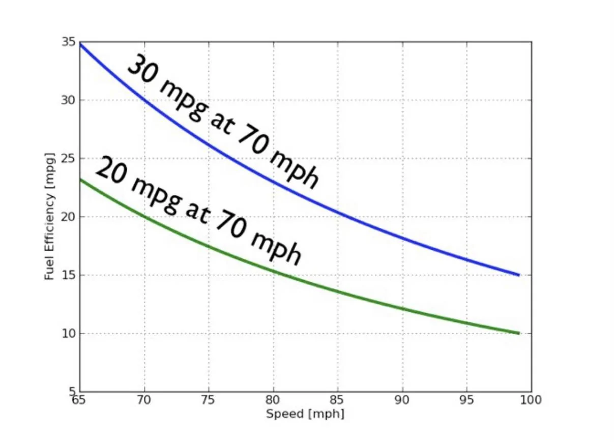

Again, no surprise that you needed to charge twice on a 225 mile trip when driving over 80mph.
From Wired magazine:
https://www.wired.com/2011/04/what-will-an-85-mph-speed-limit-do-to-your-mileage/
Porsche Taycan Electrify America 101 and Range Lessons learned on first road trip 3A86C544-3449-4175-9E03-AEA77C8B2D48
While this chart is from a gas car, the calculation of increased drag and resultant loss in efficiency is similar to what you would see in an EV: at 100 mph you only get 55% of the range as you would at 75mph. I would say the Taycan would do better due to its lower drag, but there will still be a loss in efficiency.
Drive fast, but expect to charge more often.
Depends on drag relative to rolling resistance. While the Taycan may have a low drag relative to another car, the relative change in resistance for a change in speed is the same, so the relative effect on consumption from drag is the same as well. What’s possibly different is the drag relative to other resistive forces which will affect the overall curve and what the final relative change will be.
