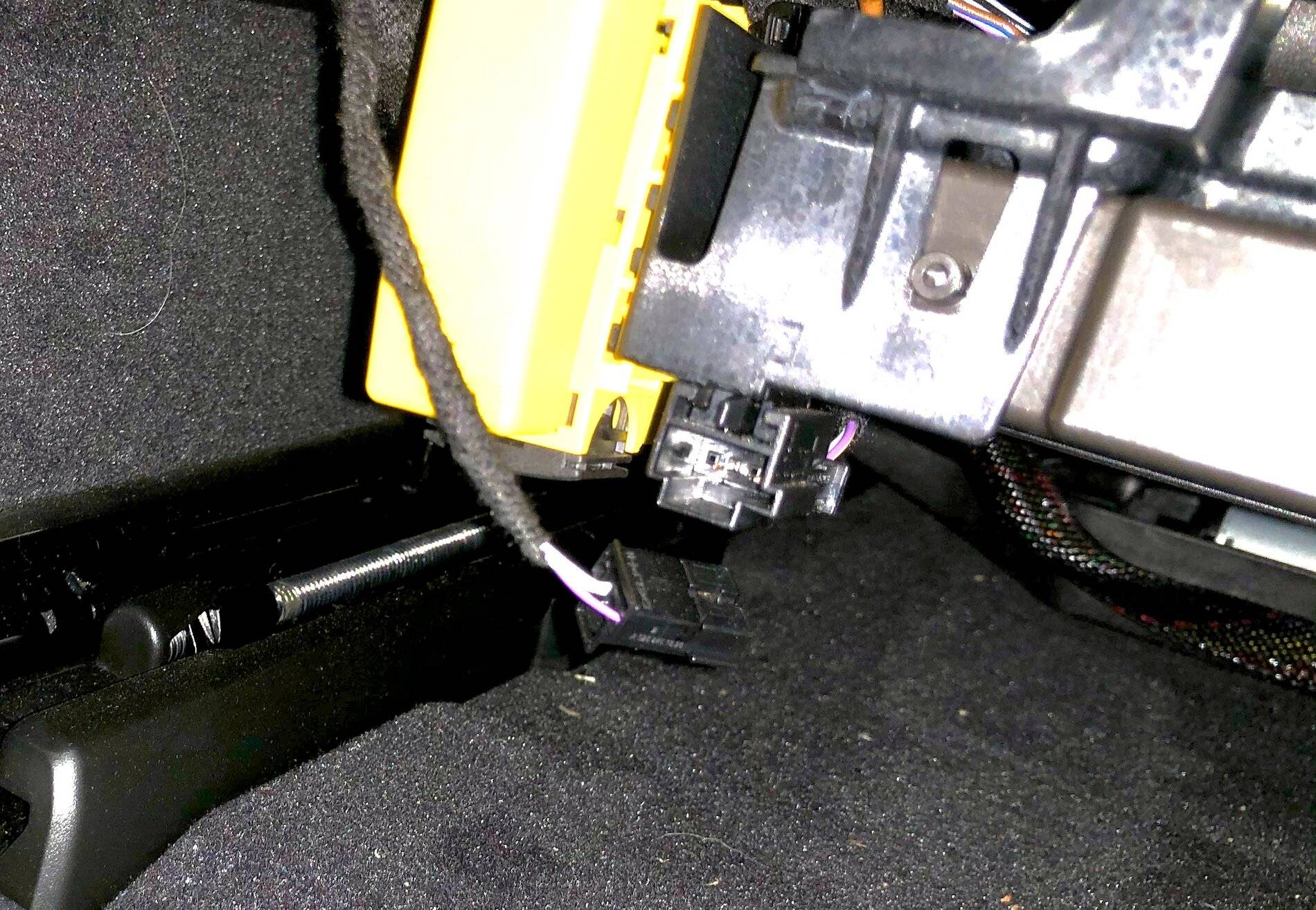

@manitou202 - FYI, I had my cooling seat go out as well... turned out to be a loose sensor harness right at the base of the seat that took 30 seconds for the dealer to diagnose and fix. Before bothering to go in, check to see if you happened to knock it out - mine got dislodged just pulling out the floor mats... unfortunately, Porsche put it in a vulnerable spot with a pretty weak connector, apparently.

Josh, Thanks for the tip on the poor sensor placement and plug issue on cooled seats. May have been the same location for Don @louv s issue during his journey when he lost heated seats.
As for Ferrari access, you may want to check on Touro. Won't be cheep though. ;)
Minor correction: I didn’t lose driver’s seat heating while driving.
Initial builders didn’t connect my Driver’s Seat Cooling plug connector.
Also, a rear seat heater wasn’t connected.
I didn’t notice either of these immediately after taking delivery because I didn’t need cooling and I didn’t sit in the back seat!
I found out because the car threw codes in the log files. But NOT in the user interface.
I fixed the CarPlay (just had to re-add my phone) and I found a loose cable under the driver seat. That took care of the cooled seat.
Thanks for the advice!!
