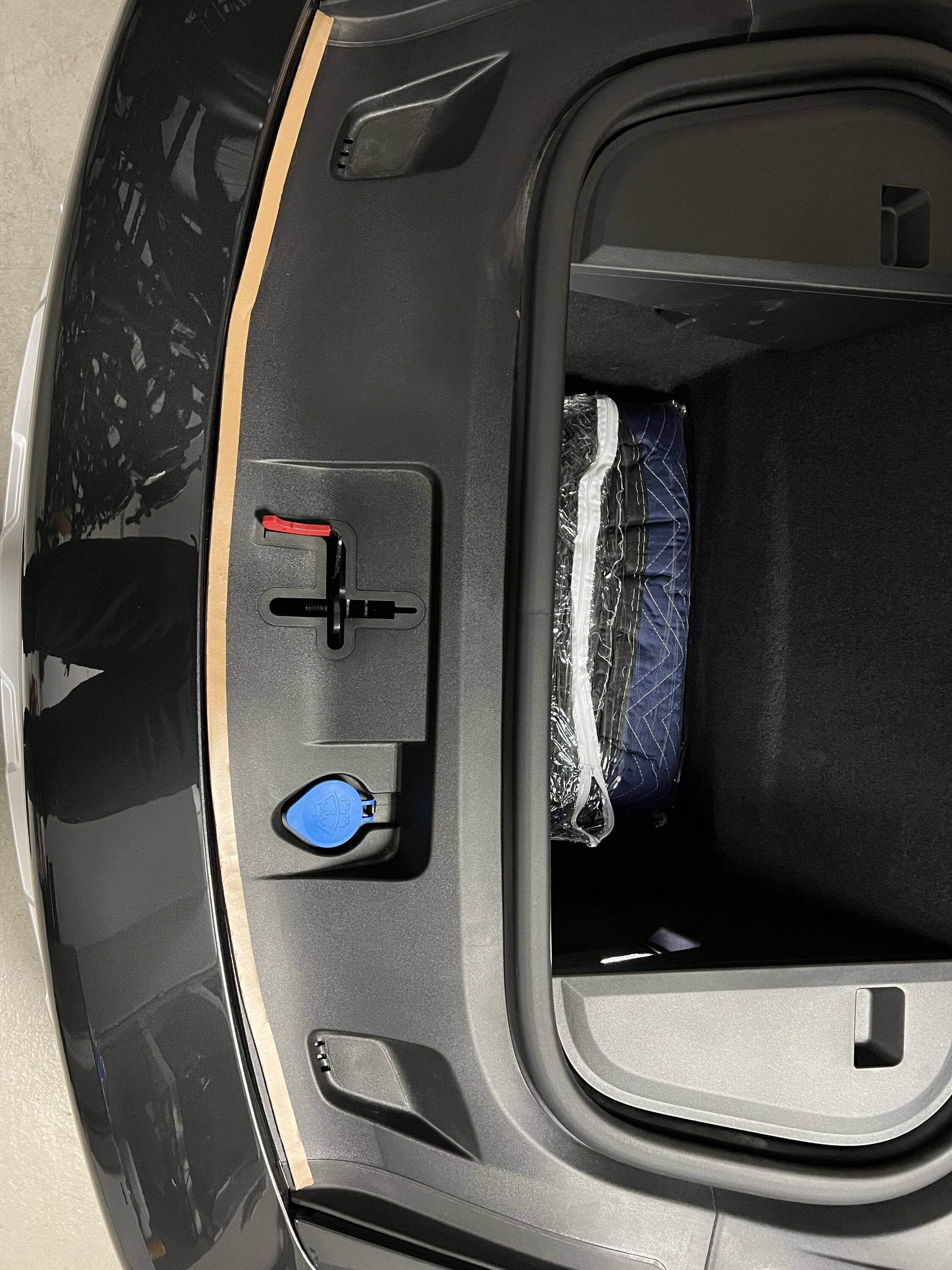

I found an old rubber strip that I put in place as the tread said. It fixed the noise. So great. Just need to change the brain one with something that will stick.
OMG this is amazing! Such an easy fix. Home depot has these rubber strips for insulating small gaps that already has 3M tape on one side. Would be perfect for this.
