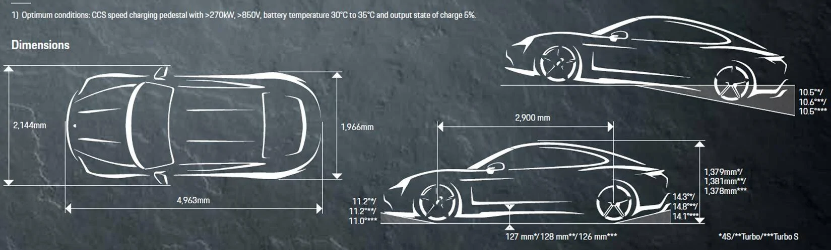

This is what you are after (except for the CT .... just add 20mm (!)) ... the online brochure hasn't been updated for either the CT or ST which would show the relevant diagram.
perfect - Thanks A - :)

FWIW - I calculated the front overhang clearance angle of my A7 as only being 10.9 degrees.
According to the diagram, The sedan/saloon taycan minimum front clearance angle is 11 degrees.
The CT will be greater still (rough estimate at 12 degrees minimum - it's a guess because I don't know the overhang - but it will be similar or less than an A7).
So my CT turbo should be fine!
This saves me asking for another test drive and a 1 hour round trip just to test if it will clear my driveway
Much appreciated - thanks!
