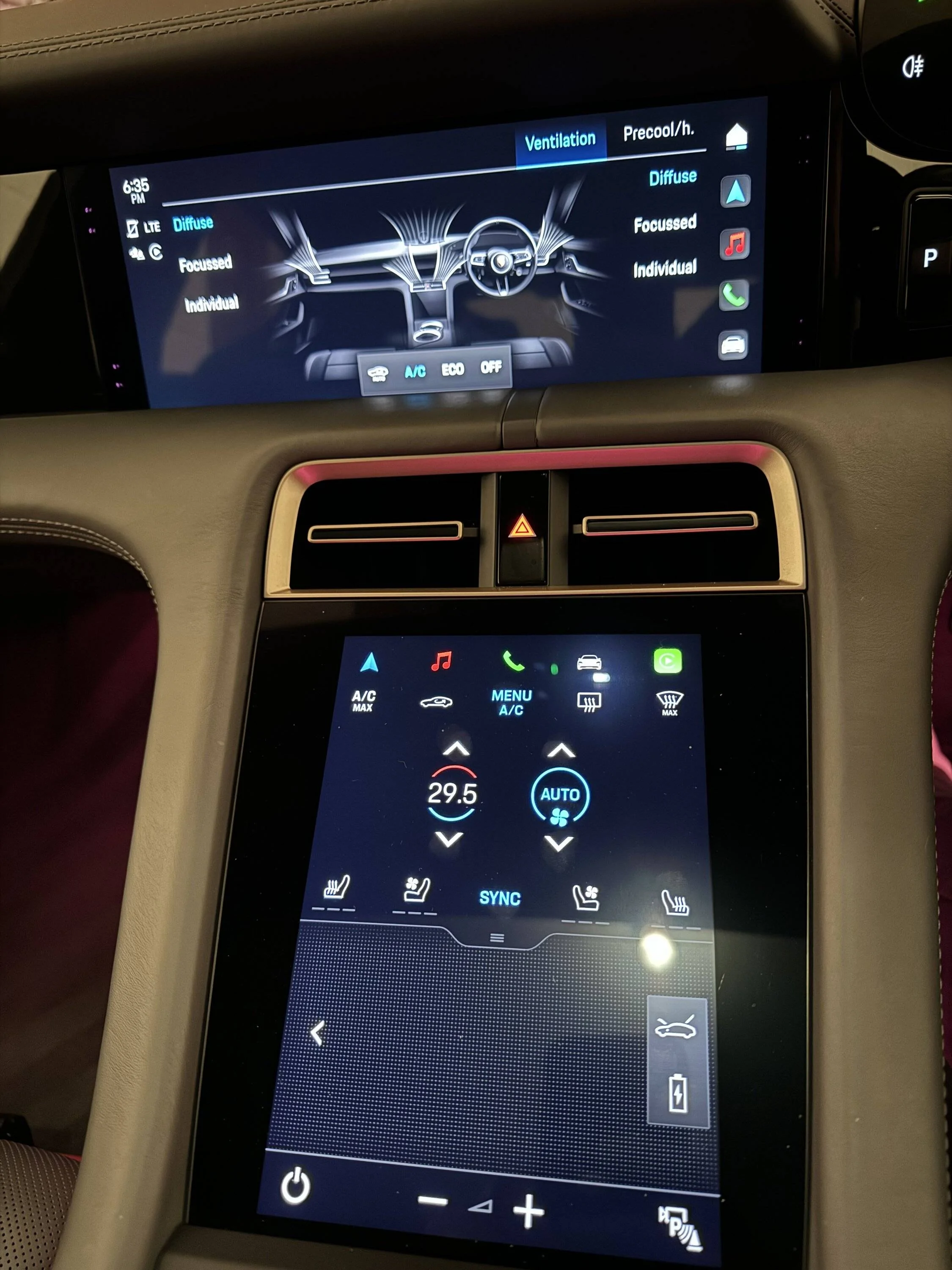

Quick sanity check Please?
I think my heater just failed. Presumably if all I get is cold air with all climate settings on MAX then it’s kaput?
Porsche Taycan Heating Failure IMG_1220
n3ophyte
Tim
Oct 19, 2023
344
454
Taycan Turbo S, Nissan GT-R
Well that was freaky! I sat in the car, powered off, with the charging cable attached and hit precool/heat on the centre display panel expecting to see the error message described in the link above. Instead, after some loud gurgling and pump whirring the car began it’s 60 minute pre-heat routine with loads of lovely hot air! Wonder if I had some sort of air-lock ?
The hot air flow continued after cancelling the pre-heat and powering on normally. We nicknamed this Taycan “Spook” due to the colour scheme but I’m starting to think it’s haunted in other ways.
Thanks for the help guys. I eagerly await my first genuine heater failure:CWL:
