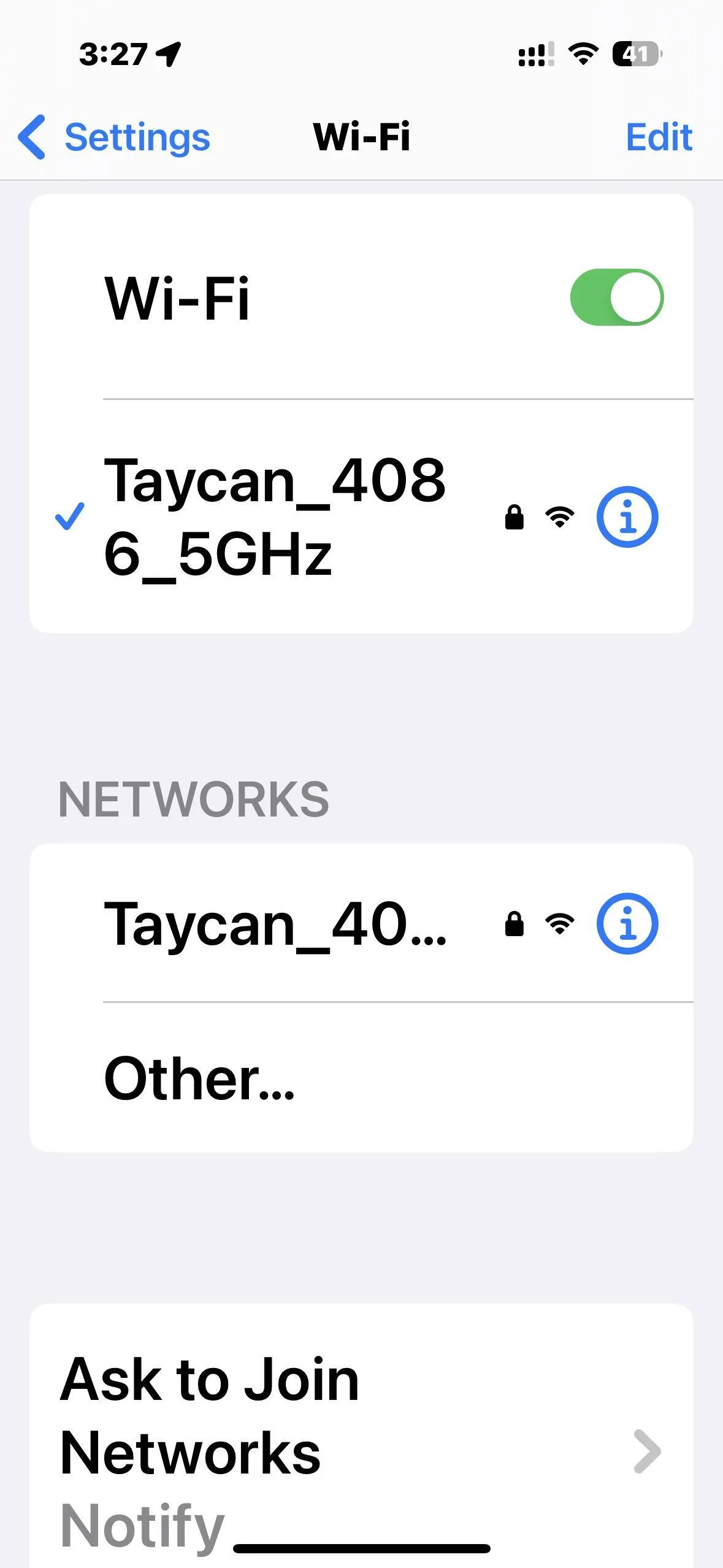

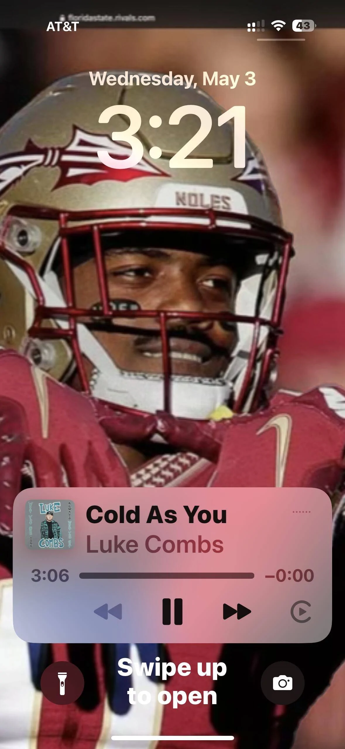

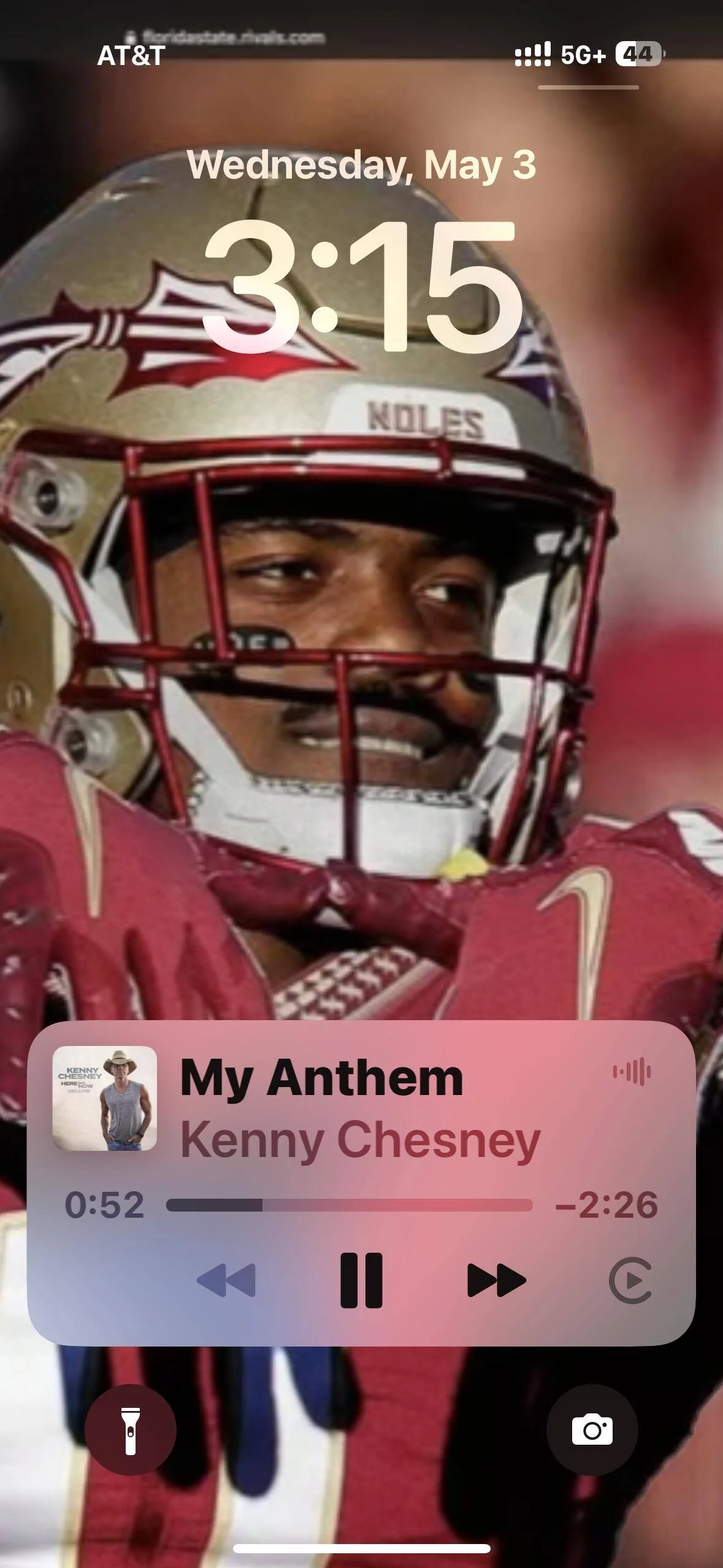

Copy on the hard wire. Here’s two pics of my home screen on the IPhone. First one with the 5G indicator top right when everything is working fine, and picture two with the Wi-Fi symbol in place of the 5g symbol, where everything on CarPlay and the internet functions of my IPhone lock up. The third photo is from settings showing my Wi-Fi connection is with the Taycan. I really appreciate you responding, looking forward to getting this resolved.

Push the little “I” button next to each of those Taycan networks (2 of them) and turn off Auto-join (as @whitex suggested earlier). Definitely use wired CarPlay instead.

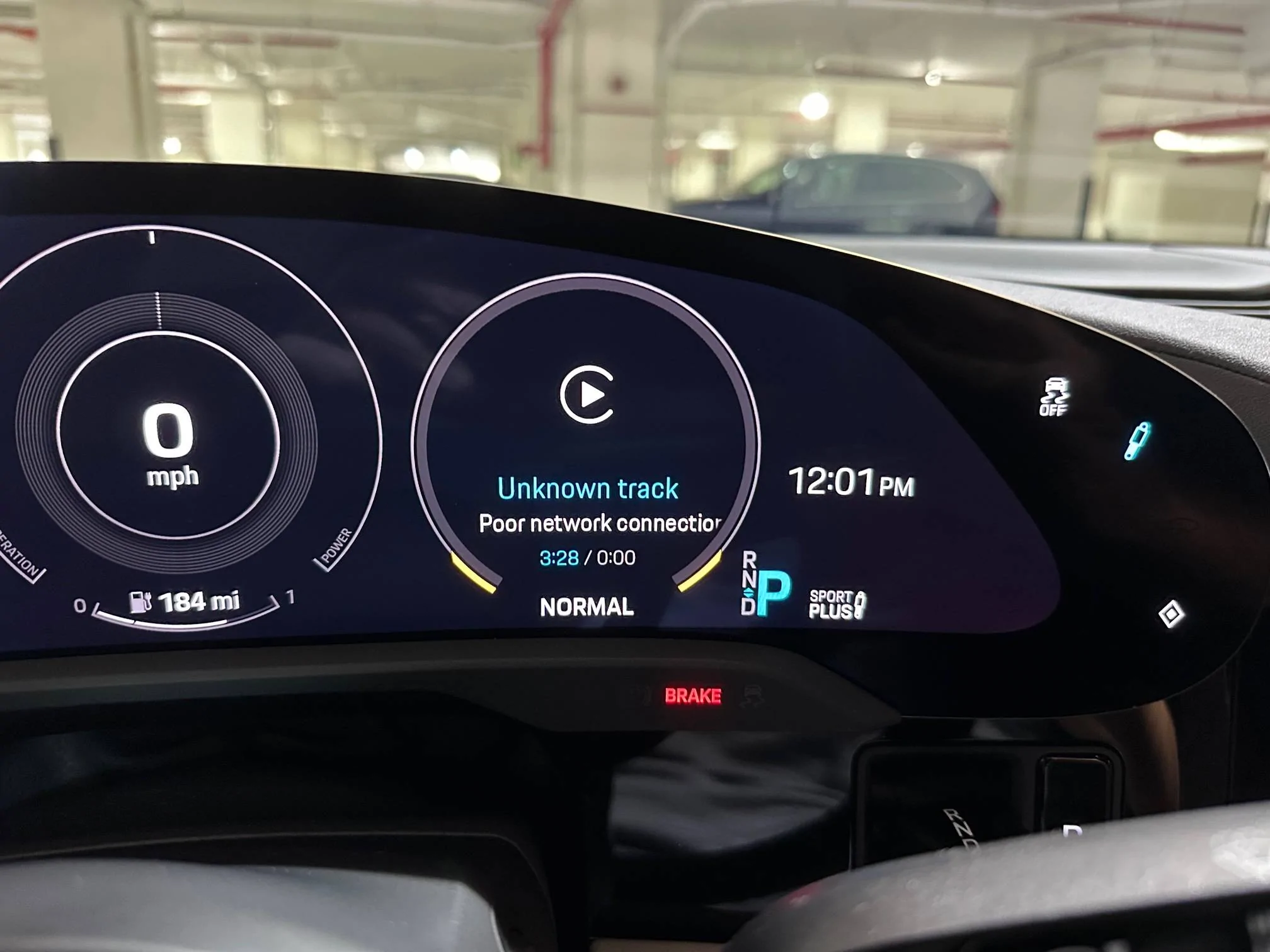

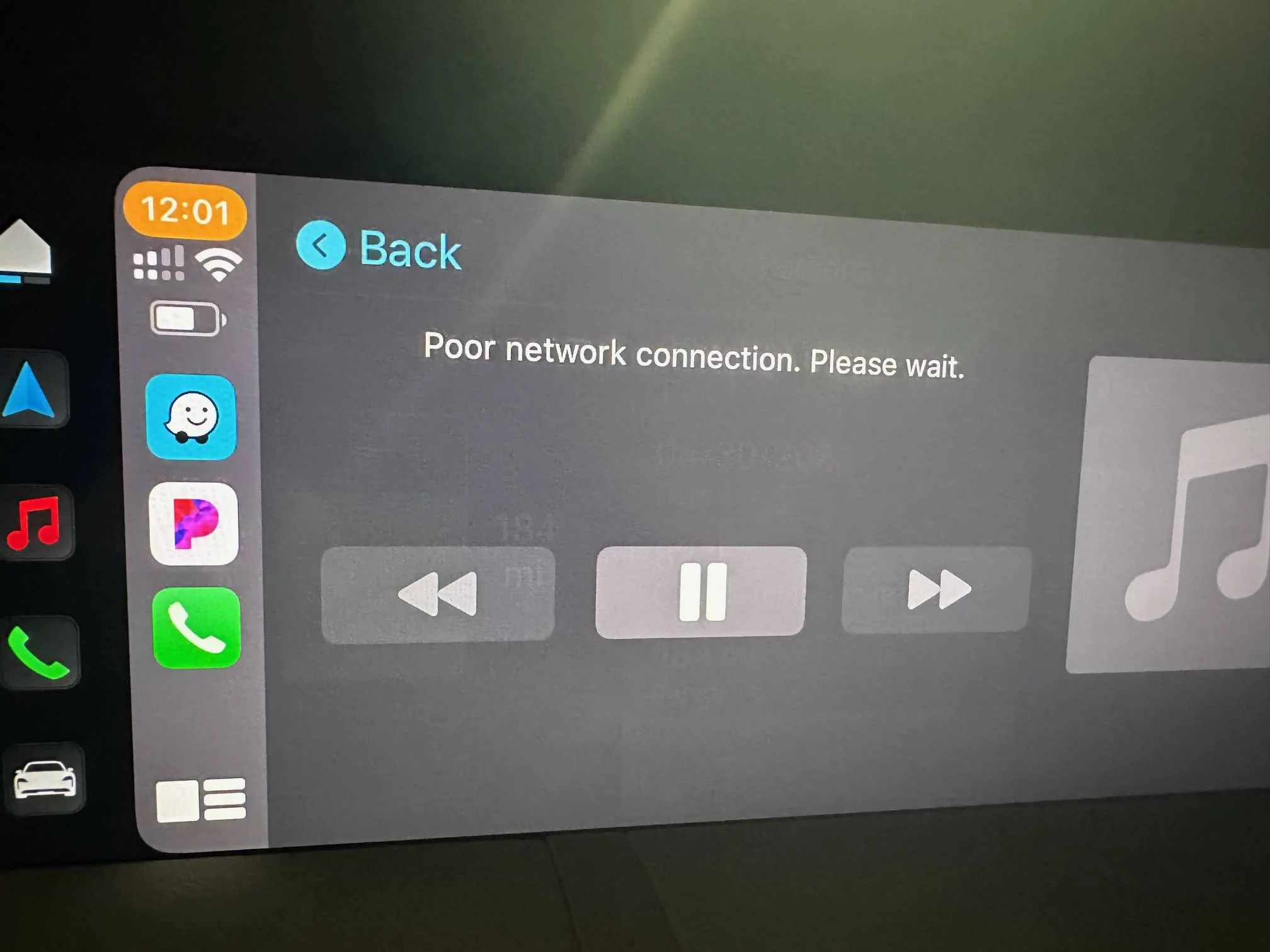

Thanks…I ran the test with Wi-Fi off…ATT is recognized. As far as the CarPlay screens, CarPlay is visible because when I start the car, I am able to connect to CarPlay because I’m still on the 5G, and the music, etc plays as it has for over a year. However, a few minutes later, Wi-Fi takes over and the screens lock up due to “poor connection” with the CarPlay interface still visible since I’m knocked off 5G. It doesn’t function, but it’s still visible. Here’s a few sample shots..
