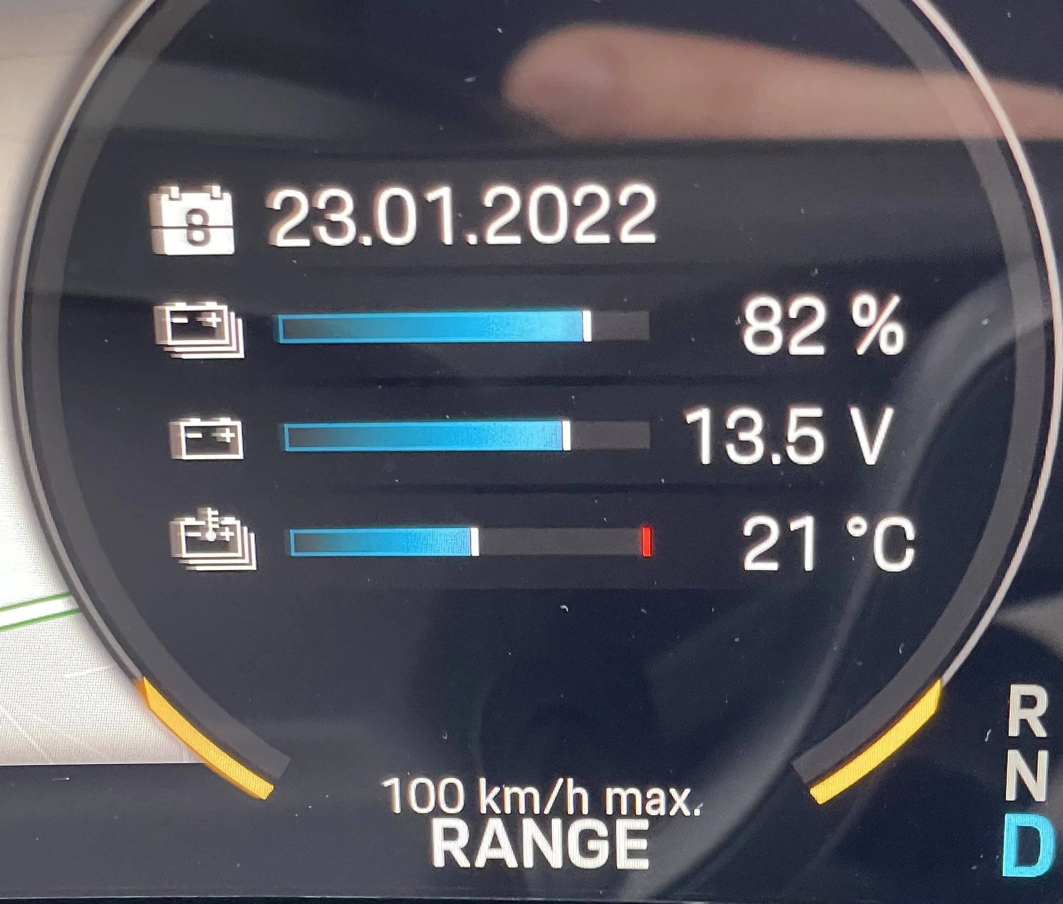

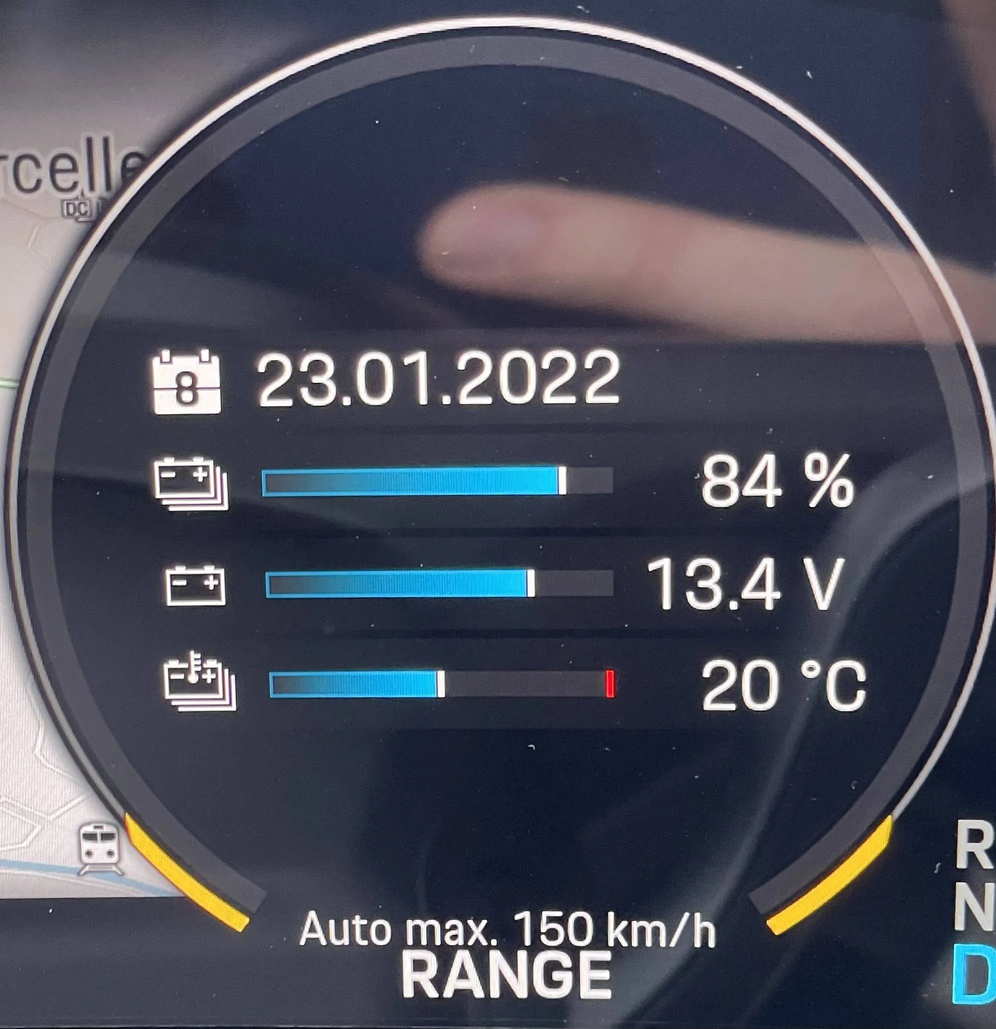

Hi, I realized today that in range mode, the max speed can be set(if the option is available) but it changes depending on the destination set in your nav system.
When I had no destination, the max speed was 100km/h as set in the option.
And when I set a destination easily reachable, the max speed changed to 150km/h even if it’s illegal unless i drive in Germany.

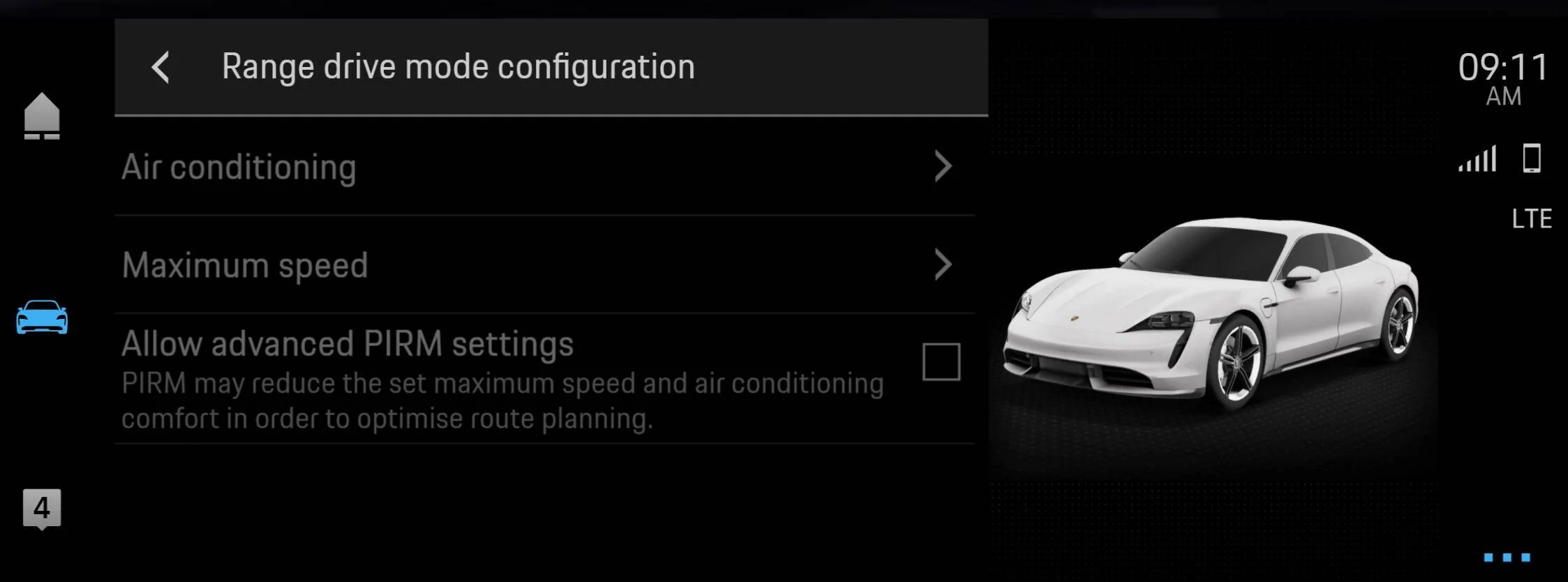

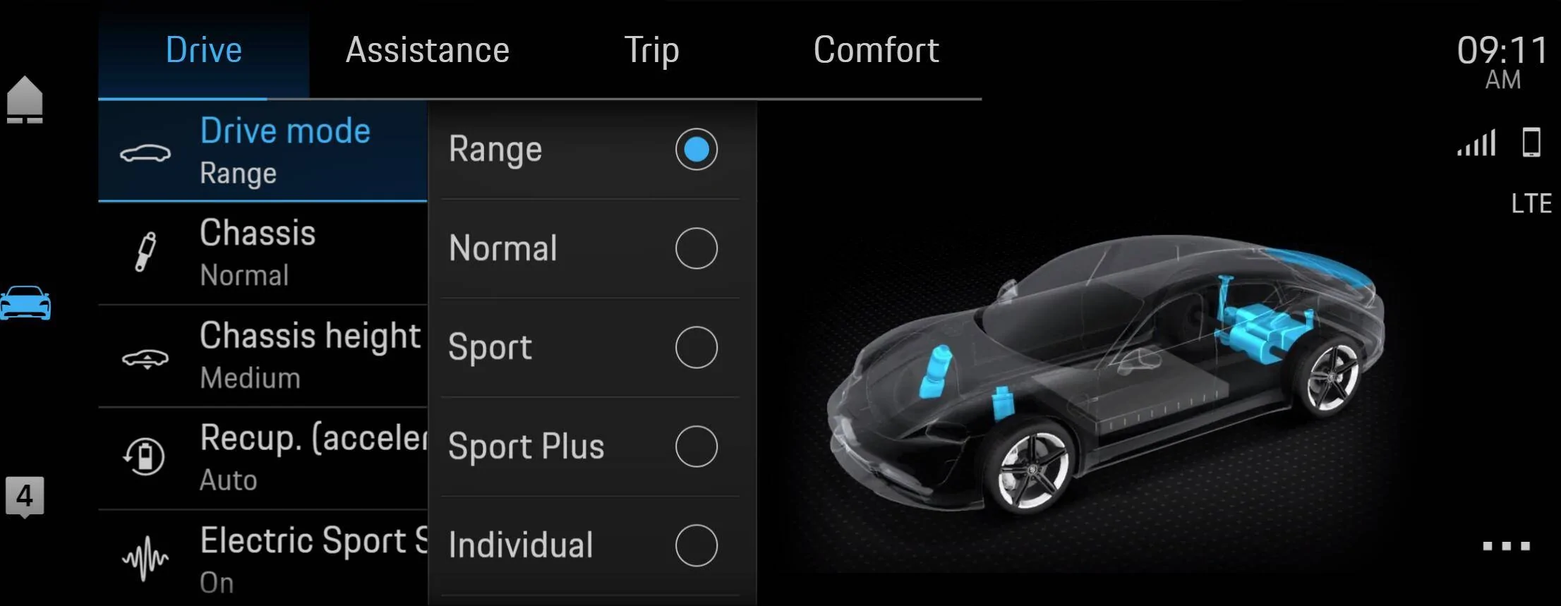

Hi, just picked up my 2022 $s a week ago, I do a weekly 200 mile highway drive and want to adjust the max speed for Range mode - on another thread it says to go to the Drive mode screen below then click on the three dots to the second screen below. However, after clicking on the three dots on the first screen I only see Options > Vehicle settings. The Range Mode Drive configuration screen is not accessible. Anyone know why I don't have this option or if there is another way to increase the max speed for Range mode?
Thanks!
Sam
I'm in the same boat, Sam, and I have had my CT4S for 3 months. Dealer says no longer possible though I am pursuing this. 2022 manual in app does not agree. We should obviously have the facility. What range mode speed do you have as default? Mine is 100kmph

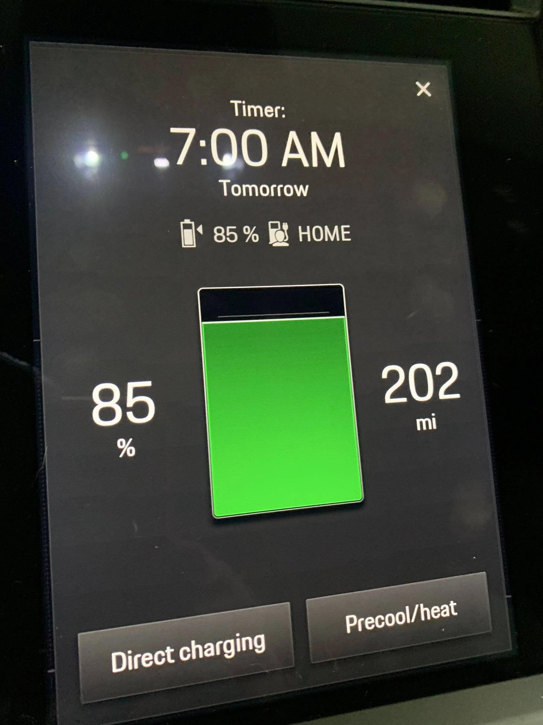

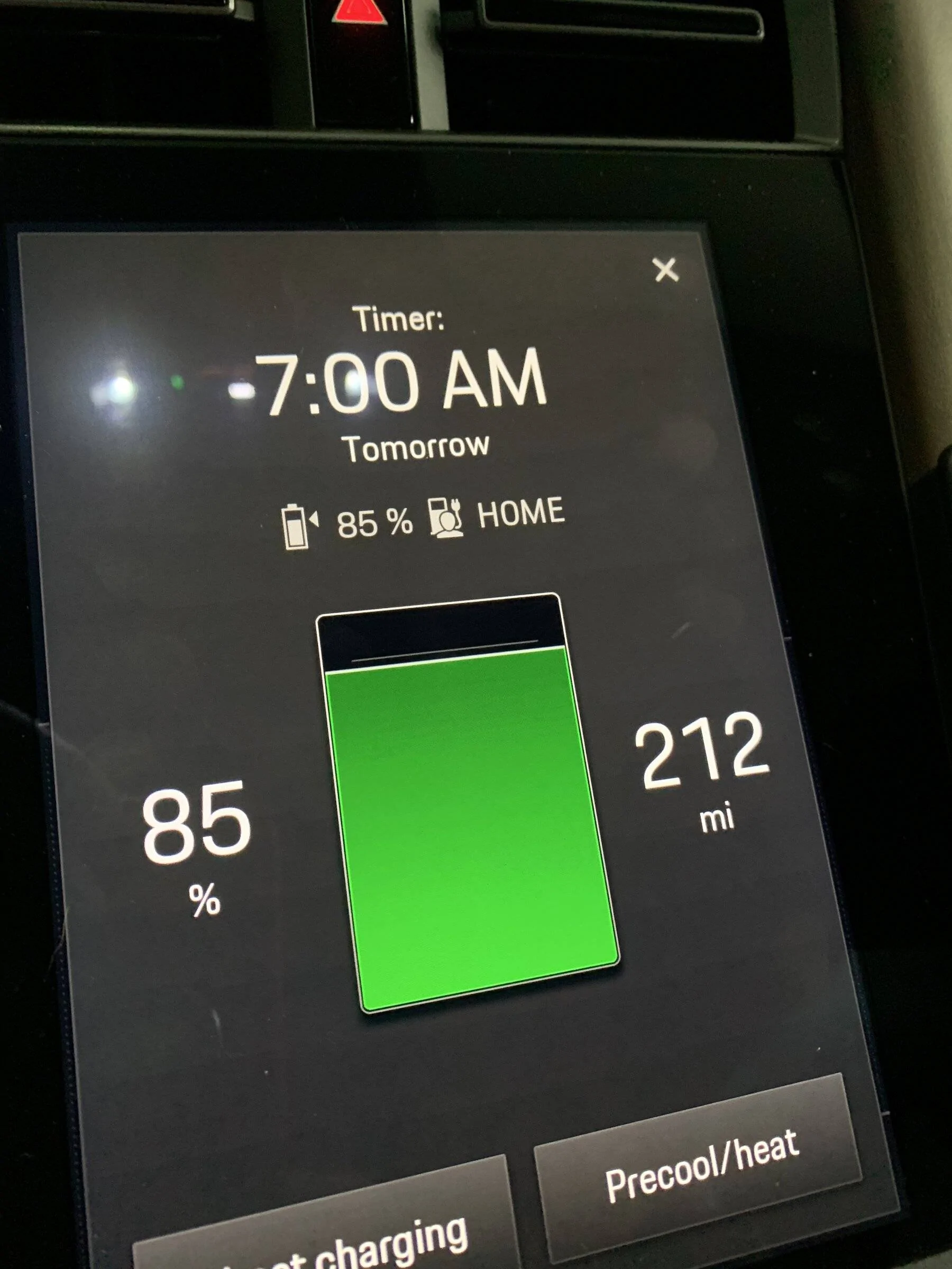

My comment re. Range Mode having a minimal effect on range was based on switching between Normal & Range Modes. From the photos you can see range in Normal was 202 miles and in Range was 212 miles. A 10 mile increase , or around 5% which I consider minimal.
My experience is, that it increases the range by at least 10%?! When you look at the distrubution of power, in range mode you drive a FWD, while in „normal“ it is RWD (when you don’t Need Full power). I assumed that increases the efficiency?!
202 miles in Normal Mode & 212 miles in Range Mode. 10 miles or 5% improvement, I consider that minimal.
