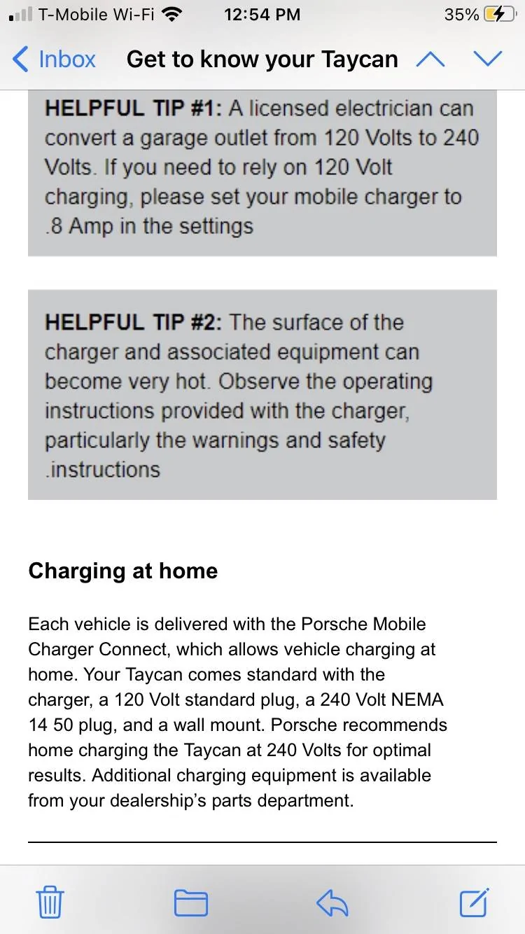

So I recently picked up my 4S and had an electrician install wiring to support up to NEMA 14-50. However when the car was ordered the SA selected NEMA 14-30. When charging I am getting really slow charging almost ~5kw/h. I just received a "Get to know your Taycan" email which says comes standard with a NEMA 14-50 plug. Should I probably go back to the SA and get a NEMA 14-50 plug? The NEMA 14-50 is not even an option online when ordering a new Taycan. Any help or insight is appreciated.

First if you have 14-30 plug I did not think that would even plug into a 14-50 socket so I am confused as to how you are getting any charging at all.
Second, I trust your NEMA 14-50 is at the end of a 50amp run from your junction box with the wiring appropriate for a 50 amp circuit.
If the second item is true then I would go back to my SA and tell them to get me the right plug for my unit.......

Socket is 14-30. I had the electrician do the wiring to support 14-50. I will go back to the SA and get the right plug. The electrician said he would just come back and replace the 14-30 with the 14-50 socket since the wiring is already done.

14-50 is ”standard” equipment which is why it’s not listed as an option - ask the SA to let you keep the 14-30 supply cable as a “thanks for playing due to our incompetence” prize - it’s a $150 supply cable and is useful while traveling sometimes should you need to charge your EV from a 14-30 plug away from home…

5kW is about right for “at the car” for a 14-30.
Electrician should be swapping out breakers between 14-30 and 14-50 also. Not just the receptacle.
It’s $115 for the 14-50 supply cable on suncoast. Should be about the same price through the dealership.

Thanks. This is all new to me so I am fine eating the 115 cost if that's what it is. I am not going to fight or blame the dealer for not knowing. I should have done my own homework as well.
