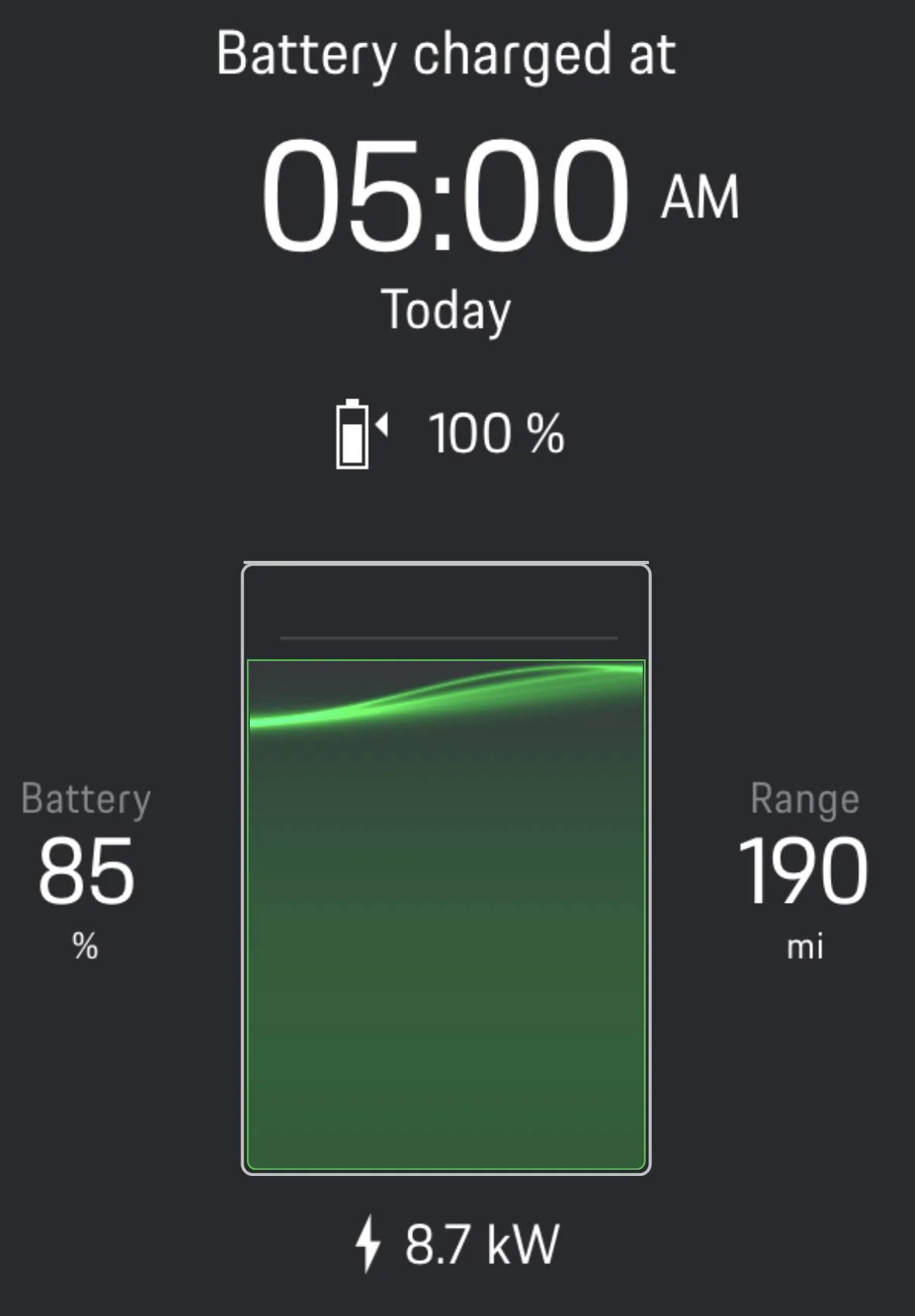

charging now - raw power from the grid/meter = 9.6’ish kW according to my home power meter
in vehicle charge rate shows 8.7 kW (due to charing overhead losses expected and normal in any AC/DC battery charging process and completely normal for all EV’s)
measured loss in this case is about 9.3% overhead in the charging process - completely inline with expectations and limitations of AC/DC conversion levels…
Porsche Taycan Home charging verrrry slowly 649CB51C-B7D3-4F45-8982-AC9B64216CC9

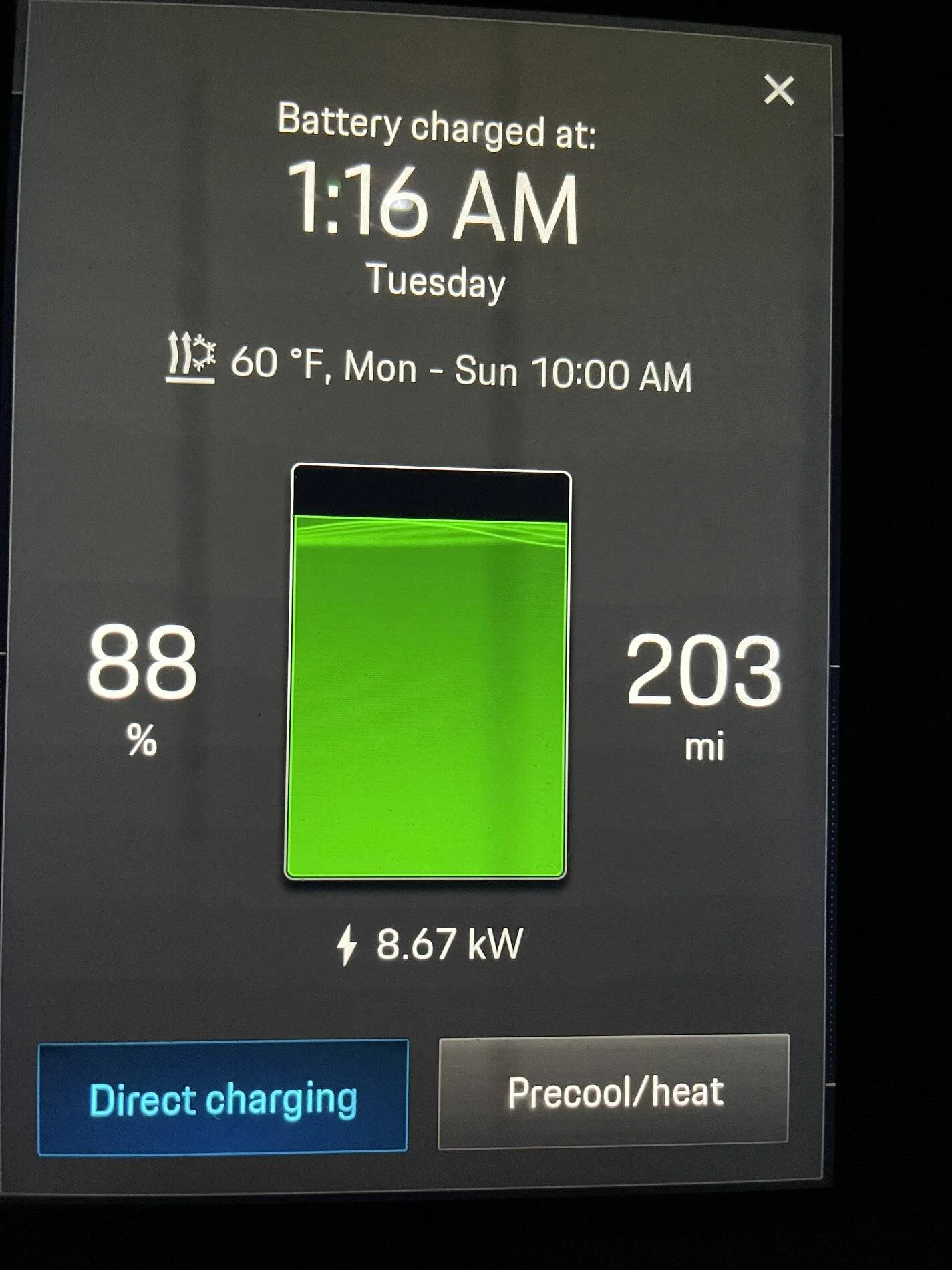

Just received my Chargepoint HomeFlex and hooked it up last night.
Porsche Taycan Home charging verrrry slowly IMG_6784

Damn man - 60 degrees! 8.67kw is good.
