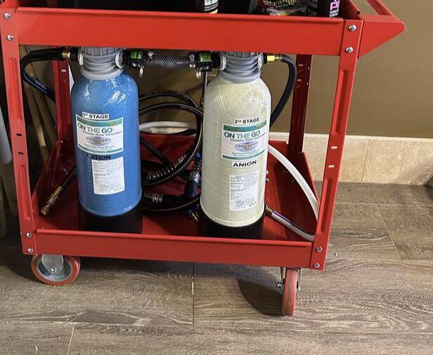

I have very hard water where I live, so I purchased a 2-stage deionizer system. I get no water spots.
Highly recommended for final rinse. No other chemicals are needed.
Agree with PPF, must have!
