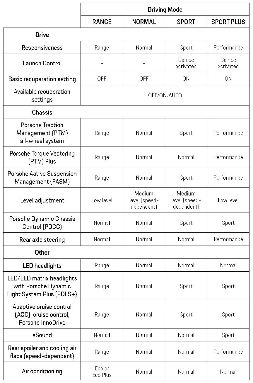

This may help.
Porsche Taycan How to associate suspension level with driving mode E32641E1-70A4-4E5C-AA06-33A316495006
When it says speed dependent it means in normal and sport mode it will go to lowered (edit) height when driving above 60mph or when the speed limit is 60+.
If you manually select a chassis height in normal and sport, it will stay at that height for both those modes.

Thanks. I am aware of the chart (I think it came from an old post of mine btw :) ), my confusion stemed from the fact that that once I manually set chassis to Low in Sport mode, I expected it to revert to “speed dependent “ when switching back to Normal mode, meaning regular height at low speed, but it stayed in Low.
By the way the solution in fact is to use Individual mode, when that is set to Low, switching back to Normal lifts if back to Regular height at low speeds.
