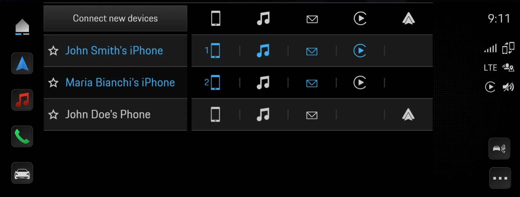

When you phone is connected to the PCM (Bluetooth / WiFi / both) it will automatically attempt to connect Carplay (or Android Auto on an Android device) and if not configured you could well end up in a pickle.
If you don't want Carplay then go to the devices menu on the PCM and de-select Carplay (symbol C>).
Some light reading below.
Better still go to your phones Settings then to General then to CarPlay and a submenu under that and toggle the button off - this way not available to the car/PCM.
