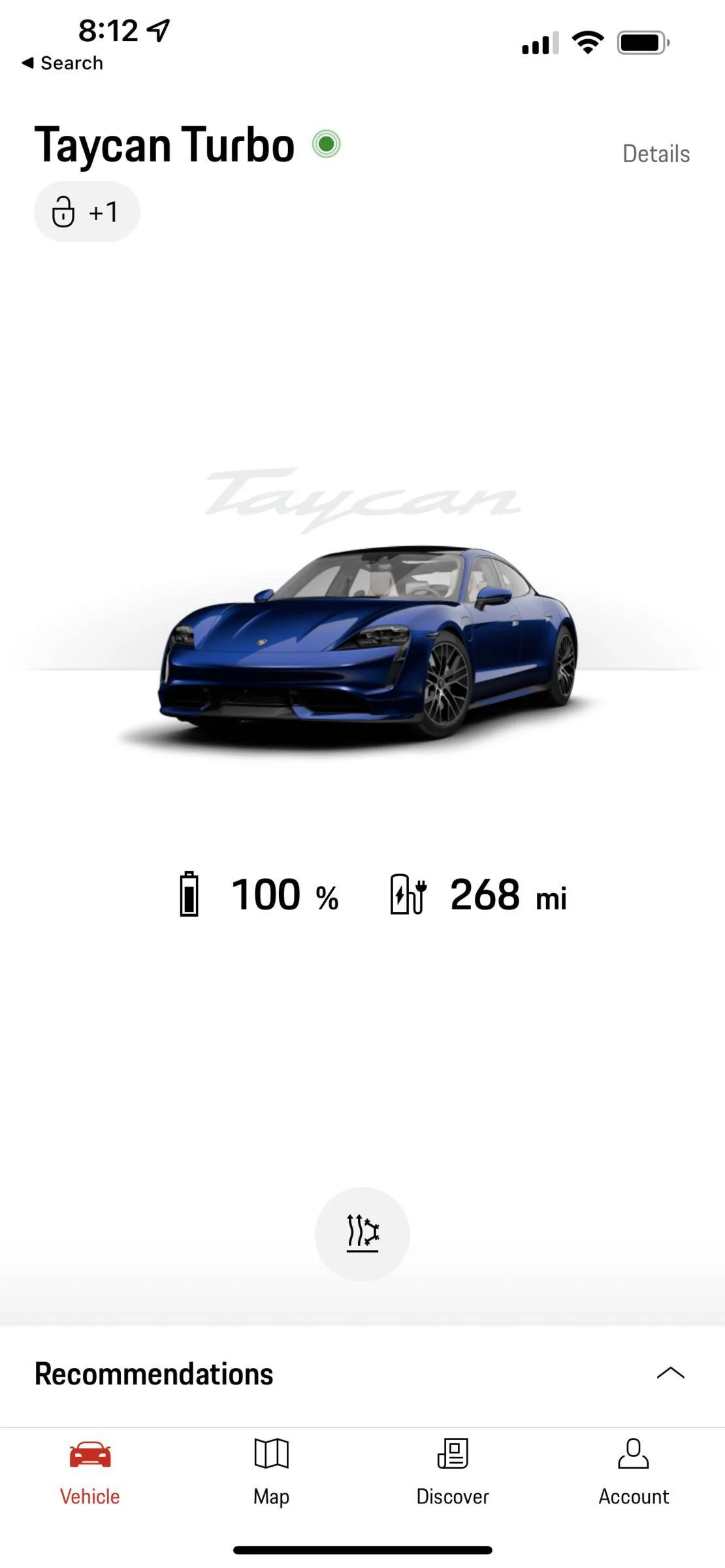

Yes, definitely exceeds official AND EPA range by far.
Even in cold weather conditions.

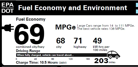

It bothers me that many insist on range as a measure of efficiency for BEVs. We don't measure ICE cars efficiency in range, we use MPG. KWH/100mi, MPGe, KWH/mi, etc are measures of efficiency.
The fuel economy portion of my Taycan's window sticker is below.
Over 6500 miles, my actual average consumption is 29.8 kWh/100mi, or 113 MPGe. Far exceeding the 49 kWh/100mi and 69 MPGe on the sicker.
That's very good. Looking at my ipace for the Year (lockdowns and only recently customers opening up for face to face) then for about 5k miles my average is 41.2kWh/100 miles. This month is getting cooler (it was 2C/35F for most of my journey yesterday) and my last 750 miles was up to 44.5kWh/100 miles with the first leg being over 50 giving me a winter range of about 160 and a summer of about 200 when driven comparably. I'd note the majority of my journeys are motorway, at averages of 65-70mph with some decent elevation changes. I normally drive the car to enjoy and range saving tends to be forced (traffic/average speed checks).

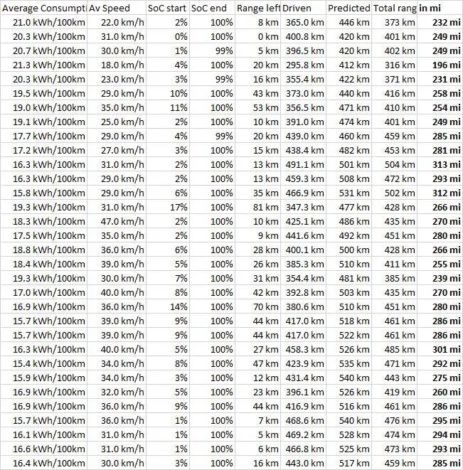

Depends on driving style, location, climate. It never gets really cold here. The numbers in mi are driven+range left at low SoC.

Depends on driving style, location, climate. I never gets really cold here. The numbers in mi are driven+range left at los SoC.
wow I envy your consumption figures. I have never seen anything like it here. Not even during the summer months when it can be around 30 C. I do not think I have seen anything below 20 kWh/ 100 km? And the average speed figures have been about the same.
what is your average temperature. It must ne quite warm all year around.

I really got used to the driving style of using the pedal as little as possible. I sometimes really hit it, but the acceleration is so enormous it lasts never more than 2 sec. I try to avoid breaking before turns, enjoying the Porsche handling. I now find it hard for my driving needs to get the consumption above 20 kWh/100km.
Average temp here is between 17°C and 30°C.

How did you produce this table? Was it via an app or manually?
