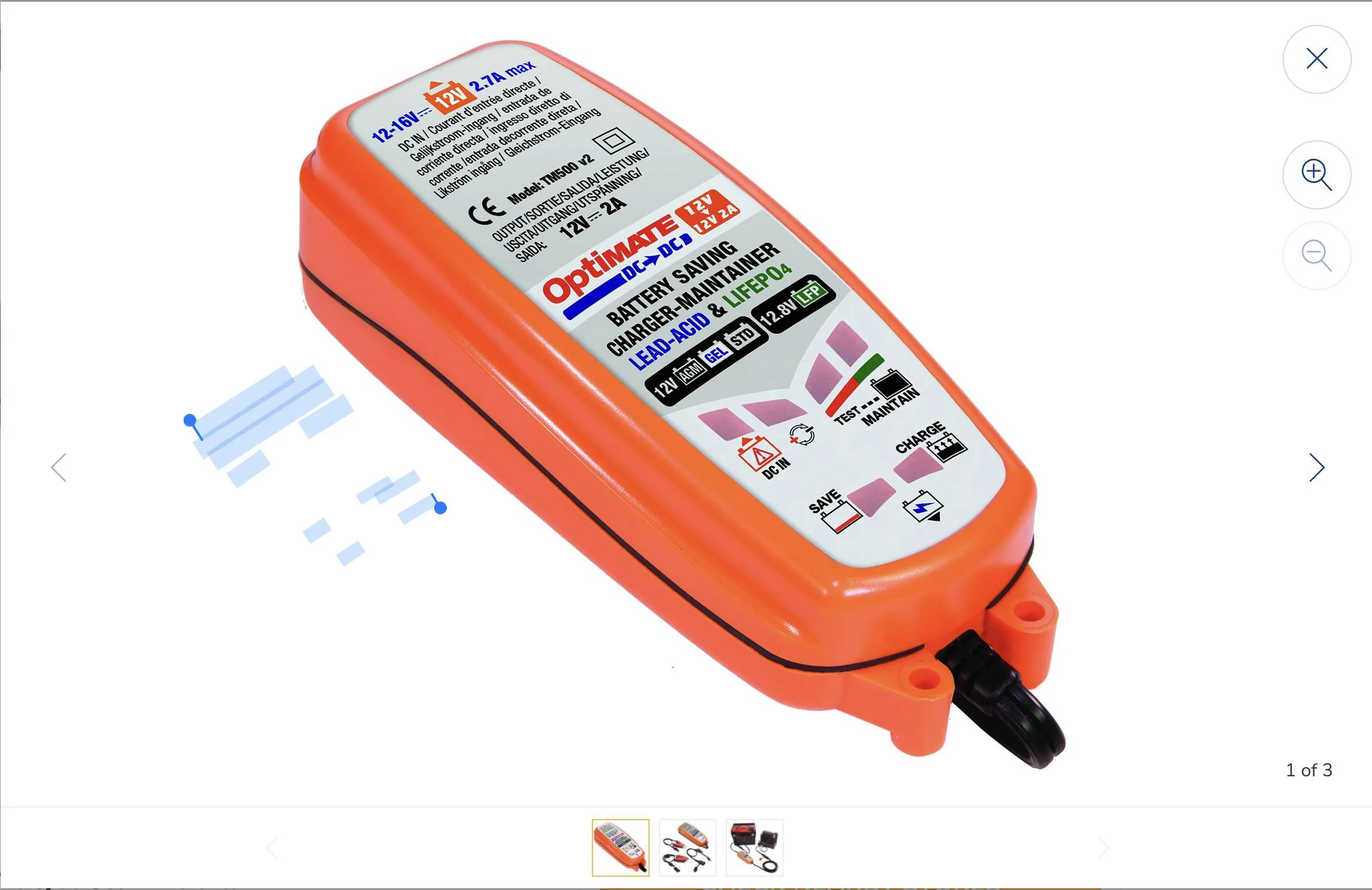

Once again, you're not jump starting the EV. Unlike an ICE car, there is no starter motor or alternator which you need to power. Instead with an EV. you're providing 12v power to the electronics so that the car will wake up. Once the car is back up, the car will take care of properly charging the 12v Li battery.
If the use of this device makes you uncomfortable, don't use it. Instead get a 12v lead acid battery to kick start your EV in the case of a problem. That's what the AAA trucks use.
https://www.amazon.com/Tecmate-Opti...cphy=1024543&hvtargid=pla-1090238818523&psc=1
I use one of these. 6ah Milwaukee battery to open the front trunk, and switch to this for potential dead battery. Also have an m12 compressor for flats.
Porsche Taycan Locked out - another 12v saga c3920bfe-247e-4e6d-a175-07fba86f112b-jpeg
