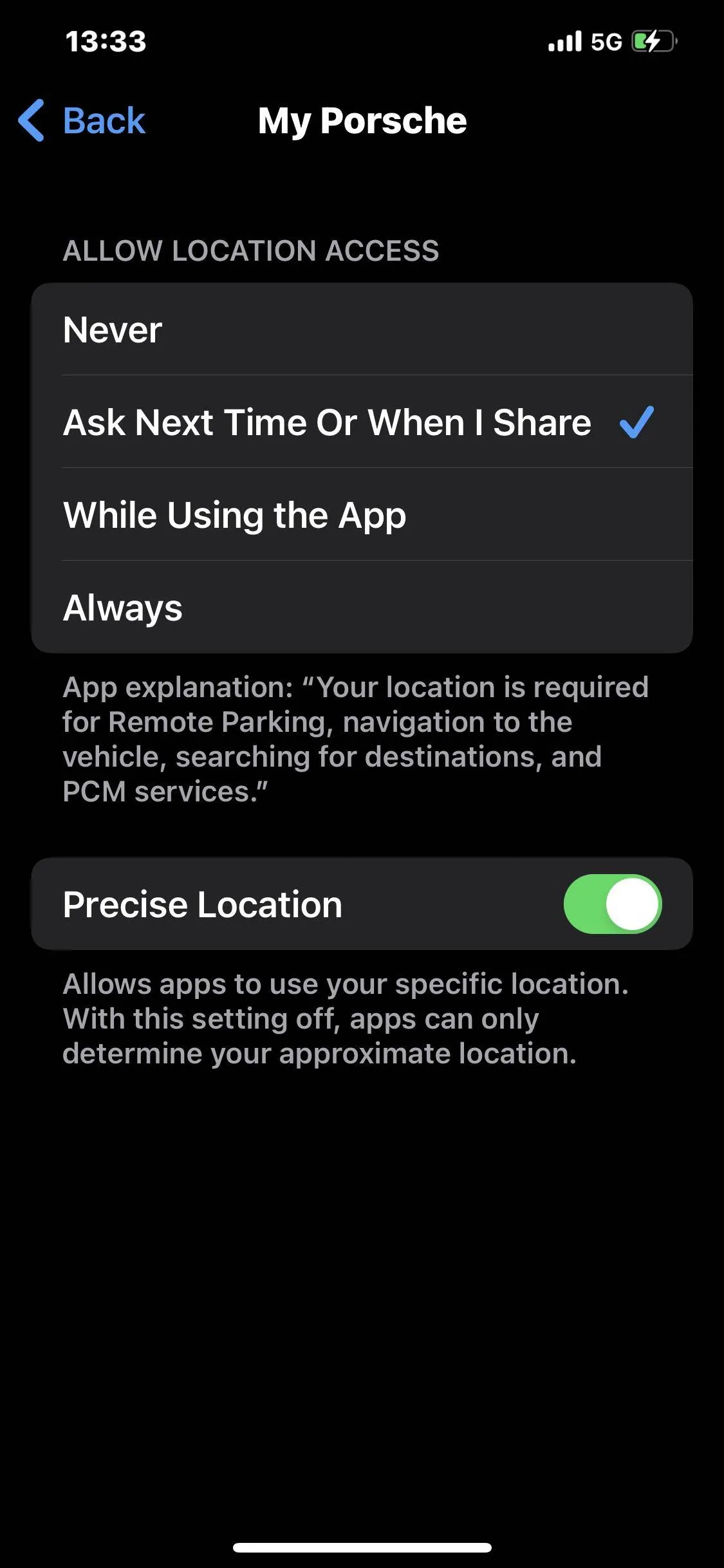

MTGBUK
Apr 4, 2021
145
116
Audi SQ7, Turbo S CT (Received :)
People using iPhones should also turn off location access when car is not in regular use. Occasionally I get a pop up on my phone saying “Myporsche has accessed your location X times in X days”. I think default is always on.
Porsche Taycan Locked out - another 12v saga 7D561150-80EC-4EFE-B773-F1A0013C43C1
