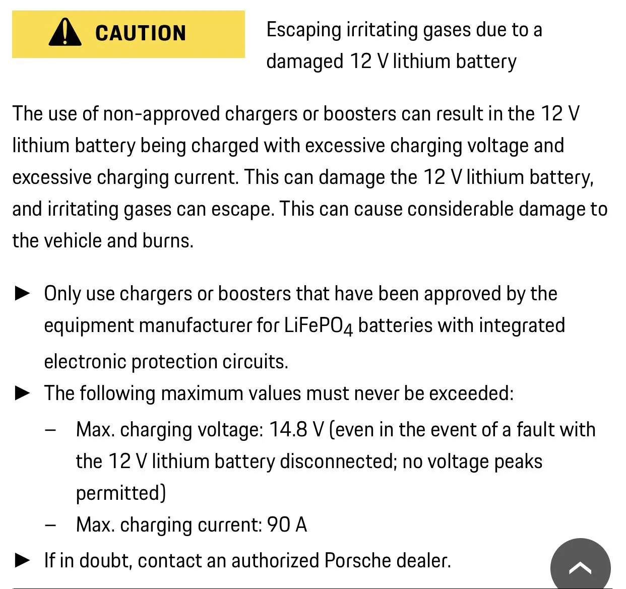

The Good to Know app suggests you need a booster that works with a LiFePO4 battery. I can’t seem to find one easily. My previous Genius one isn’t recommended. Here is the screenshot from the app:

My previous post was based on this wording from the owner's manual P. 285 on jumping 12 V battery:
General Safety Notices
The 12-volt lithium battery is automatically disconnected
from the vehicle electrical system if the battery
charge condition is low. When the 12 V lithium
battery is discharged, it is impossible to operate the
vehicle. The electrical system is deactivated
temporarily.
-Pay attention to the warning.
Charging the 12 V lithium battery:
-Establishing operational readiness.
-Please see chapter "Starting, driving and
stopping the vehicle" on page 231.
– or –
-Charging the 12 V battery using the charger.
– or –
-Feed electricity in from another vehicle for at
least 5 minutes.
Then establish operational readiness or charge
After establishing operational readiness, charge the
12 V lithium battery with a charger (for at least 10
minutes) or feeding in electricity from an external
source, the electrical system will be automatically
reactivated. The 12-volt lithium battery is automatically
connected to the vehicle electrical supply
again.
Using a jumper cable, the battery of another vehicle
can be used to feed electricity into the vehicle. Both
batteries must have a nominal voltage level of 12
volts. The capacity (Ah) of the donor battery must
not be substantially less than that of the flat battery.
The discharged 12 V lithium battery must be connected
properly to the vehicle electrical system.
The need to repeatedly feed in electricity from an
external source or charge the 12 V lithium battery
under normal operating conditions may indicate that
the 12 V lithium battery is damaged.
-Never attach jumper cables or a charger directly
to the 12 V lithium battery.
