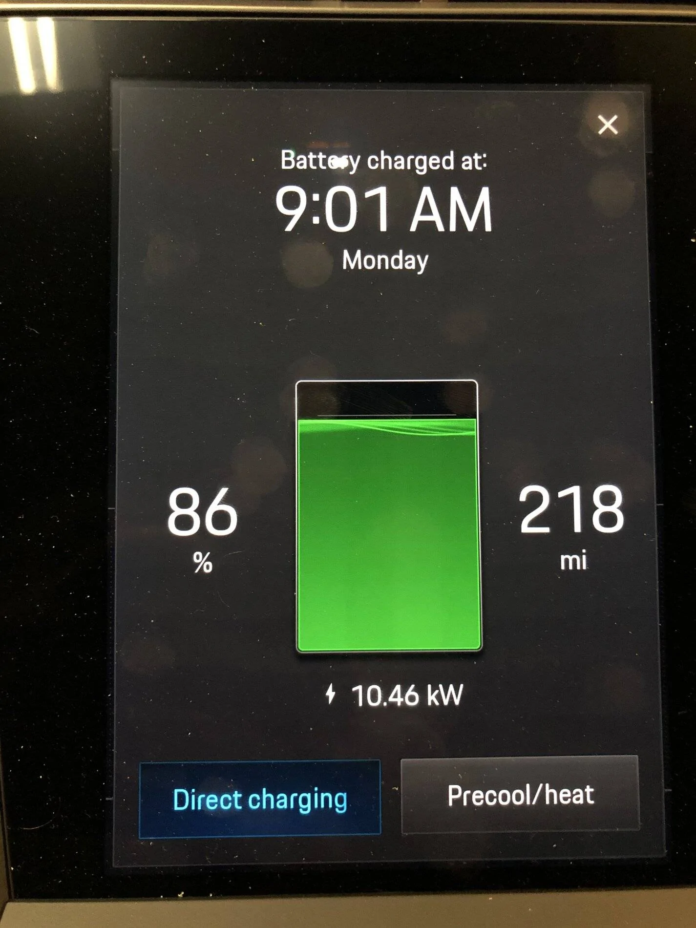

here is the screen shot of my 2020 Taycan charging from my 100/80 amp Tesla chargers - note the 10.xx kW charge rate (more than 9.6 kW)
it’s charging at 48 amps (60 amp breaker)

another interesting fact if if you plug into 9.6 kW the time estimate comes up and shows will be done at hh:mm
if you plug into 11 kw charger the time estimate will come up and shows it will be done at hh:mm - and the hh:mm is always sooner for 11 kW vs. 9.6 kw
we have two pieces of data from Porsche OWN software that demontrate the vehicle charges faster on an 11 kW charger - it shows larger charge rate (10.46 kw) and it estimates the charge will be done sooner - so this is not an illusion - again this is with Porsche‘s own in car software.

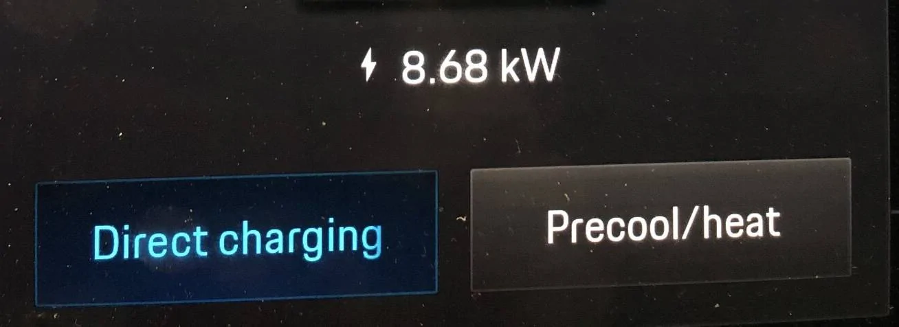

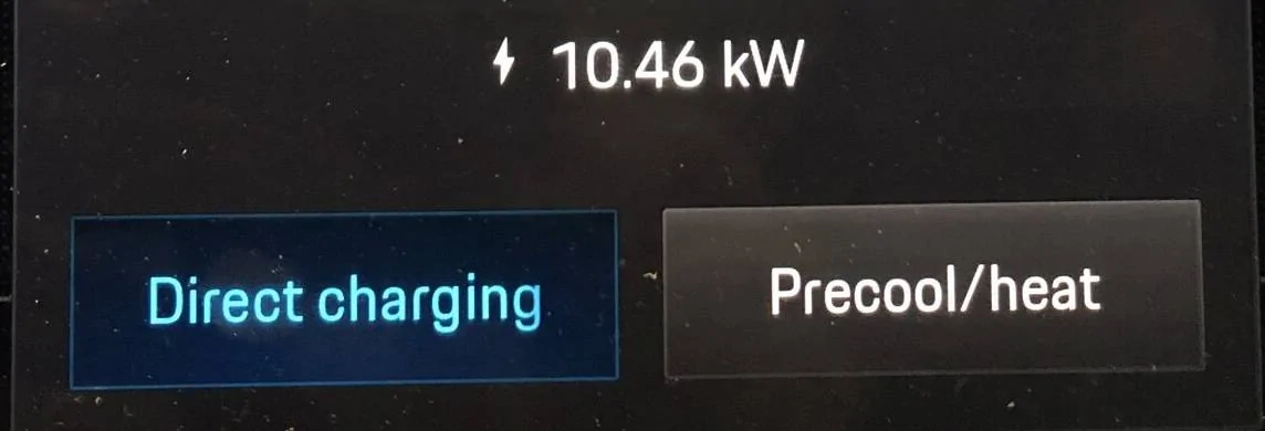

if the Porsche charger is not an 11 kW charger then someone needs to explain the following two screen shots to me:
here is the charge rate reported by the Porsche in-car software when using the Porsche supplied PMCC 9.6 kw charger plugged into a NEMA 14-50 plug w/50 amp breaker and 50 amp rated wire - 40 amp charge rate (9.6 kW)
Porsche Taycan Malfunctioning Charge Port F8AF03D9-B0CC-495C-9275-410421B3305A
and here is the charge rate reported by the same vehicle 2020 Taycan Turbo Porsche in-car software when using a non Porsche EVSE on a 60 amp or greater EVSE (in my case a 100/80 amp TEsla Gen2 Charger)
Porsche Taycan Malfunctioning Charge Port FFF9F954-2622-4C6E-85CC-1A11FE9102F2
please note the value above is greater than the documented 9.6 kW charge rate Porsche says is the maximum charge rate - so we immediately have a factual and reproducible result that contradicts Porsche’s own specifications (no one would complain that the 0-60 acceleration is better in real life than the spec, why so hard to believe they are actually shipping a 11 kw charger)
and the spirit of peer-reviewed research - these results are repeatable and have been confirmed by other owners - so this is not unique to my situation.
I await any factual actual charging results that differ - other than assertions by:
  • dealers/porsche service rep’s that are universally clueless and barely understand the product they are supporting
  • other venodrs that don’t want to open themselves up to misrepresentation claims for a product they do not control
