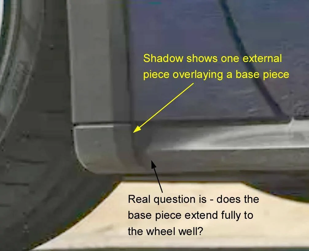

Good idea but, my concern is how the arches meet the lower molding.
Yes indeed I too was looking at that but if you look closely at the pic you shared there are separate molding pieces that appear to overlay the baseboard/sill molding - looks again like a CT piece was adhered to the std base sill extension?
And remember - the original thread is about painting or replacing the plastic surrounds - this option to simply remove and recover the paint would be awesome if it works but perhaps sill a bit of a long shot.

Nice find! What I just saw had the off-road package so not the same treatment.

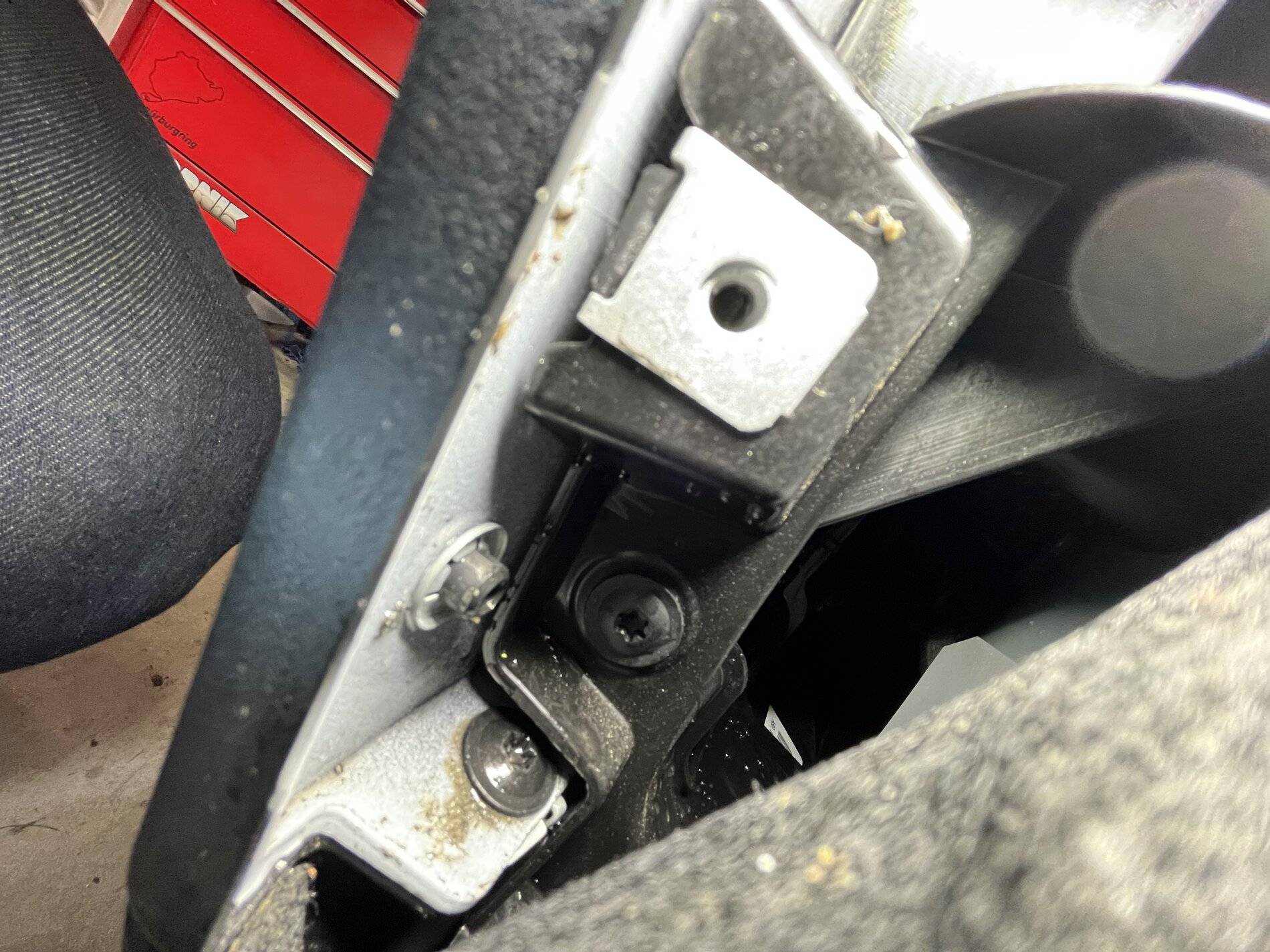

There are holes for clips in the front and rear bumpers for the arches, about half inch in diameter just above the lower black trim line. Other than one clip per corner of the car they appear stuck on.
Front:

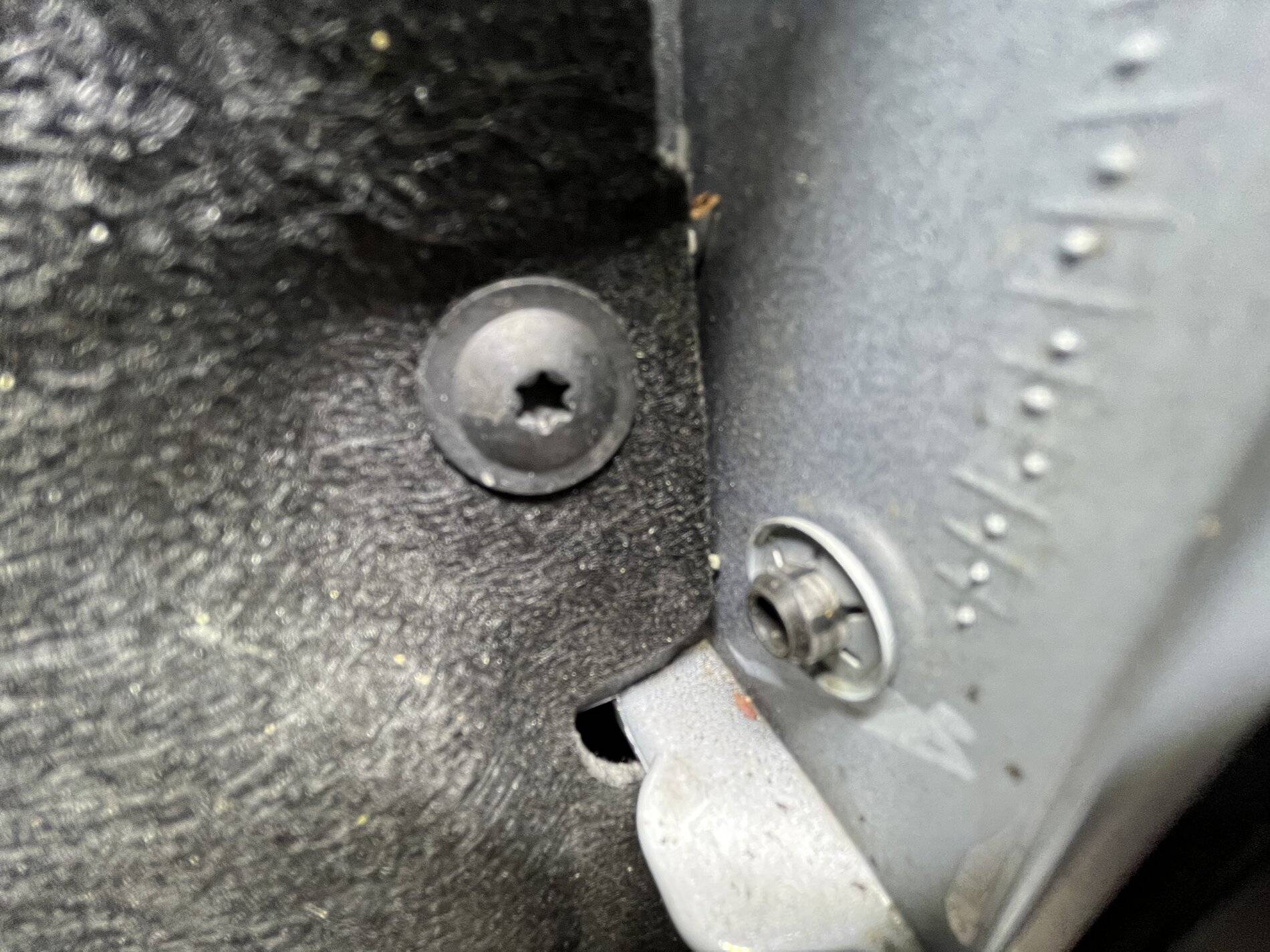

rear:

Can confirm the are attached by 3M-like removable adhesive tape - easily removed with help of heat gun (great care!) etc. - a Belgian forum user posted the info on separate related thread (he was one if not the first to have them painted along with side skirts and front/rear facia) - the issue with removing them however has more to do with how they link to the side skirts etc. i.e. there would be a hole/gap - if I find the other thread I'll update this - all discussed there ...
