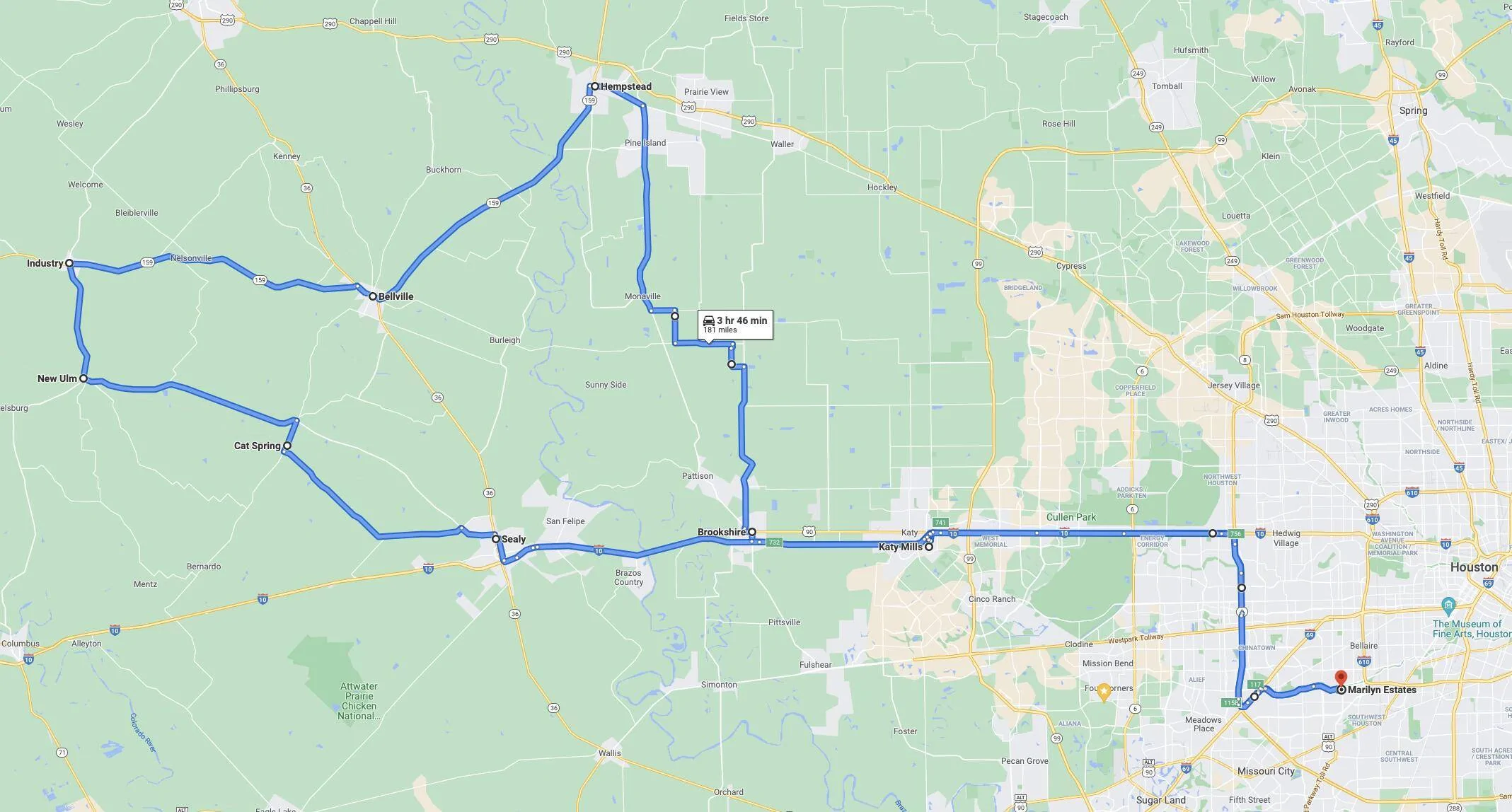

Decided to do a quick tour/roundtrip out of Houston via Hempstead, Bellville and Sealy (closest thing to 'hilly' terrain we have nearby Houston) to test what I would refer to as a real world consumptive test without resorting to the constrictions imposed by Range Mode (I'm not adverse to using Range Mode but wanted to see what I can get w/o having to use it).

Trip Details:
Minor roadwork re-directions locally made total trip 183 vs the Google distance of 181 miles.

So after 153 miles of driving
we arrived at the the only planned (and Porsche Charging Planner suggested) charging station in Katy Mills with a prediction of 73 miles of range remaining. 153+73 = ca 226 range very close to a pre-trip prediction of 234 but still higher than actual consumptive range of 223 miles for 100% SoC (183/.82 i.e. for total trip I used 82% batt. for 183 mies).
