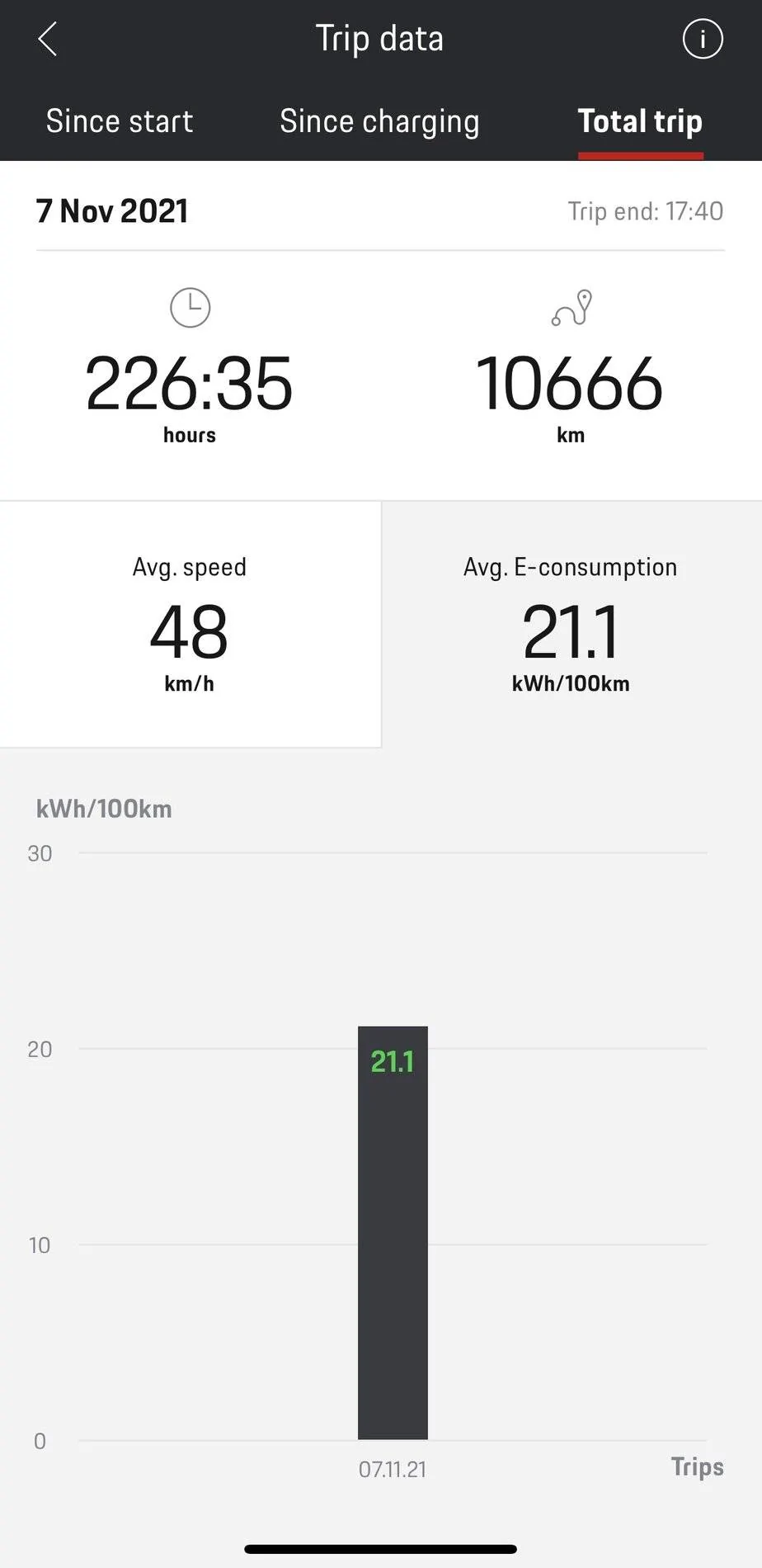

CT4: Got up to 450km (280m) in the Summer Highway driving in the dry on 20” wheels. Now temps have dropped (significantly here in CH) reckon closer to 370km (230m) on the Winter tyres.
This is what the average consumption is showing after 10000km which would average out at 400km (250m) per full charge

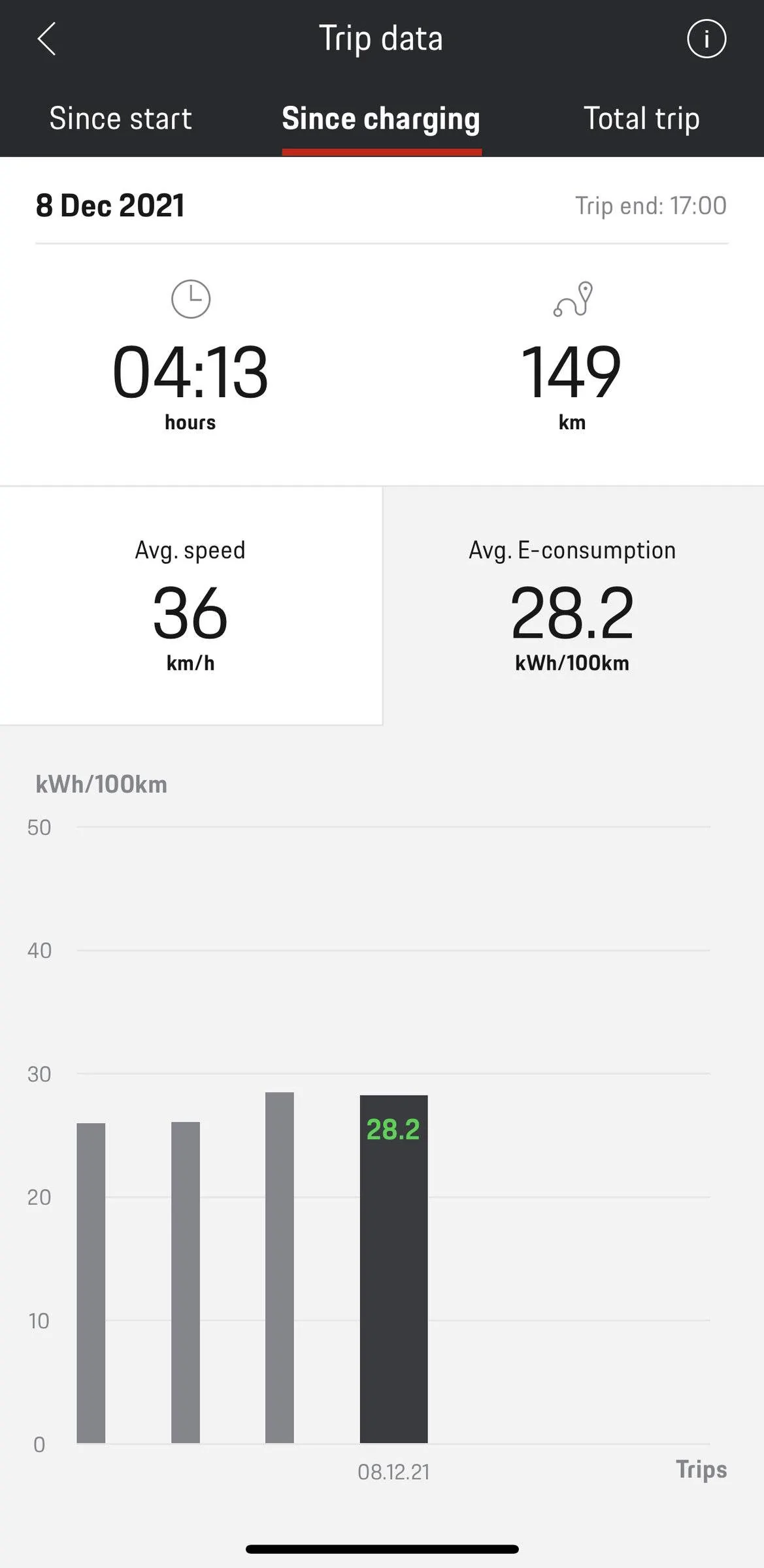

Range right down last few days doing mainly short local trips in winters conditions

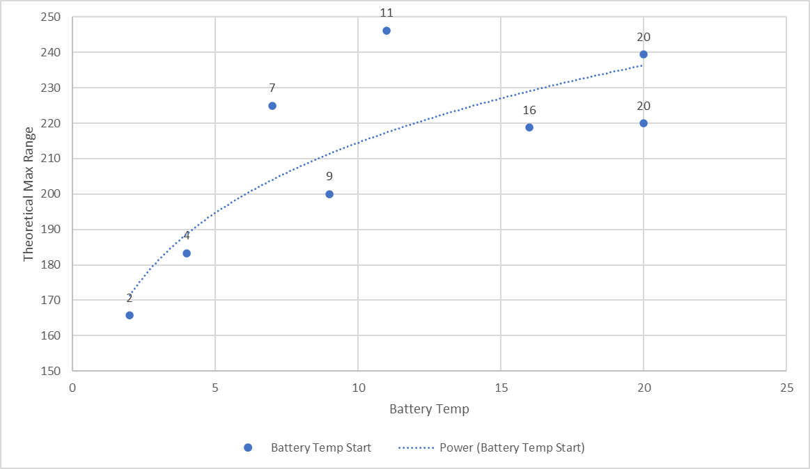

Hi All, I was sceptical on what the trip computer was saying so I did my own tests which worked like this. At start of a journey I recorded from the car: mileage on odometer, estimated range (miles), % charge of battery, battery temperature, outside air temperature. At the end of the journey I did the same.
From this data I calculated: the actual distance travelled from odometer, the reduction in the range and the kWh consumed covering the journey. To calculate the kWh consumed I calculated the drop in battery % and multiplied that by 83.7 kWh which is the maximum net usable battery capacity figure provided by Porsche (approx 10% less than the 93.4 kWh figure they state on all marketing info). Dividing the kWh consumed in the journey by the actual distance covered gives the kWh/mile "consumption" metric that Porsche use in their trip computer - but they rarely correlated, with the trip computer being more pessimistic than my calcs.
Then I calculated the maximum range the car would theoretically achieve if the journey continued in the same conditions with the the calculated consumption figure. I discounted all short journeys as they were very sensitive to rounding errors in the calcs.

Or graphically
Porsche Taycan CT real world range 1645358642469
Conclusions: battery temperature has a huge impact on range. I showed the data to a Porsche lead technician during my Taycan masterclass session and he concurred this is what he would expect. He also that in summer I could expect range to go up to 290 miles simply due the battery being closer to optimal operating temperature. So, pre-heating, if you didn't already know is key to getting the range.
For info: 21 inch wheels, ECO mode on climate control, heated seats generally on (setting 1) for 1 person. Porsche technician said all these do have an effect but minor relative to the energy consumed in heating the battery up to temp.
Hope that helps!
