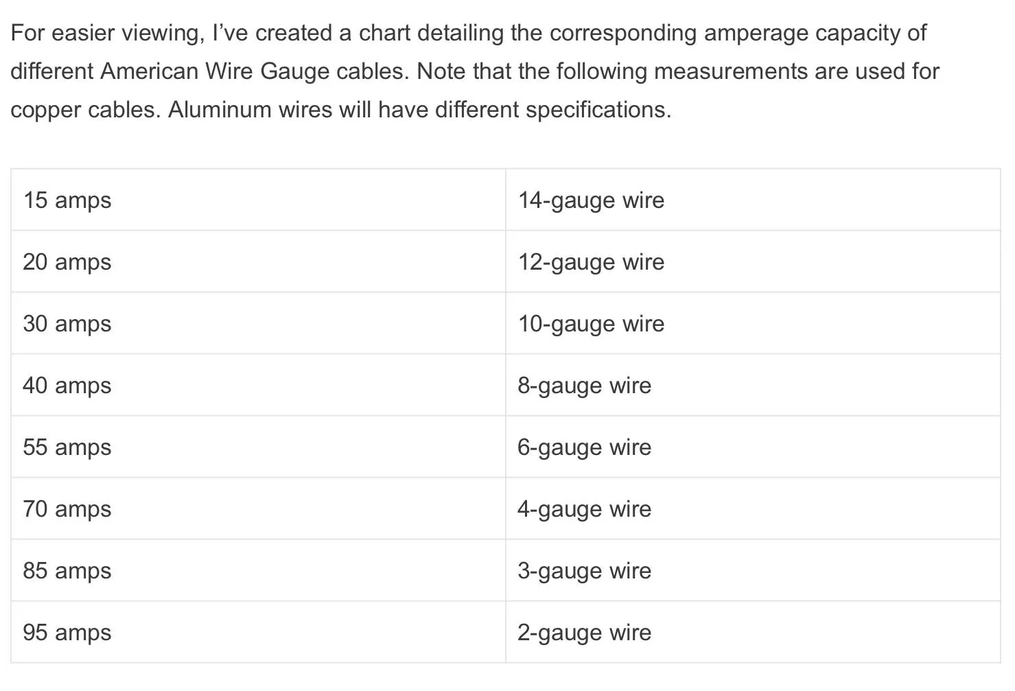

Bottom line: when installing a 14-50 receptacle, have your electrician run 4 wires: two hots, one neutral and one ground. The electrician will know what kind of wires to run. When I did my house 5 years ago, I ran 8 gauge THHN in conduit to a 14-50 receptacle. I have a 50 amp breaker protecting the wire and run my Juicebox EVSE at 32 amps (though I could go to 40 amps with the wire size and breaker).
If I were to do it over today, since I have 2 EVs, I would have run 6 gauge THHN in conduit which would support 60 amp charging. Since this is over 50 amps (the limit of a 14-50 receptacle ) I would need to replace the receptacle with a hard wired connection (junction box). But 95% of the work is running the wires through conduit and you don’t want to be like me: regretting the wires I ran.
Yep essentially what I did back in Sept 2021 i.e. had electrician run the 4 wires (used 6 THHN) and have my ChargePoint HomeFlex hard wired to a 60A breaker (only abt. 10 ft from the panel) - getting full 11kW out and consistently get 10.5kW to the car - very happy with this setup and really appreciate the extra speed - also have an additional 14-50 (50A breaker) plug in the next bay available, which for now, is a backup but in near future will hopefully accommodate the next gen Mini Electric. I got my HomeFlex for a little over $700 but then got 30% back in tax relief in 2021 (for both this unit and the installation costs) - a real bargain - was a bit blown away to see this same unit just now on Amazon for sale at $974 for the 14-50 versions - wow!

In my case the main panel was in my basement on the wrong side of the house and I needed to run 60’ of wire through 3/4” conduit. Plus there was a brick outside wall I needed to drill a hole through for the conduit. Not easy. That’s why it took three weekends. But I love the idea of a tandem charger.
