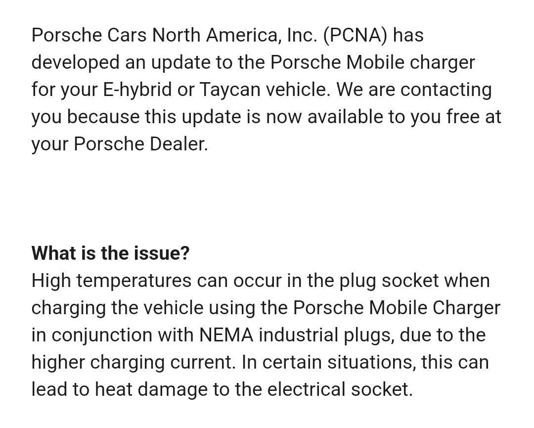

Official from Porsche:
Porsche Taycan NEMA 14-50 plug is dangerously hot!! Screenshot_20221013_170223
This is exactly the problem - a defective plug. I got a J+ Booster charger and it's cool as a cucumber.
