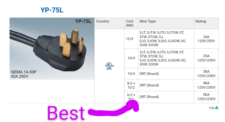

I looked up the specs on the wire and came across whip ratings from the manufacture of my cable. http://www.yung-li.com.tw/EN/Products/heavyduty_nema.htm
The 4-50P whip with 10 AWG wire is rated to 30A 125V/250V. Not sure this exactly the same cable used but is probably close. Maybe the short run of the whip allows more amps?

Thanks, Toby. I think I already have that plug/cable. I'm searching for the correct 14-50 supply cable that's rated for a 50 amp circuit, not 30A as Bill expertly reported here as the cause of many of us with abnormally hot supply cables.
