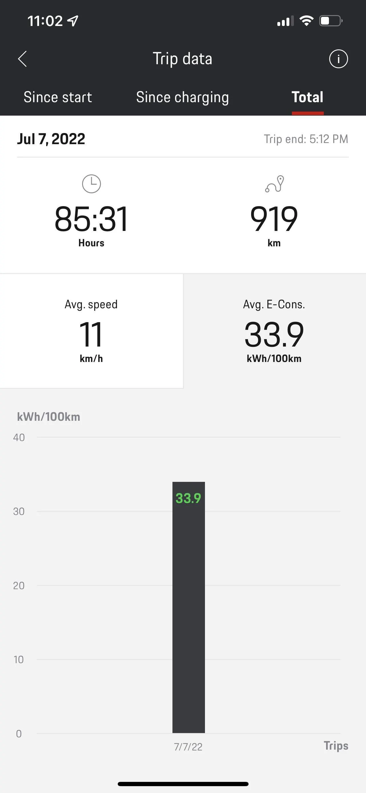

Thx - so this works out at 1.83 miles which is high consumption. Given your average speed this makes some sense. On a longer journey you should expect 2.6 miles or higher (depending on various things).
Like I said! This Taycan is a bumper-to-bumper:cool: traffic machine. If it's not in traffic, it's being cut off by Tesla's.

Only time at sub 30 KMh per 100km is on high ways. 11km/hr average speed ha! This car kills it in peak hour traffic.

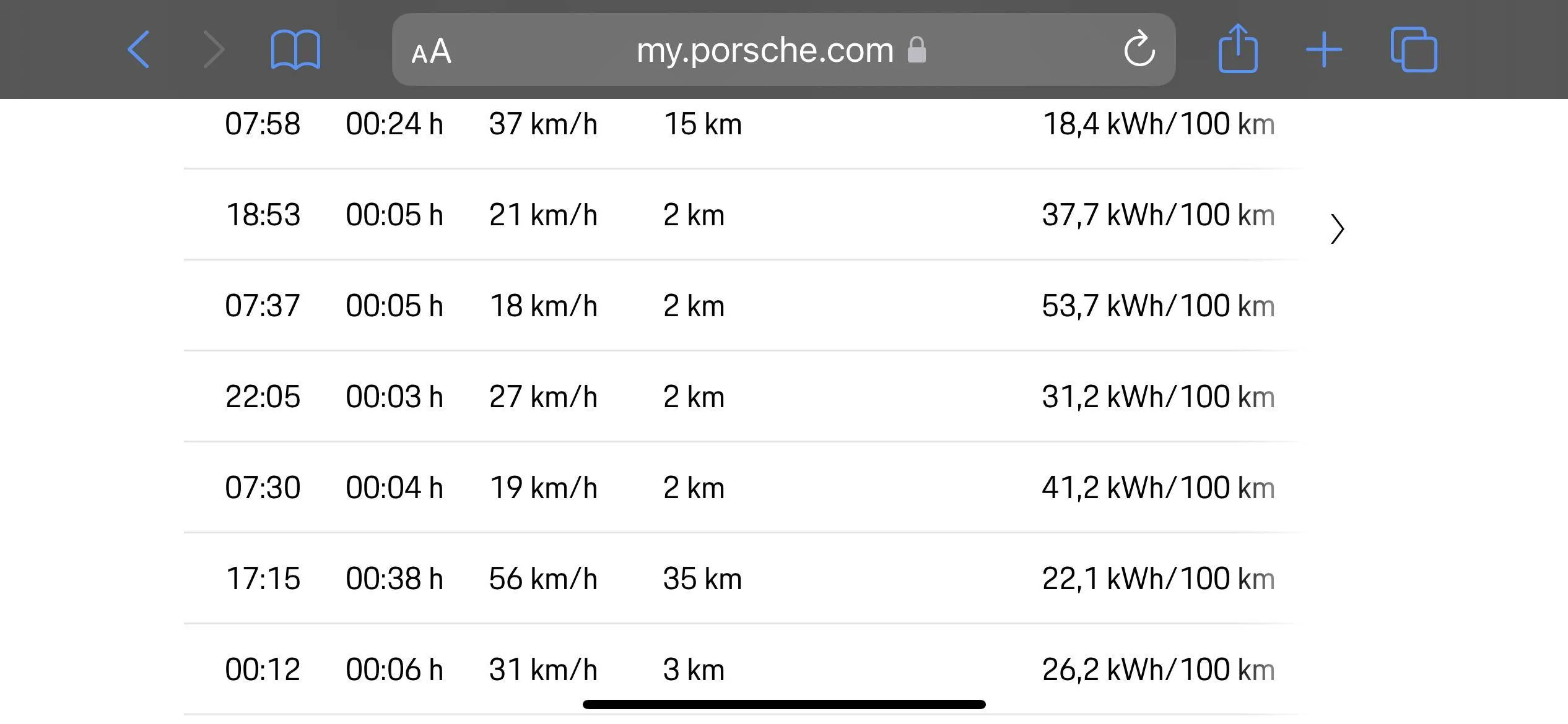

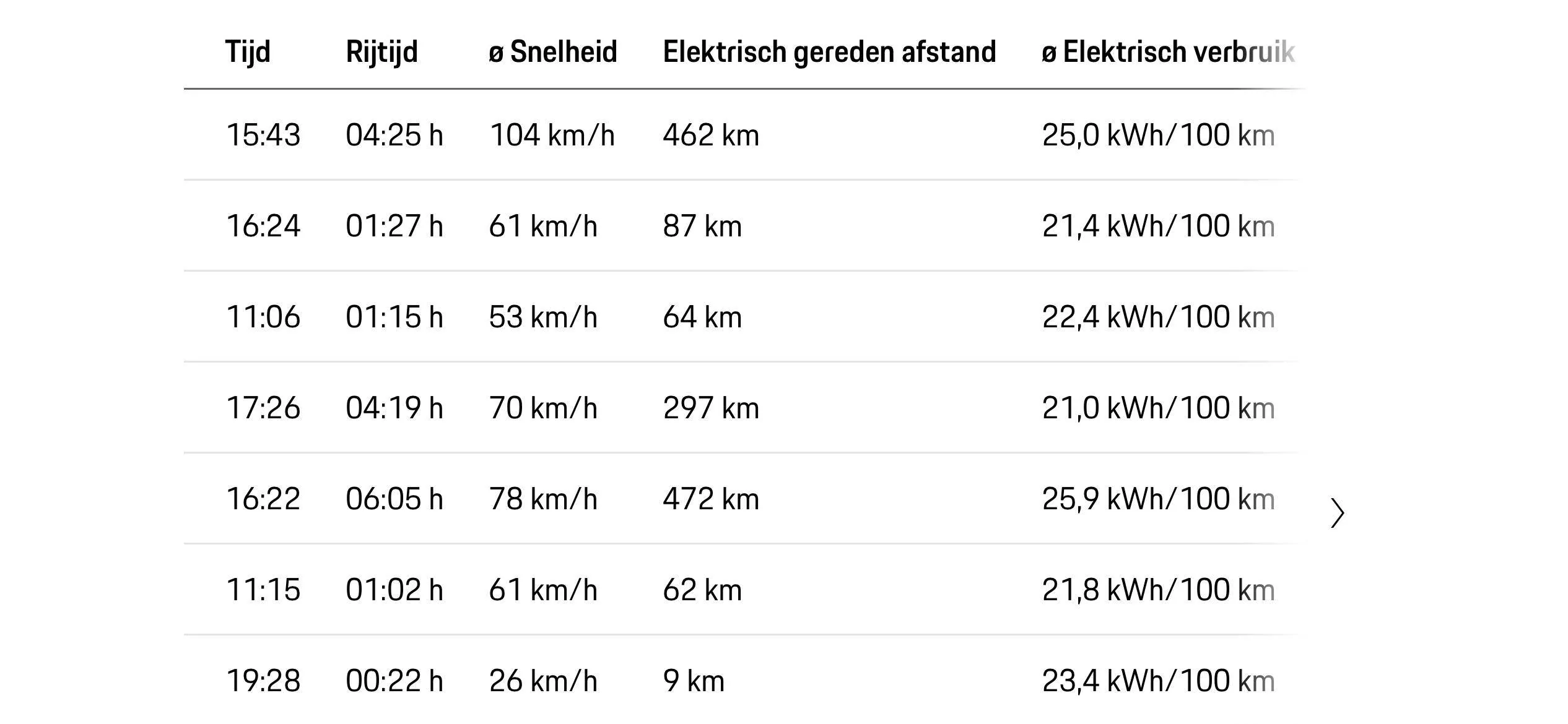

I get my best values on country roads (average speed 60-70 km/h) followed by highway (average around 100). Short drives are really bad. See my 2 km trips. It has to heath or cool the cabin.

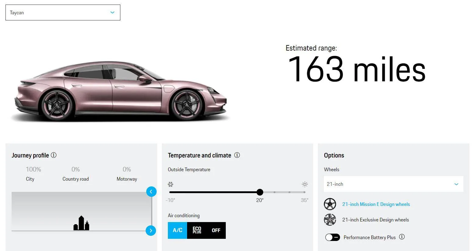

When you use the Porsche Range calculator, that configuration (Base Taycan, w/o performance+ battery, 21-inch wheels, 100% city driving) comes out to ~160miles of range:
Where can one find this range calculator?

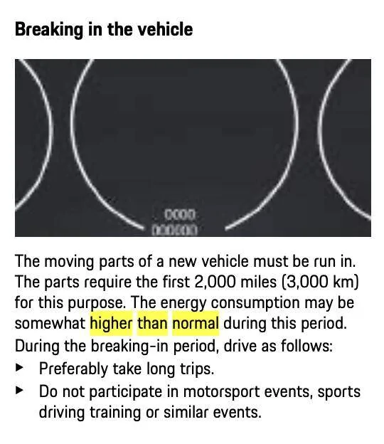

This question about range-when-new seems to come up a lot, but it's in the manual.
Porsche Taycan New car, when does range finally start steady out to EPA? Screen Shot 2022-07-07 at 12.28.26 PM

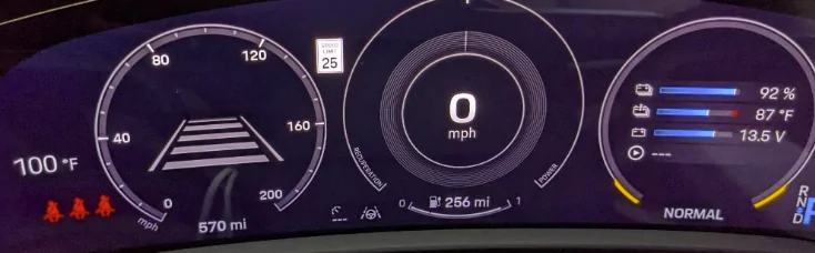

My range jumped noticeably after driving about 500 miles around the Phoenix AZ USA area in a mix of city driving and 20-mile freeway commutes during the heat of the summer.
When I took delivery four weeks ago, the guess-o-meter was 212 miles at 100% SOC.
When I started the 280-mile drive from my home to Las Vegas, I charged the car to 92% SOC and had 256 miles on the guess-o-meter. As you can see from the photo, I had 570 miles on the odometer, my garage was still 100 F (38 C) in the morning, and the battery temperature was 87 F (31 C).
Porsche Taycan New car, when does range finally start steady out to EPA? 1657222333074
Details: 2022 RWD, outside temperatures ranging from 95 to 112 F (35 to 44 C), Performance Battery Plus, 20" Turbo Aero wheels, air suspension, normal drive mode at normal chassis height, A/C set at 60 F (16 C) with fan speed at #2 or #3 out of 6, seat ventilation always on full, fixed pano roof, thermal glass with 35% tint w/90+% heat rejection.
