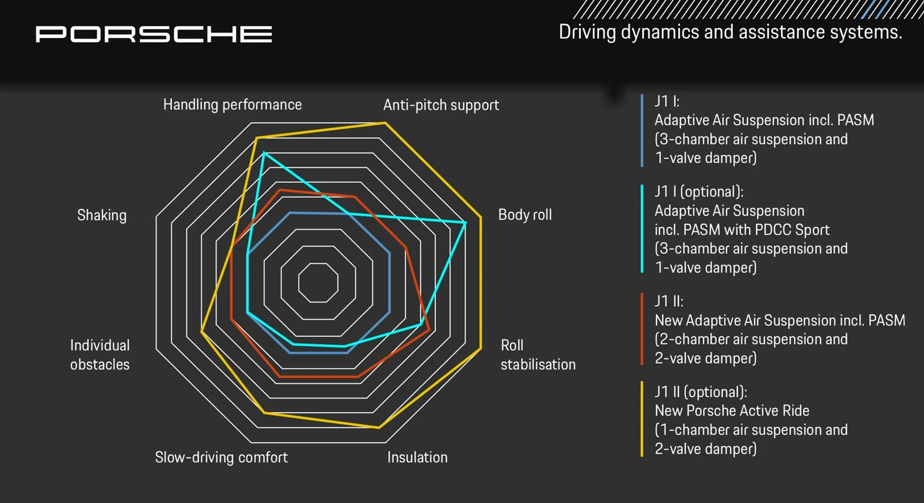

From what I can gather in the previous posts and links, the main changes for 2025 are battery capacity and charging, and styling. I'm wondering if anyone has had the opportunity to test a PDCC car vs air suspension? I would agree that either is a 'must have', but not sure if air suspension represents any improvement over PDCC in terms that the driver can actually feel.
On YouTube Autogefühl said that the new standard air suspension is better than PDCC from before.
But I'm not sure if he really has driven them back to back to have a really good feel for it.
Not sure how much trust you have in that, but so far it's been the only comparison I have come across.
Porsche Taycan New version 4S. Is is really that much improved? 1723226173914-g2
11,100
6,870
PDCC and air suspension are two entirely different things.
