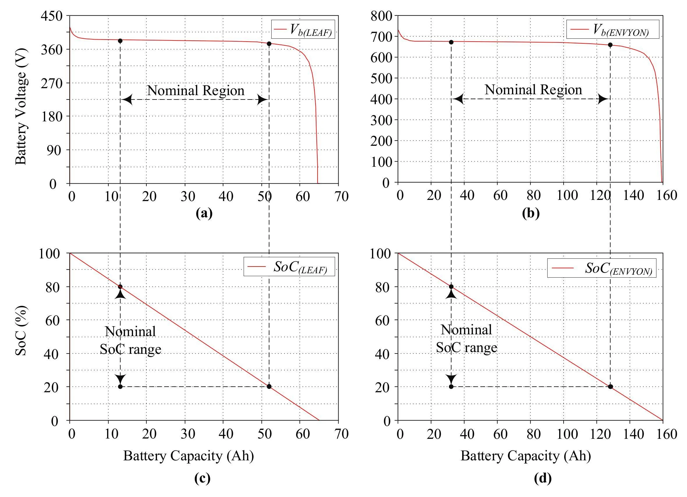

Also, anyone have any insight into how battery charge level and HP correlate? If we typically stop charge at 85% - are we getting 85% of 616 HP?
Short answer is no. But think logically, if at 85% SOC you had 85% HP, wouldn’t that mean at 10% SOC you’d have 10% HP?
One of the major benefits of todays battery technology is, not only is the power loss not linear in relation to SOC, they have a great ability to maintain voltage at a relatively high level deep into the discharge. There will be some loss of HP as voltage is decreased, how much is the question. For the most part I would be willing to guess it would be almost negligible unless you were pushing it to its limits or doing accurate testing. The graph below isn’t for the Taycan, but they are a fair representation of today’ batteries, and it will only get better as technology advances.
