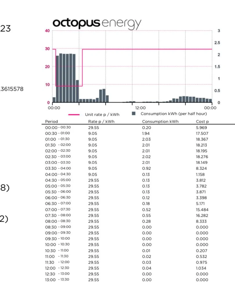

A month after I signed into OI, they provide an itemised bill for each day, you
Should get something that looks like this. It’s so simple with my current car and I am getting more confused by the day on how complicated it seems to be with the taycan. I’m dreading the first evening I get home with the car and forgot everything I have read…🙈🙈

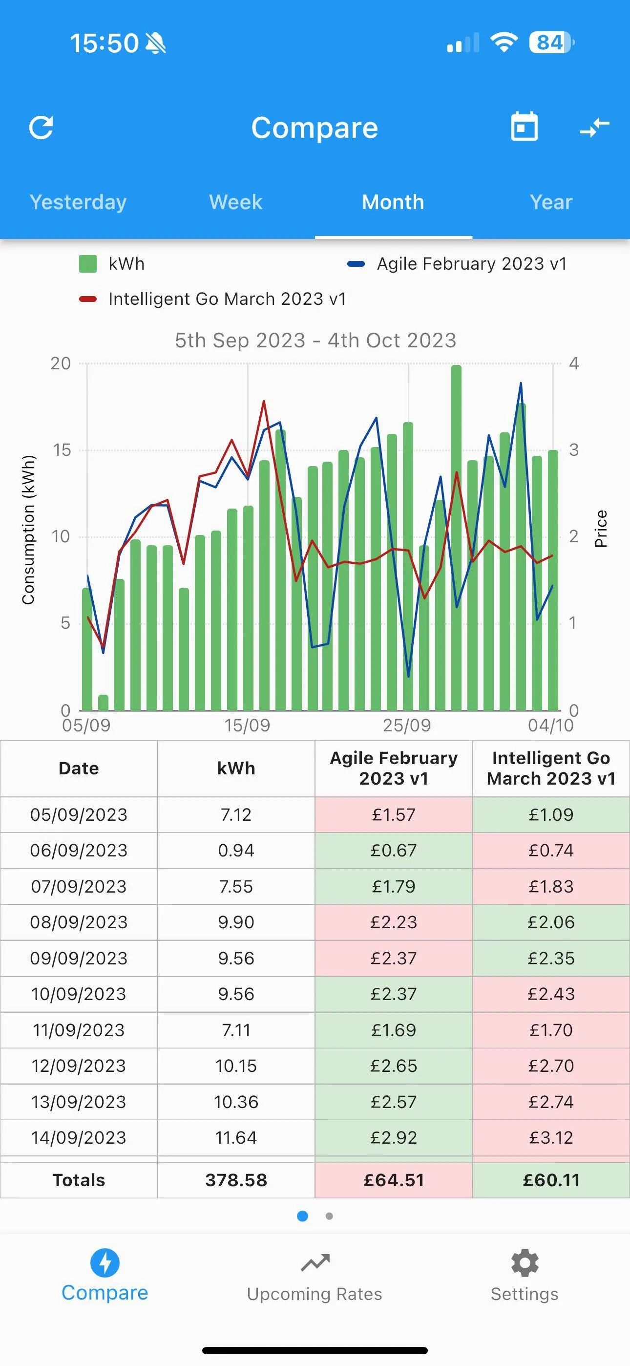

there are some good comparison apps out there now for octopus which uses your actual historical data to compare prices against different products/tariffs.
I'm using 'Octopus Compare' on iOS which is free. You put in your Octopus API details and it gives a personal view... great tool to compare and figure out what works for the indidivudal.
