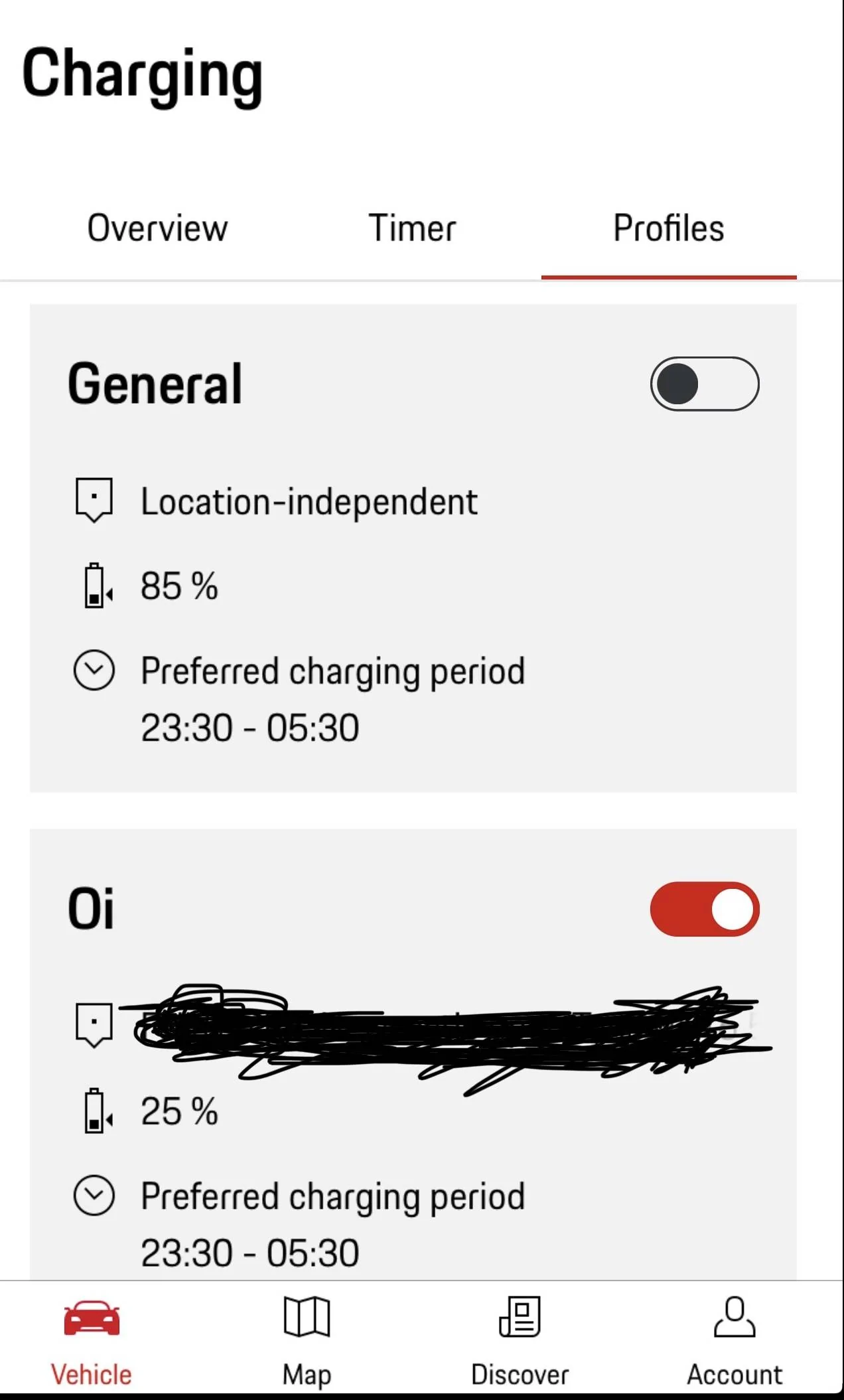

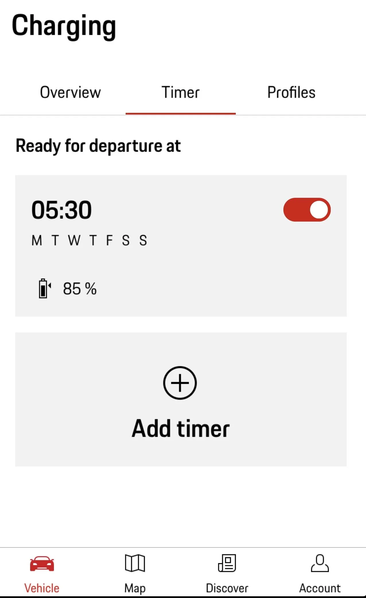

Thanks FF. Here's a couple of pictures of what I've got set up...
Would I need to change it from optomised charge to preferred charging period at all?
Yes, use a preferred charging period which matches the reduced rate period.
Note the minimum charge of 25% means that if the level is lower, charging up to 25% will occur regardless of your preferred charging period setting. The intent is that you have sufficient for emergency purposes.
With Octopus Intelligent, your Octopus app settings override any car settings. You will see an Octopus originated ENODE profile and time. if OI works reliably for you leave that alone. If it doesn’t, set your own profile and timer. My example is below.

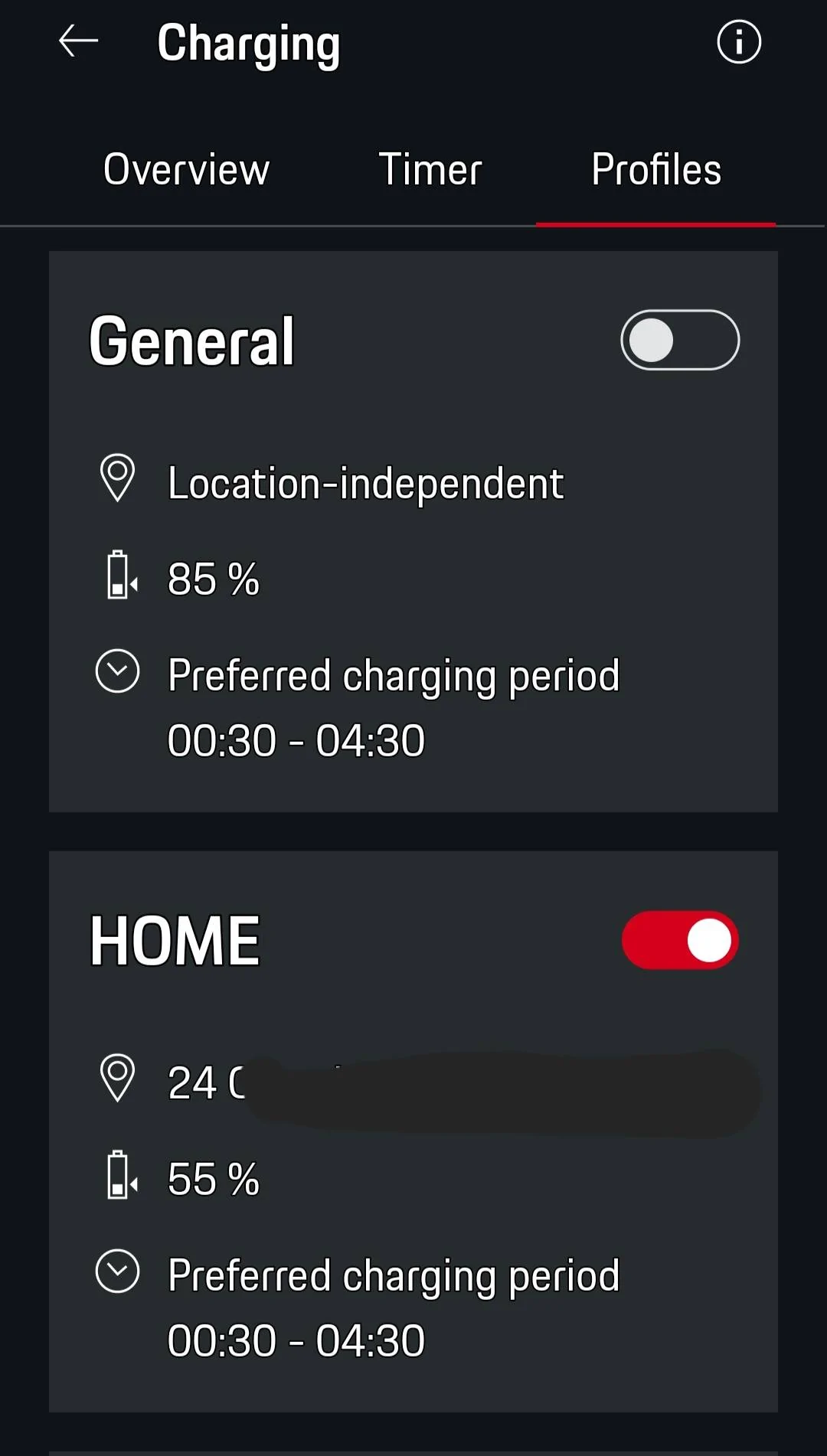

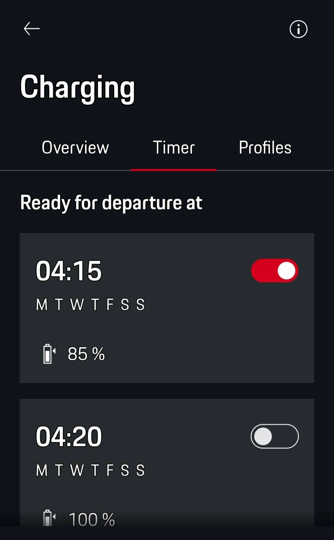

Mine has worked fine on Octopus Go for 2+ years with a location based Profile and Timer set up as follows (I switched from ending at 04.30 to 04.15 as it occasionally overran).
It will start charging up to 55% whenever I plug it in and then pause.
And/or it will then start a cheap rate charge up to 85% (100% timer selected if doing a long journey).
Porsche Taycan Octopus Go Screenshot_20231007_053701_My Porsch
Porsche Taycan Octopus Go Screenshot_20231007_053638_My Porsch
