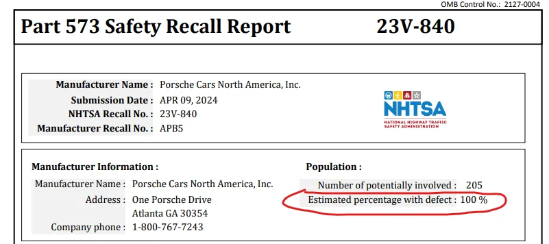

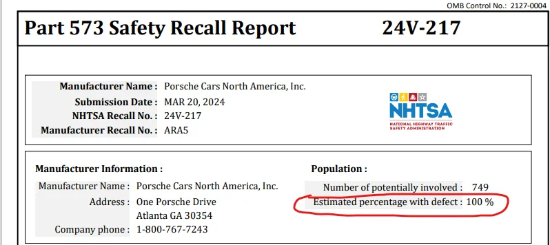

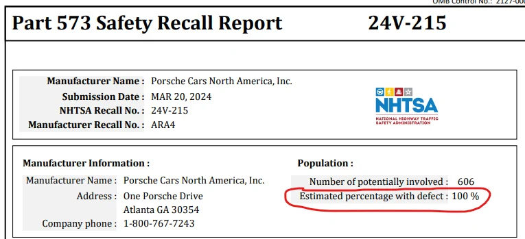

There are at least 3 separate recalls for Taycans entitled "High voltage batteries may short circuit" :
Campaign APB5 Dec 13, 2023 NHTSA 23V840000 205 units
Campaign ARA4 Mar 20, 2024 NHTSA 24V215000 606 units
Campaign ARA5 Mar 20, 2024 NHTSA 24V217000 749 units
Posts with links to NHTSA documents for each of these 3 recall campaigns are in the "recalls" category of this forum.
As of today, there are no TSBs from Porsche posted at NHTSA that provide dealers with detailed instructions/procedures for handling the recalls. Either the TSBs with dealer procedures have not yet been posted at NHTSA, or they have not been issued to dealers.

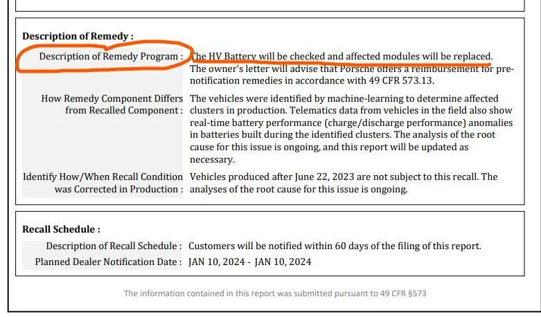

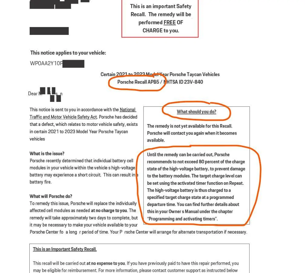

For campaign APB5 (the oldest of the 3 battery may short circuit recalls), owner letter says:
Porsche Taycan Once again...the battery... 1714142552027-ui
And Porsche updated submission to NHTSA dated April 9, 2024 says about "remedy":
Porsche Taycan Once again...the battery... 1714142687399-d6

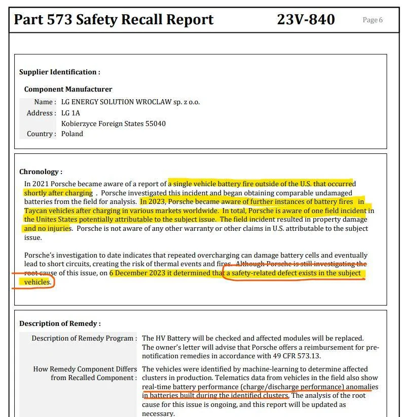

From NHTSA recall posting, looks reactive to me. Porsche report to NHTSA states there are safety related defects in the subject vehicles:
Porsche Taycan Once again...the battery... 1714329600256-q
Also, NHTSA includes its investigation into LG HV battery failures in other brands as an 'associated investigation' with these Taycan recalls: https://static.nhtsa.gov/odi/inv/2022/INOA-EQ22001-7596.PDF
The machine-learning-based algorithm of identifying the subjects of the recall is what prompted my remark.
