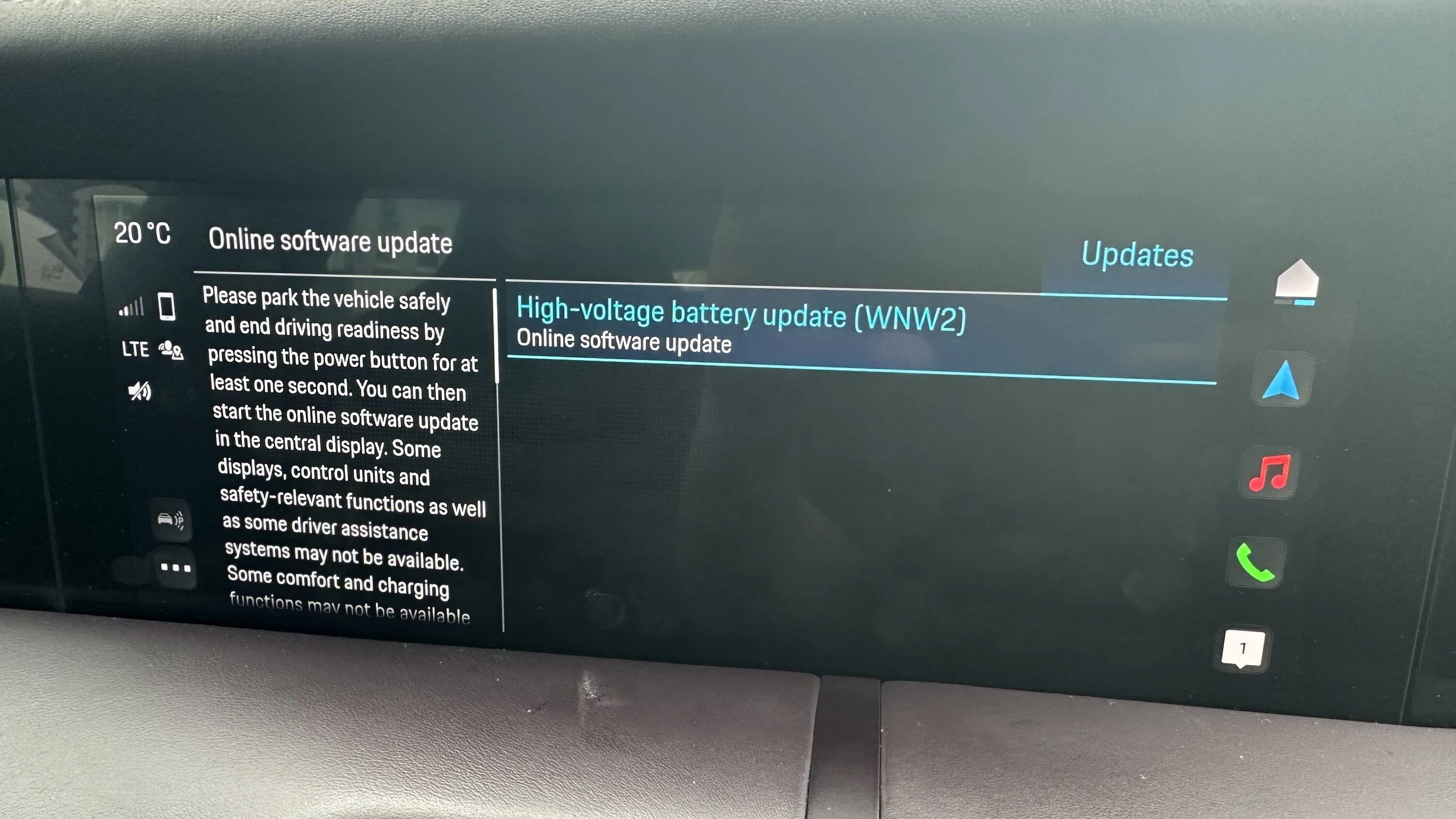

Typical lack of detail but supposedly some 'efficiency' improvements but can't recall if anyone there actually verified that - need to find that thread!
This update? I haven't noticed anything different!
Porsche Taycan OTA Software Update (July 17, 2023)! IMG_9122
Thx - yep that is the one I was recalling from across the pond :)
I think someone either speculated or received info that it was supposedly to offer some sort of efficiency improvements but as I said, I've not seen anyone confirm this as yet.
