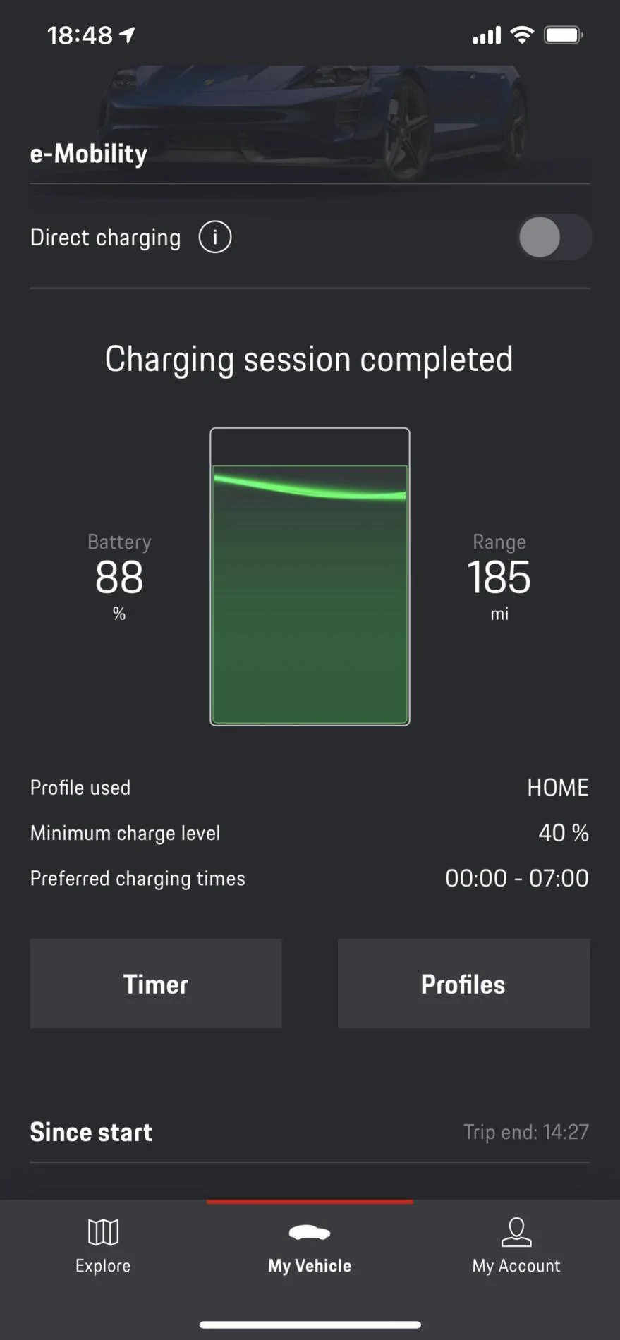

Is this normal? 185 miles when at 88% that’s 210 miles at 100%.
During the first few weeks you have a Turbo and at the current temperatures, probably yes. Also, you have 21" wheels if I remember correctly?

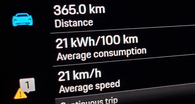

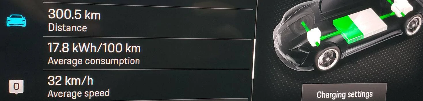

How do you use your Taycan?
Porsche Taycan Outside temperature and range 1610068137253
Porsche Taycan Outside temperature and range 1610068213741
After 1 month of ownership with fun driving and heavy AC usage and average temp 30°C
Porsche Taycan Outside temperature and range 1610068459186
Porsche Taycan Outside temperature and range 1610068586220
After 5 months of ownership with range optimized driving and almost no AC usage and average temp 20°C
Using the full range of the battery without charging in between gives me almost the exact same experience I had with the previous ICE with a 75l tank. However, I don't have to wait at a gas station, instead I just stick it in where I park the car at home over night.
Yes, yes and yes.. lol
So what you are saying is ... don't be too upset, it looks about right.. lol. thanks for the input, appreciated.
