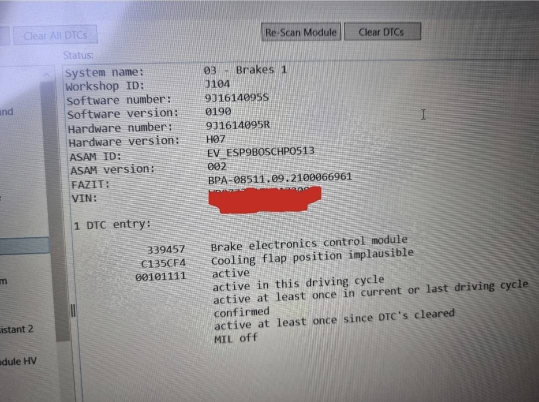

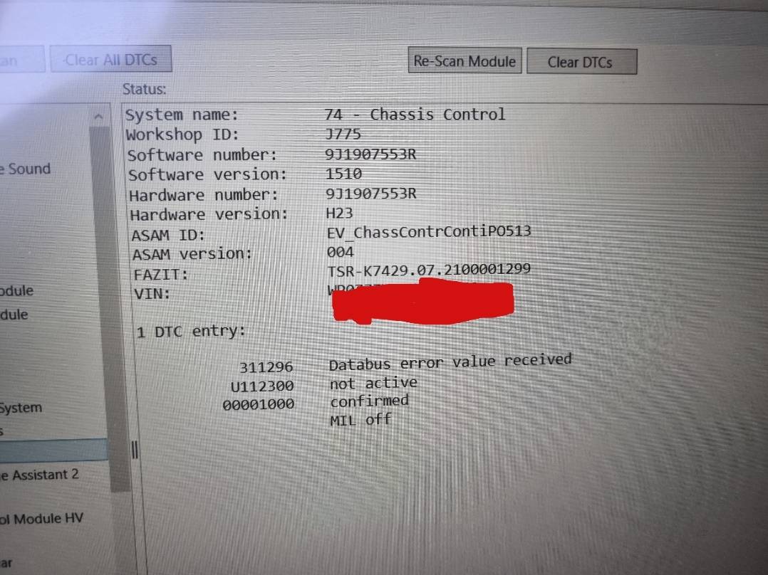

Quite a few uncleared errors here, most could be cleared (done), 2 left that cannot be cleared. Anyone any idea what this is about?
error 1: chassis control, error 2: brakes related

That cooling flap error I have seen on every single Taycan that I have scanned.
Mine included.
I have no idea why it happens.
Btw use copy-paste, if you need to transfer from computer to computer you can save the report to a .txt
Mine included.
Taycan's built for the chinese market come with some aditonal air-intake/flap. Could be related to that.
