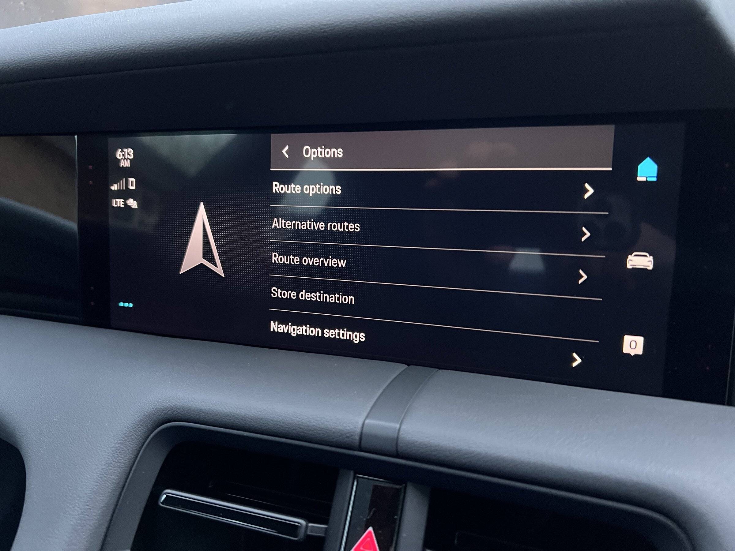

I think I have started something asking about the Charge Planner!
My car is a 4S+ 2020 with new battery, new HV etc, etc having loads of problems and lots of new software.
checking the Navigation display and pressing the three dots on power up results in:-
Porsche Taycan POLL: Is your Taycan missing the Charging Planner 81D27670-6FDF-4C6F-BEAD-4885F0C37892

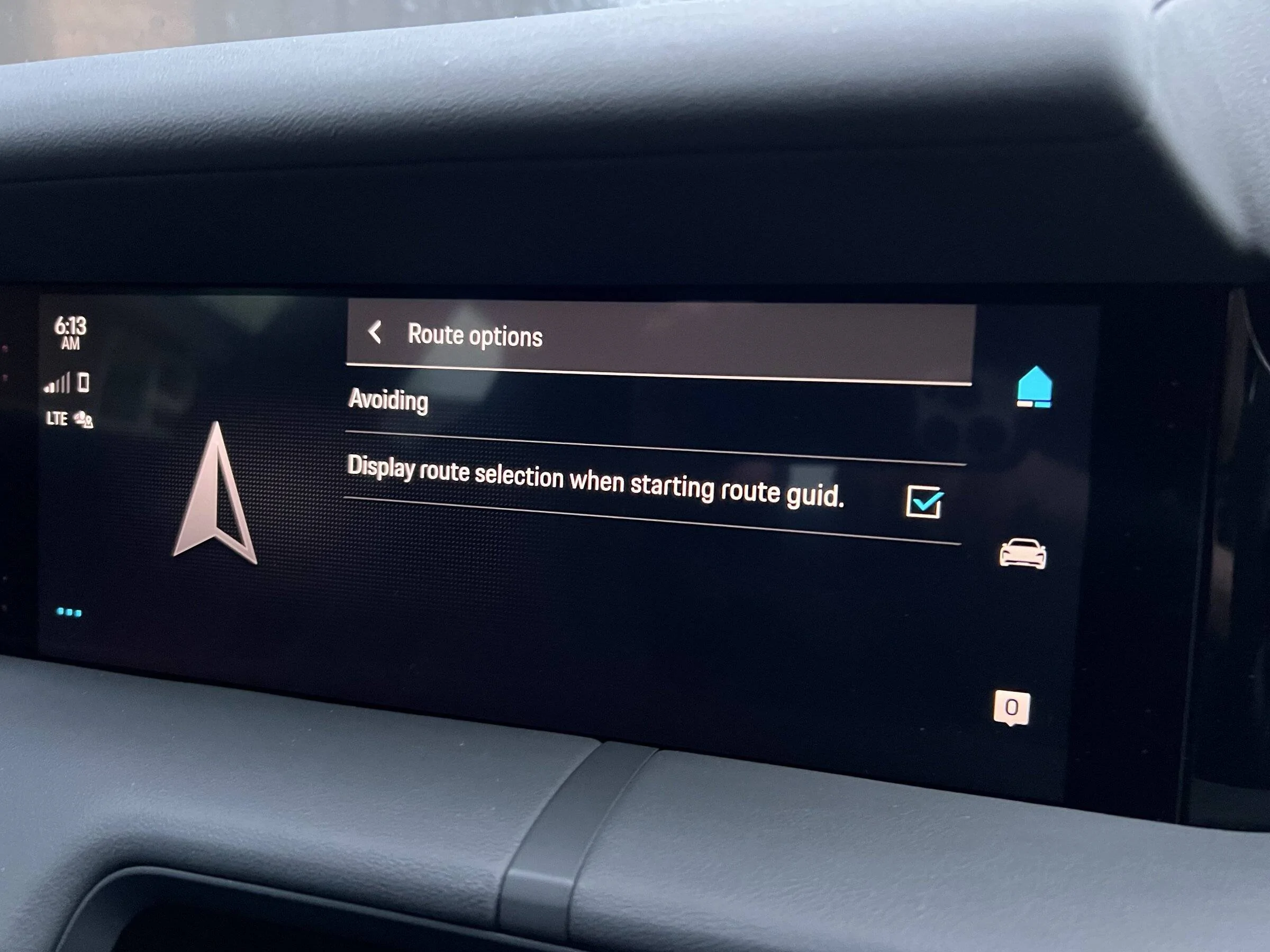

Then entering Route Options:
Porsche Taycan POLL: Is your Taycan missing the Charging Planner E84573DC-F665-4AB2-BC98-0875E1E6400E

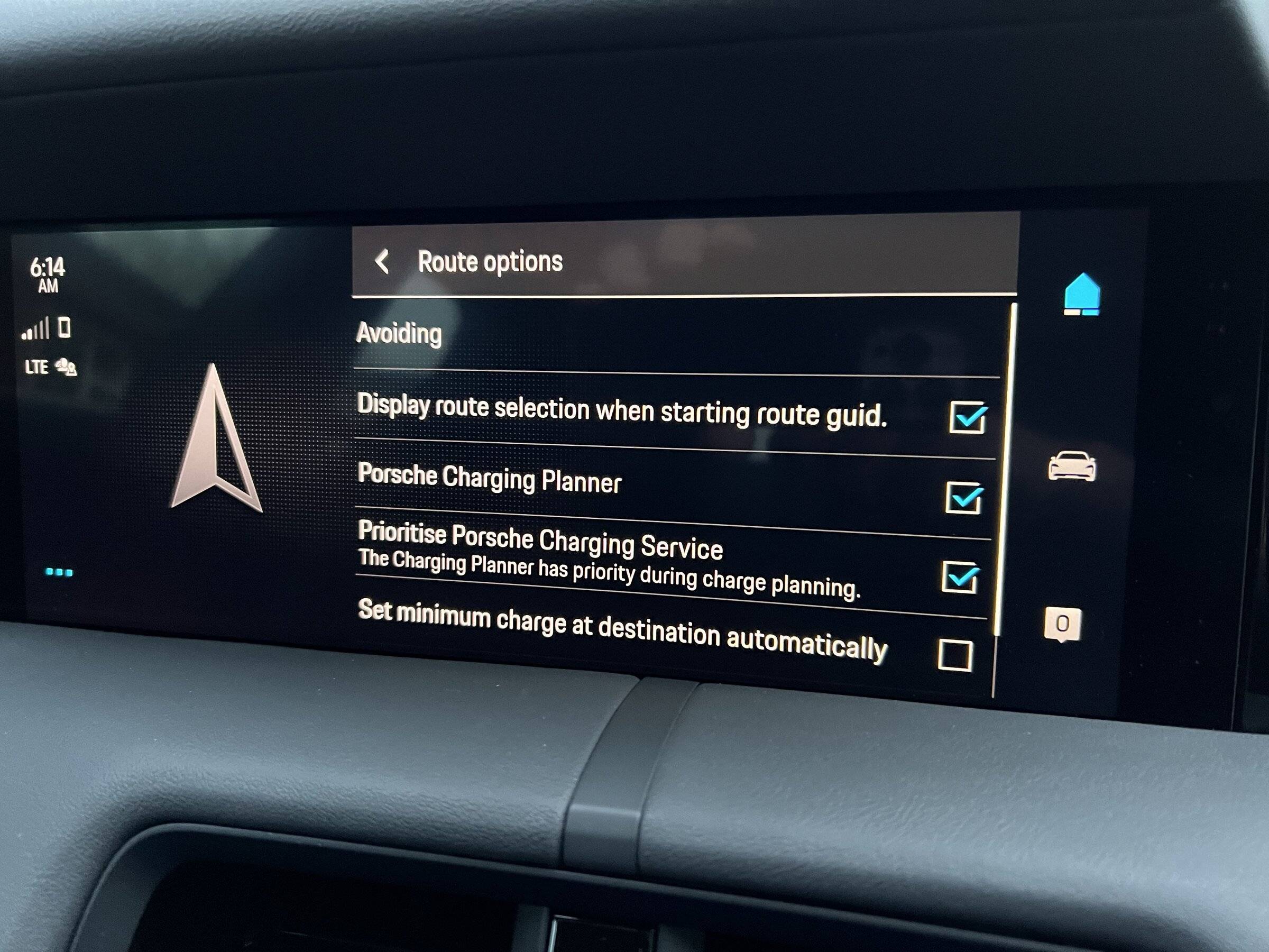

after a minute delay you then get Charging planner appear. You can see by the time display. Also you can see the LTE/ phone link signal.
Porsche Taycan POLL: Is your Taycan missing the Charging Planner 9D1C8FD7-355E-45DD-9965-A5FEB98FC0A4
You also get the option to set minimum charge at destination manually, although I’ve not shown that.
I hope this helps. . . .
