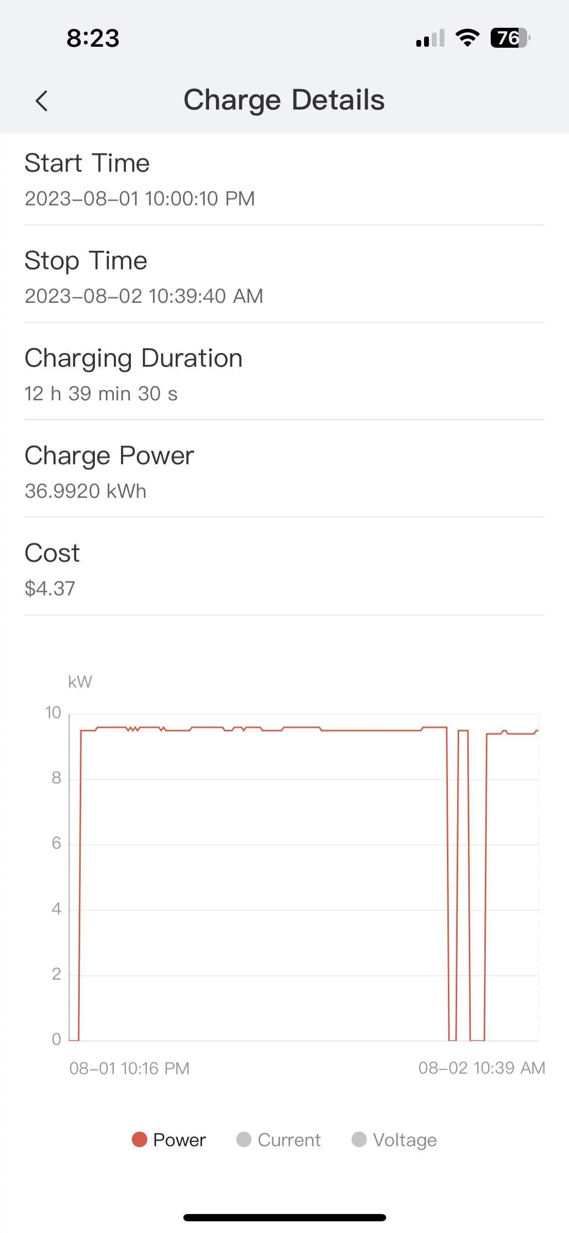

It is indeed 8.7 kW at the car, and it’ll do the same through full. Any deviations are “powering down” or up. Here’s a typical charging graph (as captured at the EVSE):
Porsche Taycan Porsche blessing 40A on Mobile Charger Connect 1692674664635
The stops are pauses as the car is delaying the final few kWh for closer to the target time.

This graph seems to depict getting the 9.6 as I expected...Why am I only seeing 8.7 from my car?
160
5,812
8,650
Porsche shows how much power is "hitting" the battery - the difference is "loss" in the AC/DC conversion and charging overhead.
8.7 is just about right for a "raw" 9.6 kW - this is discussed in many previous threads
https://www.taycanforum.com/forum/t...-charger-48-amps-not-max-9-6-kw-40-amps.1793/
the Porsche EVSE is drawing 9.6 kW from the electricial grid - it is transmitting 9.6 kW via the J-1772 power cord into the vehicle's on board systems - there is a "raw" capacity of 9.6 kW being provided to the vehicle - however as a result of charging overhead and AC power to DC power conversion losses only 8.7 kW is actually adding to the batterie's "capacity" - 9.6 kW - 8.7 kW = 0.9 kW "loss" in the charging process - or about 10% "loss" - this is in line with industry norm's and electrical systems for this sort of thing - nothing is 100% efficient and there is alway some loss on conversions…
Porsche has made a choice in their in vehicle display to not show the "raw" power being delivered to the vehicle, but rather show the actual amount of power contributing to the battery's capacity - 8.7 kW is reasonable given a 10% loss factor common in AC/DC charging systems…
8.7 kW is also exactly the same as every other Taycan owner who is charging at a 9.6 kW "raw" charging rate.
nothing to see here - move on.
