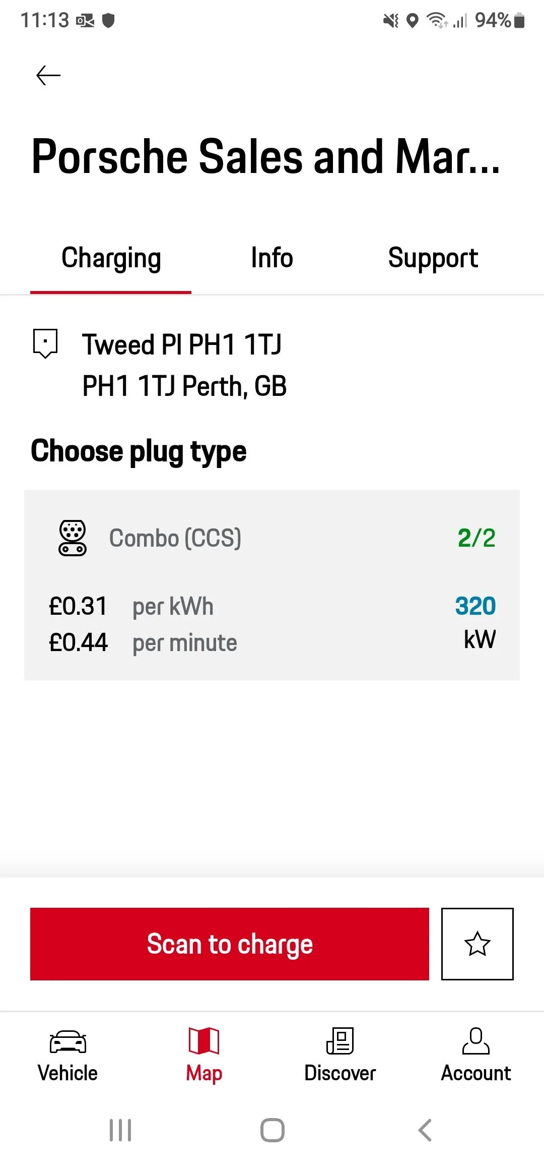

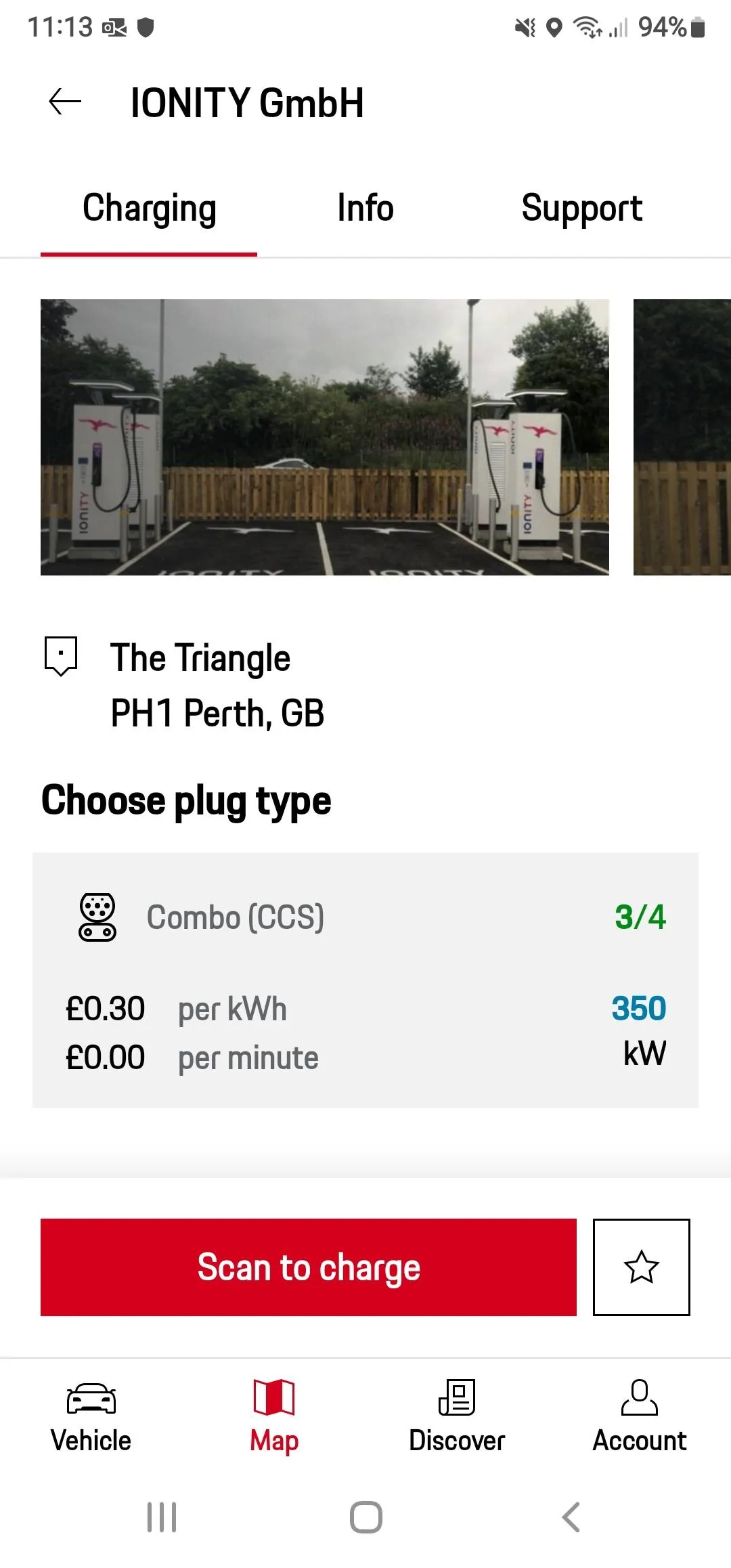

Just to chime in to confirm my experience as being similar to some above....
Porsche Perth charging slow with a 20 degree battery that was 50% capacity.
- crazy to charge there paying a per minute fee with a cold 50% battery...
Ionity Perth - 13% to 60% in 13 minutes.
- Sat nav set for the destination. Drove in sport. Battery was approx 35 degrees. I think it went 40+
- topped out at 240 kw but only for 5 or 6 mins before dropping down to 150 ish.
Splash and dash works very well.
In summary, fast charge DC when your battery is as low as possible and definitely warm it up.
