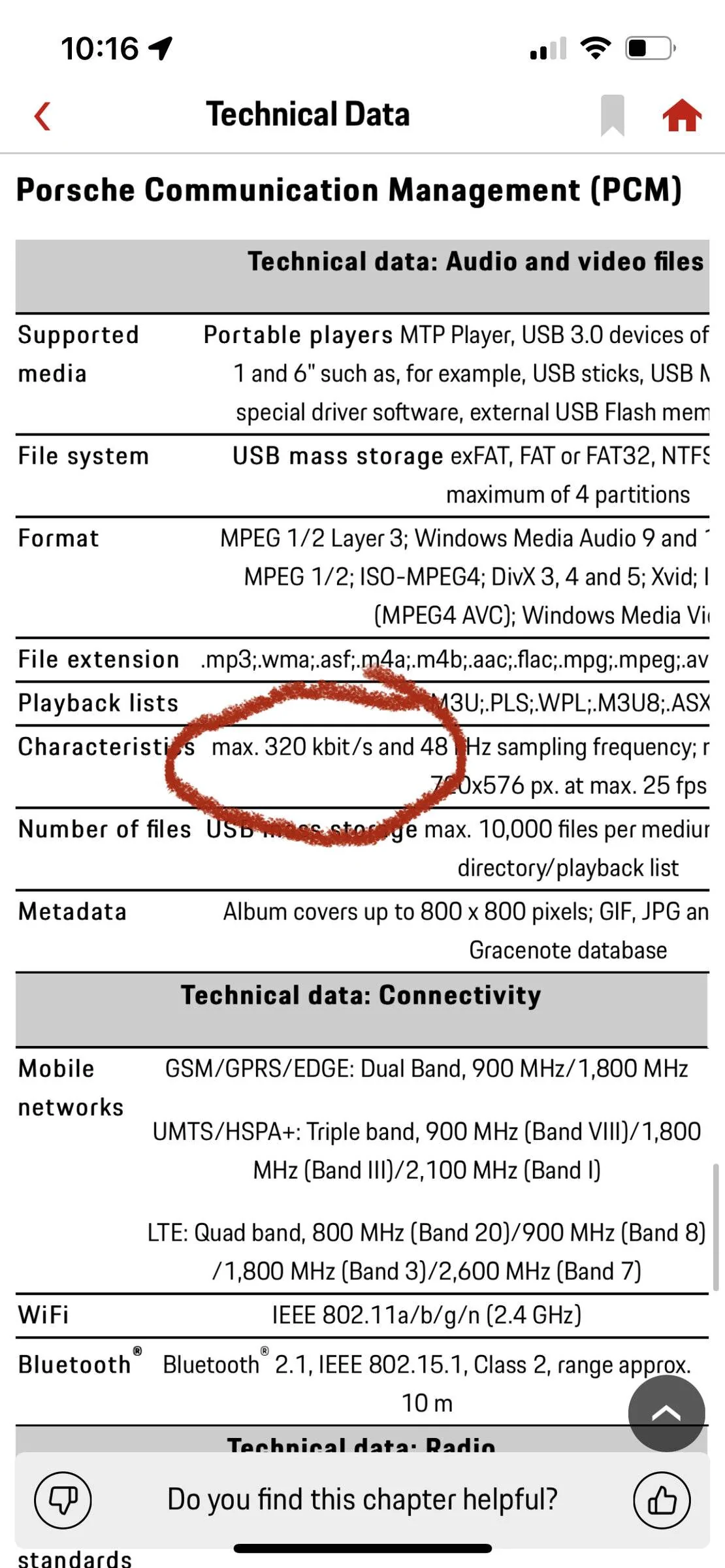

My assumption is that the 320 kbit/s max bit rate eliminates the need to use the USB connection as the wireless protocol will be able to deliver this bit rate as well?
Porsche Taycan Apple Music: via PCM vs. CarPlay - what are the pros and cons? CAA2937E-ABA6-4421-901E-6EBE29B9B56C
Good spot.
That could well be a factor.

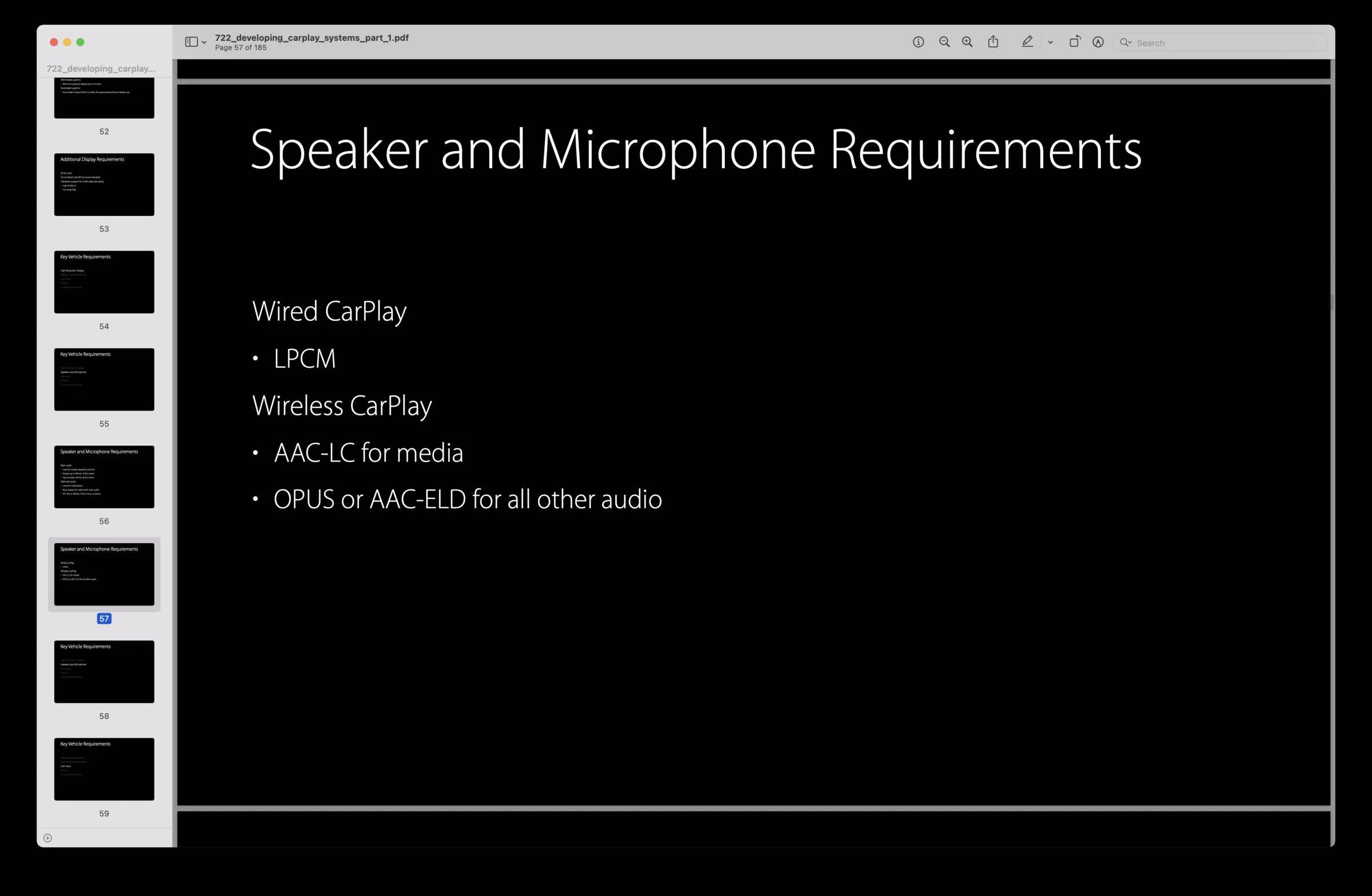

My thoughts on preferring wired/USB CarPlay over wireless CarPlay is that the iPhone uses a different audio codec depending on which connection is in use.
From Apple[1] :
Porsche Taycan Apple Music: via PCM vs. CarPlay - what are the pros and cons? Screenshot 2022-01-16 at 10.10.44

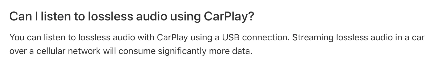

When using wired its using liner pulse code modulation – a lossless codec, whereas when the connection is wireless CarPlay uses low-complexity AAC (LC-ACC) which is a lossy codec.
Therefore it is not possible to play Apple Music Lossless via wireless CarPlay and this appears to be backed up in this Apple FAQ: https://support.apple.com/en-ie/HT212183
Porsche Taycan Apple Music: via PCM vs. CarPlay - what are the pros and cons? Screenshot 2022-01-16 at 10.19.11
[1] https://devstreaming-cdn.apple.com/...722/722_developing_carplay_systems_part_1.pdf
From Apple[1] :
Great post - I did not know that. Thanks!

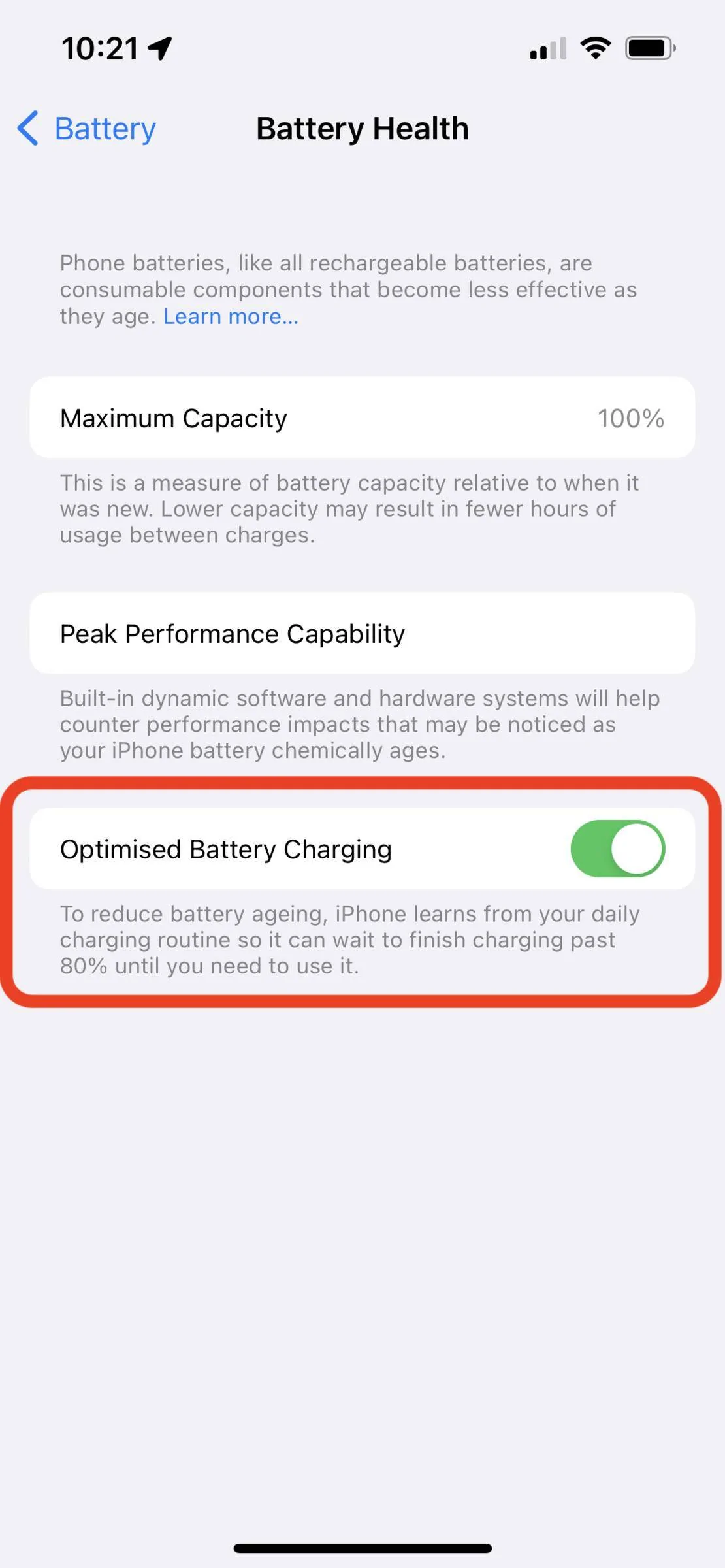

I did think that but I see it will happily charge to 100% every time. I’m sure those engineers at Apple HQ know what they are doing, so like you say, I won’t worry about it!
Make sure battery management is active on your device.
Go to Settings -> Battery -> Battery Health.
Ensure "Optimised Battery Charging" is active.
Porsche Taycan Apple Music: via PCM vs. CarPlay - what are the pros and cons? IMG_7362.PNG
Thank you!
