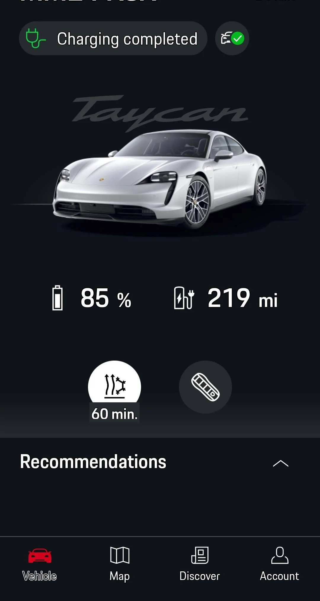

OP. When you switch the Preheat / cool on it starts a countdown for 60 mins (I have just done it now to show you) as long as you have enough soc (posts above).
After the hour it switches off, or you can end the session on the app, or it stops when you get in the car.
Typically uses 1 to 2% of battery in the full hour (depending on conditions) but generally you can get the job done in far less time.

Porsche Taycan Pre-heating function will drain battery? Screenshot_20221204_062702_My Porsche
